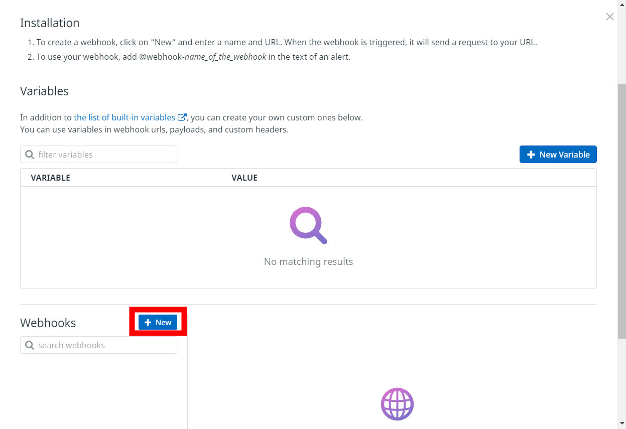

  1. Log into your Datadog account and navigate to the Integrations page.
  2. Search for and install the Webhooks Integration.
  3. In the Webhooks Integration menu, select the Configuration tab.
  4. Click New.

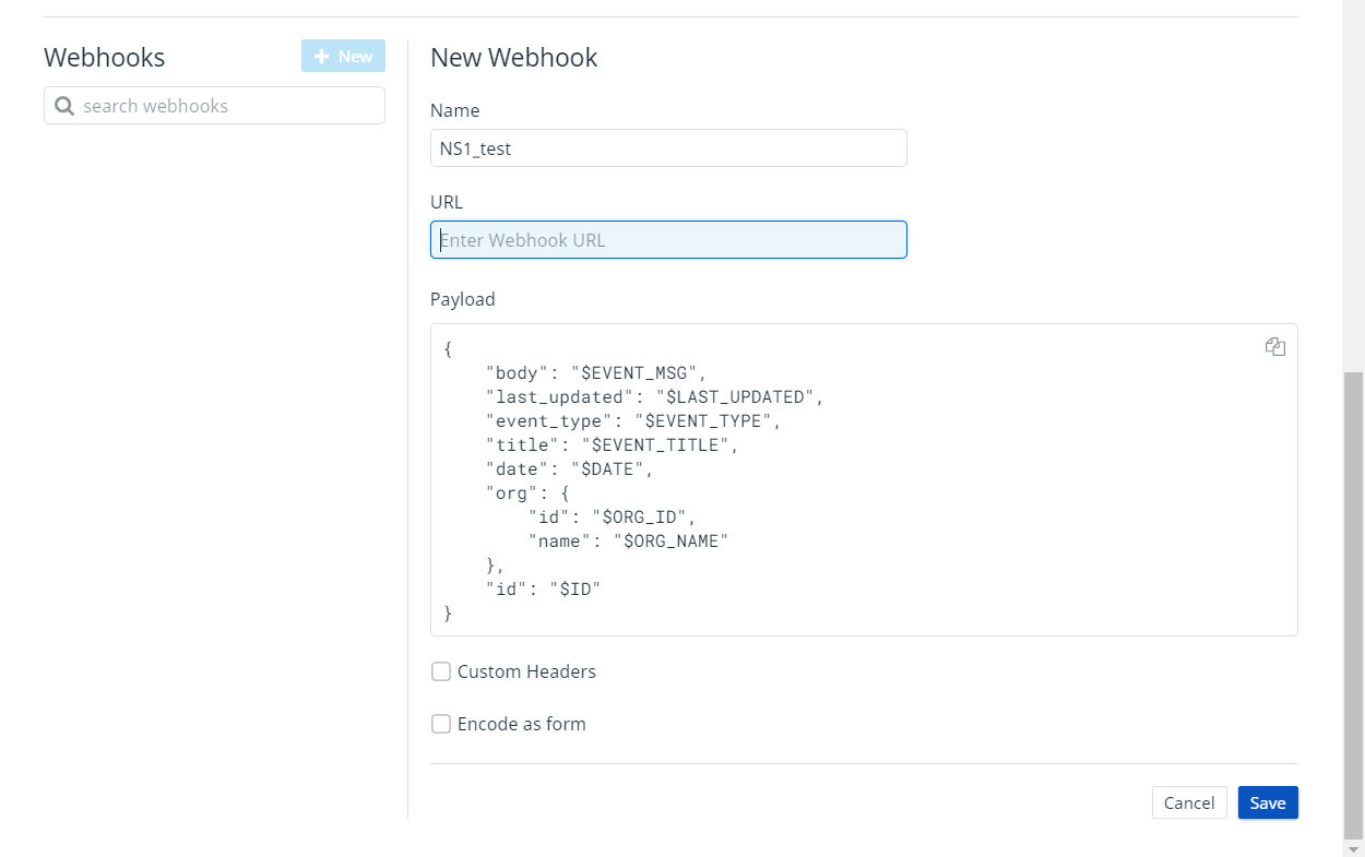

  5. Enter a name for the webhook for internal reference.
  6. Under URL, enter https://api.nsone.net/v1/feed/<sourceID>, replacing <sourceID> with the unique ID for the data source you generated in the previous step.
  7. Click Save.
