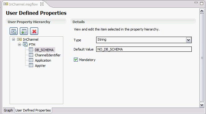

Properties promoted to the BAR file are typically one or more node properties that have been promoted up through the flows and subflows or a user defined property (UDP). A user-defined property (UDP) is a property that is defined when a message flow is constructed using the message flow editor and is supported by a specific variable declaration in the ESQL or Java™ code.
The typical properties for application name, application version and database schema shown above are UDPs. An example of UDP definition in the message flow editor is shown in the following figure.
Figure 2. User-Defined Property to define the database schema
In FTM, these UDP values must be used to initialize other code and variables prior to an application interacting with the database or cache APIs so it is important for top level application flows to call the correct initialization functions.
