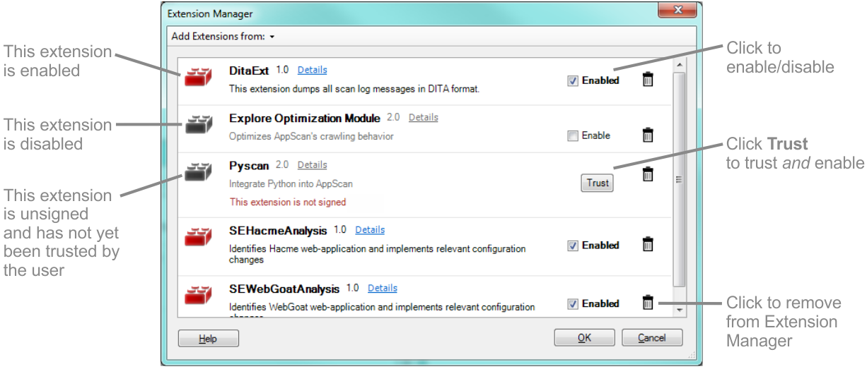

If an extension is added but not trusted and enabled, the icon on the left is grayed out.
Screenshot showing enabled, disabled and untrusted extensions in Extension Manager.

Enabled check box
Select/deselect the check box to enable/disable the extension. Note that this change only takes effect the next time you open AppScan.
When a new extension is added it is automatically enabled (and this check box selected), unless there is a reason AppScan was unable to do this (such as an incompatible version), or the extensions is not signed.
Trust button
If an unsigned extension is installed, AppScan does not load it, but displays a Trust button next to it. When you open AppScan a pop-up warns you that there are unsigned extensions that are not enabled.
If you are sure the extension can be trusted (for example, if you wrote it yourself), click the Trust button to trust it from now on, and enable it.
Tip: If you have an unsigned IBM extension that you used with a previous version of AppScan, you can either elect to trust it, or click Get More Extensions to see if a signed version is available to replace it (see Replacing unsigned extensions).
The Remove Extension icon
Click to remove an extension.
