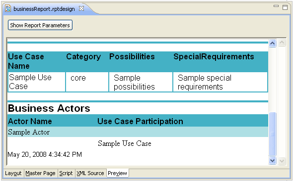

    18. Preview the report. The actor and the use case it participates in from the Sample Business Model.emx instance model are displayed. If you are working in English, the preview should now look similar to the following figure:
