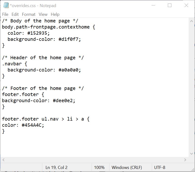

On your computer, navigate to the files that you extracted. Find the overrides.css file in here banka_theme/banka_theme/css/overrides.css. You can now customize the overrides.css file.
- Open the overrides.css file in your chosen editor.
- Customize your
sub-themeby entering the following elements into the overrides.css file:/* Body of the home page */ body.path-frontpage.contexthome { color: #152935; background-color: #d1f0f7; } /* Header of the home page */ .navbar { background-color: #a0a0a0; } /* Footer of the home page */ footer.footer { background-color: #dee0e2; } footer.footer ul.nav > li > a { color: #454A4C; }
- Save the overrides.css file.
You can now install and enable your customized theme.

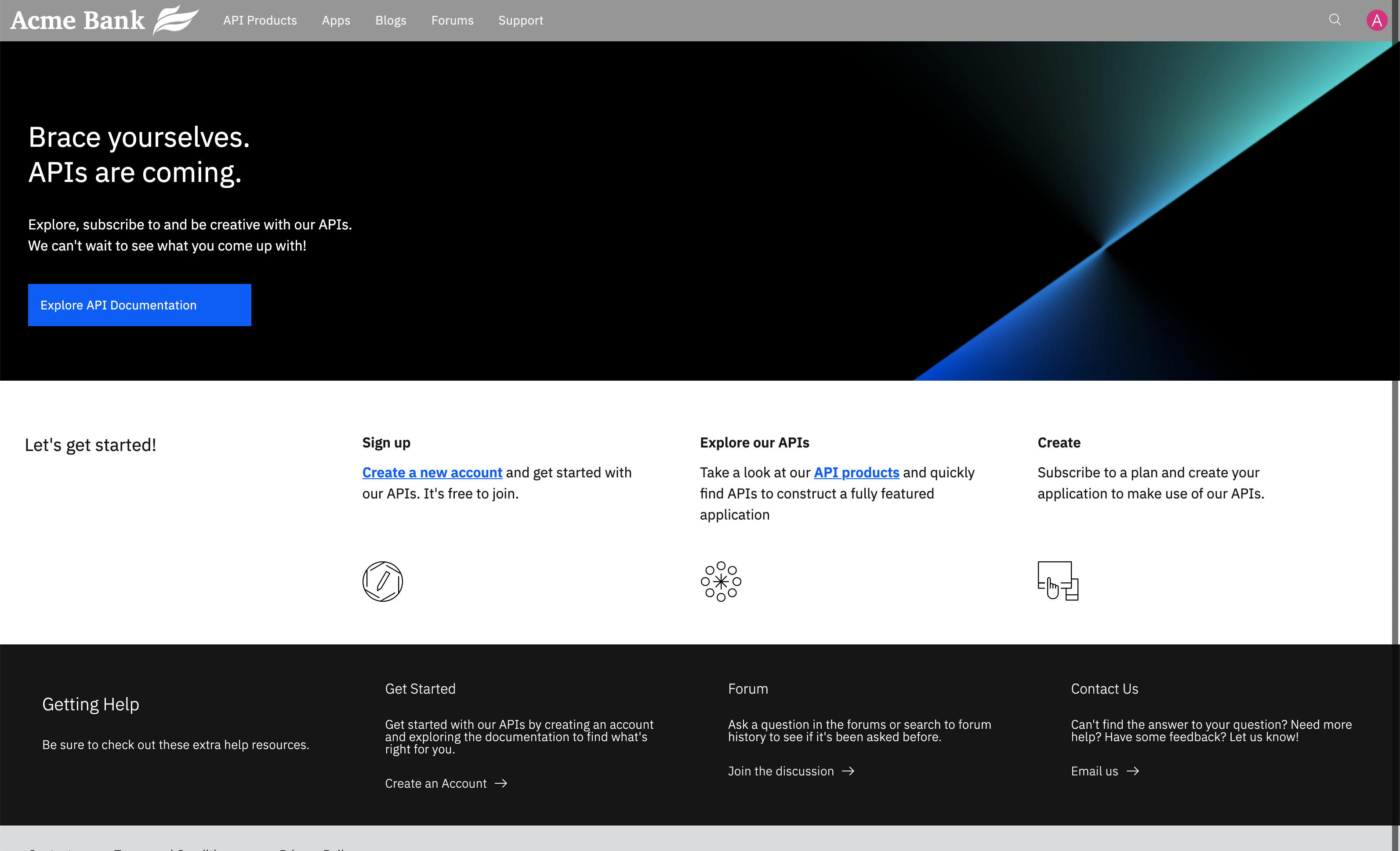

- Click Enable newly added themes, and find your new theme in the list of
Disabled themes. Click Enable and set as default to set your new customsub-themeas the default theme for your site. - Return to the Developer Portal home
page by clicking Back to site. You can now see your custom theme.

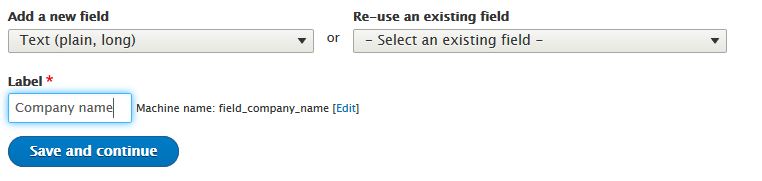

- Click + Add field.
- In
Add a new field, select Text (plain, long). Enter Company name as the label title.
- Click Save and continue.
- Leave the
Allowed number of valuesset to 1 and click Save field settings. - Click Save field settings. You can now see your new field.
