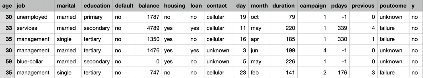

Sample data
The sample data that is used in the guided experience is UCI: Bank marketing data used to predict whether a customer enrolls in a marketing promotion.
Spreadsheet of the Bank marketing data set

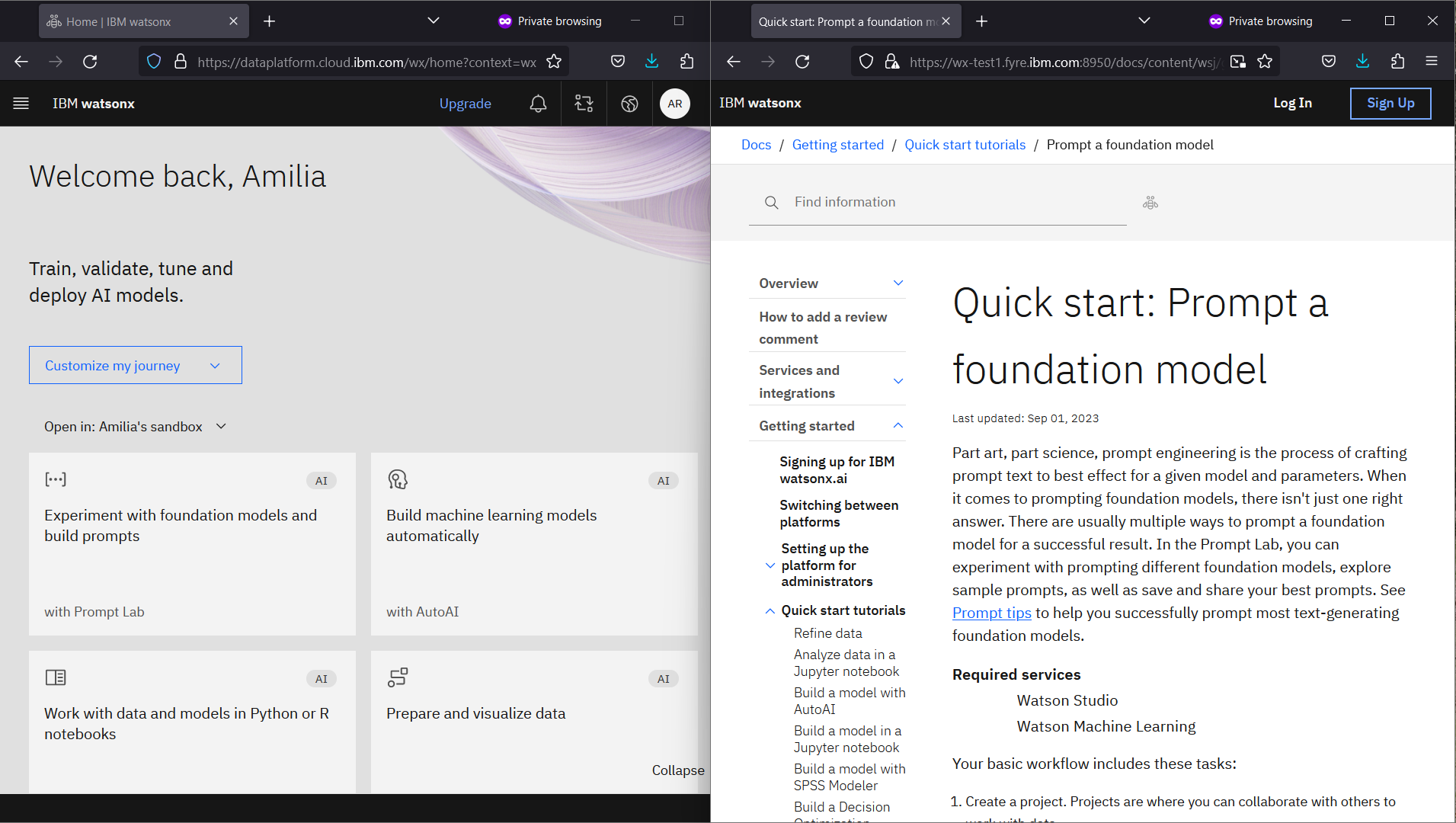

Set up your browser windows
For the optimal experience completing this tutorial, open your account in one browser window, and keep this tutorial page open in another browser window to switch easily between the two windows. Consider arranging the two browser windows side-by-side to make it easier to follow along.
Side-by-side tutorial and UI
Tip: If you encounter a guided tour while completing this tutorial in the user interface, click Maybe later.

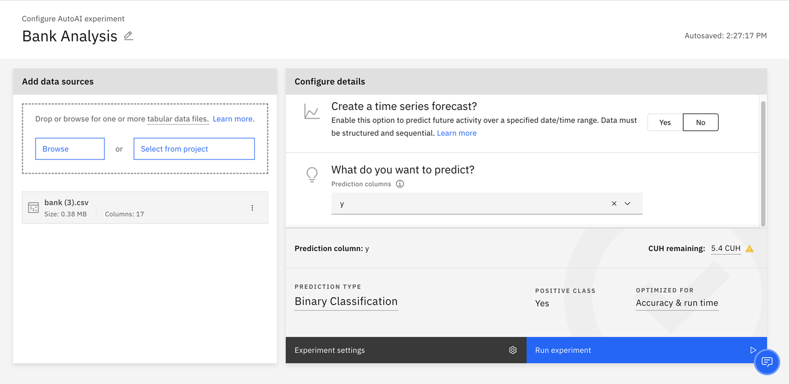

  2. From the Assets tab of your project, click New asset > Build machine learning models automatically.
  3. On the Create an AutoAI Experiment screen, add a name and optional description for the project.
  4. Click Create.
  5. On the Add data source page that opens, click Browse and open the bank.csv.
  6. Select No if you are asked to create a time series experiment.
  7. Select the column labeled Y for the model. This column will be used to predict whether a customer is likely to enroll in a marketing promotion. AutoAI analyzes your data and determines that the Y column contains True/False information, making this data suitable for a binary classification model. The default metric for a binary classification is accuracy and run time.
    Choose a prediction column
  8. Review the preset experiment settings. Based on the data set and the selected column to predict, AutoAI analyzes a subset of the data and chooses a prediction type and metric to optimize. In this case, the prediction type is Binary Classification, the positive class is Yes, and the optimized metric is ROC AUC & run time.

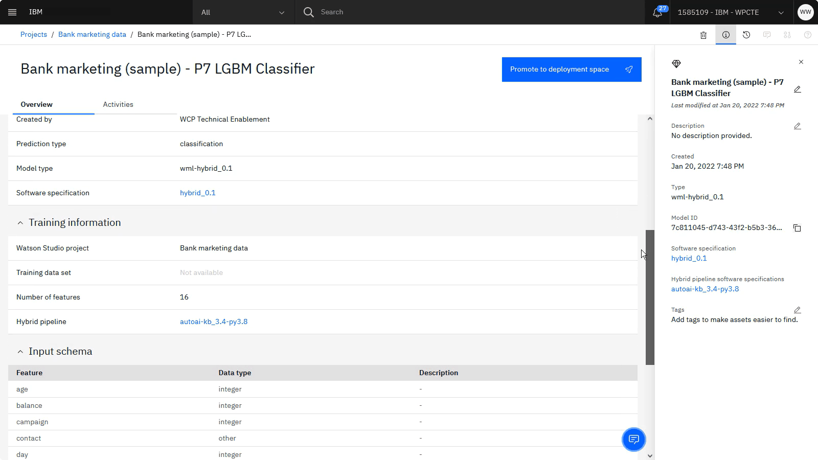

  12. Click Save as, select Model, and click Create. This saves the pipeline as a model in your project.
  13. When the model is saved, click the View in project link in the notification to view the model in your project. Alternatively, you can navigate to the Assets tab in the project, and click the model name in the Models section.
Checkpoint icon Check your progress
The following image shows the model.

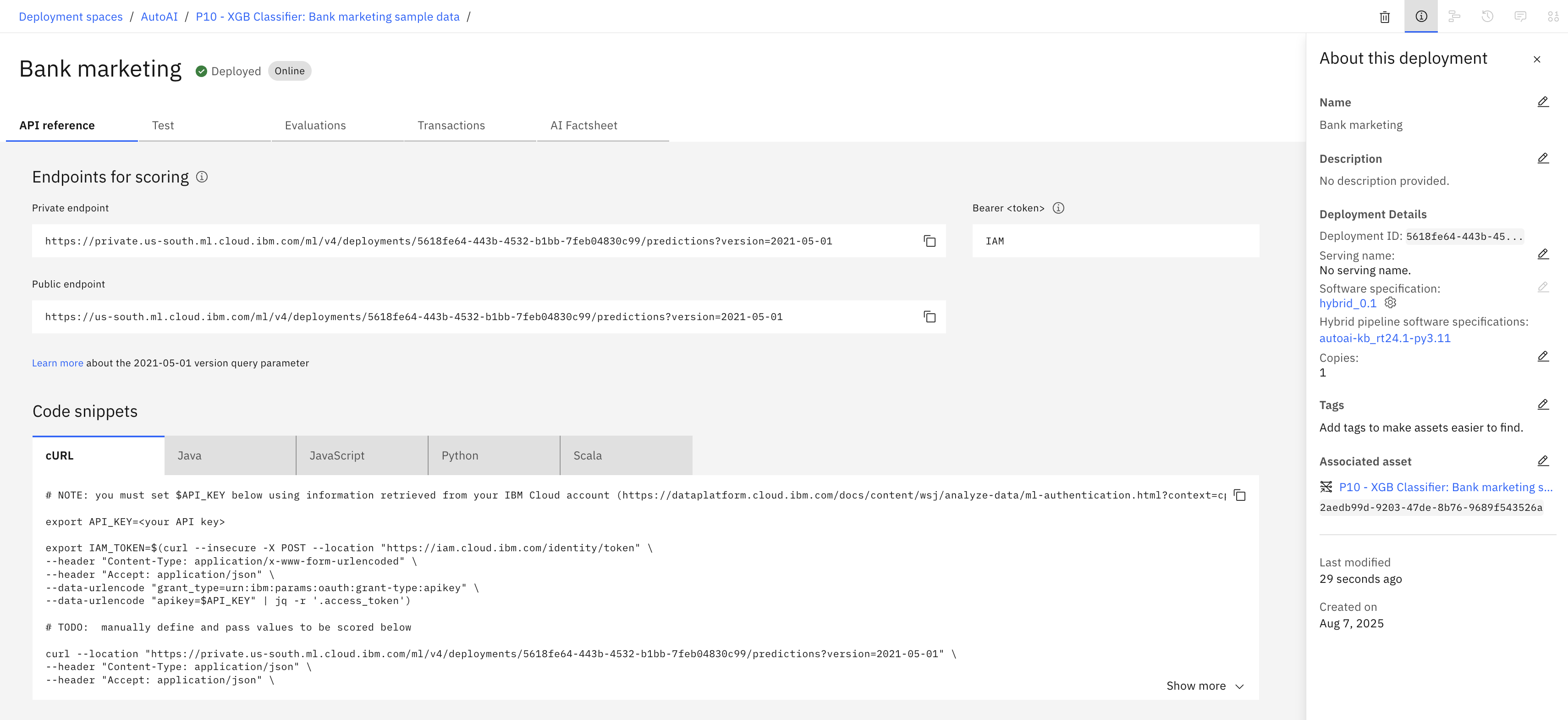

  6. With the model open, click New deployment.
    1. Select Online as the Deployment type.
    2. Specify a name for the deployment.
    3. Click Create.
  7. When the deployment is complete, click the deployment name to view the deployment details page.
The following image shows the new deployment.

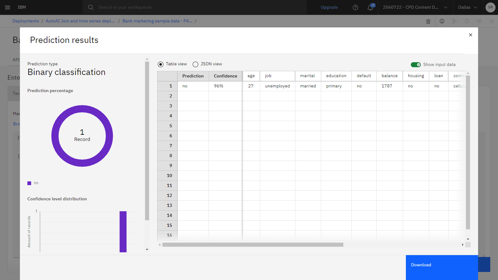

Task 4: Test the deployed model
Now that you have the model deployed, you can test that that online deployment using the user interface or through the Watson Machine Learning APIs. Follow these steps to use the user interface to test the model with new data:
  1. Click the Test tab. You can test the deployed model from the deployment details page in two ways: test with a form or test with JSON code.
  2. Click the JSON input tab, copy the following test data, and paste it to replace the existing JSON text:
       "input_data": [
             "fields": [
                   "age",
                   "job",
                   "marital",
                   "education",
                   "default",
                   "balance",
                   "housing",
                   "loan",
                   "contact",
                   "day",
                   "month",
                   "duration",
                   "campaign",
                   "pdays",
                   "previous",
                   "poutcome"
             "values": [
                   27,
                   "unemployed",
                   "married",
                   "primary",
                   "no",
                   1787,
                   "no",
                   "no",
                   "cellular",
                   19,
                   "oct",
                   79,
                   1,
                   -1,
                   0,
                   "unknown"
  3. Click Predict to predict whether a customer with the specified attributes is likely to sign up for a particular kind of account. The resulting prediction indicates that this customer has a high probability of not enrolling in the marketing promotion.
  4. Click the X to close the Prediction results window.
The following image shows the results of testing the deployment. The values for your prediction might differ from the values in the following image.

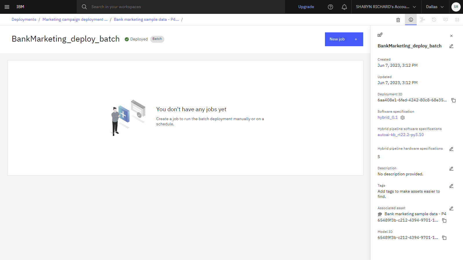

Task 5b: Create the batch deployment
To process a batch of inputs and have the output written to a file instead of displayed in real time, create a batch deployment job.
  1. Go to the Assets tab in the deployment space.
  2. Click the Overflow menu Overflow menu for your model, and choose Deploy.
  3. For the Deployment type, select Batch.
  4. Type a name for the deployment.
  5. Choose the smallest hardware specification.
  6. Click Create.
The following image shows batch deployment.
Batch deployment

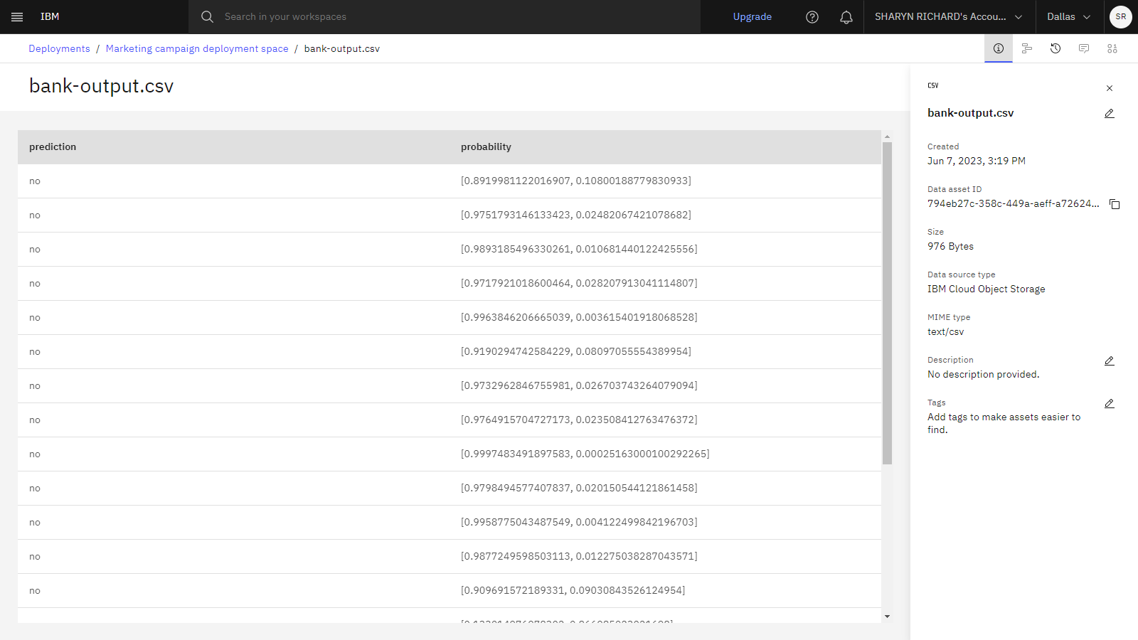

Task 5d: View the output
Follow these steps to review the output file from the batch job.
  1. Click the job name to see the status.
  2. When the status changes to Completed, click your deployment space name in the navigation trail.
  3. Click the Assets tab.
  4. Click the bank-output.csv file to review the prediction results for the customer information that is submitted for batch processing. For each case, the prediction returned these customers are unlikely to subscribe to the bank promotion.
The following image shows the results of the batch deployment job.
