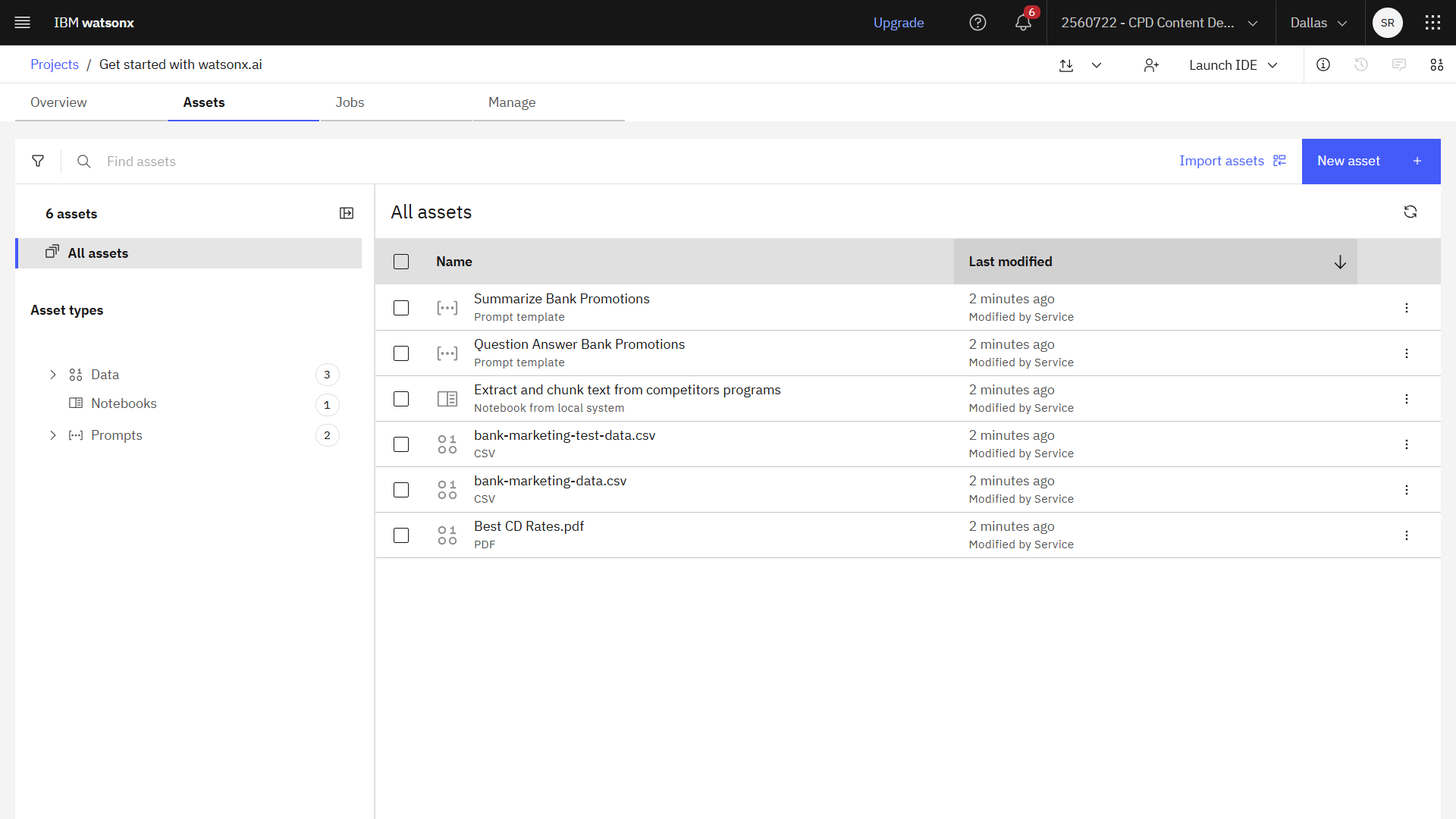

Task 1: Create the sample project
This tutorial uses a sample project that contains the data set, notebook, and prompt templates to perform the analysis. Follow these steps to create a project based on a sample:
  1. Download the getting-started-watsonxai.zip file.
  2. From the Navigation Menu Navigation Menu, choose Projects > All projects.
  3. On the Projects page, click New project.
  4. Select Local file.
  5. Upload the previously downloaded compressed file.
  6. On the Create a project page, copy and paste the project name and add an optional description for the project.
    Getting started with watsonx.ai
  7. Click Create.
  8. Click View new project to verify that the project and assets were created successfully.
  9. Click the Assets tab to view the project's assets.
Checkpoint icon Check your progress
The following image shows the project Assets tab. You are now ready to visualize the training data.
alt text

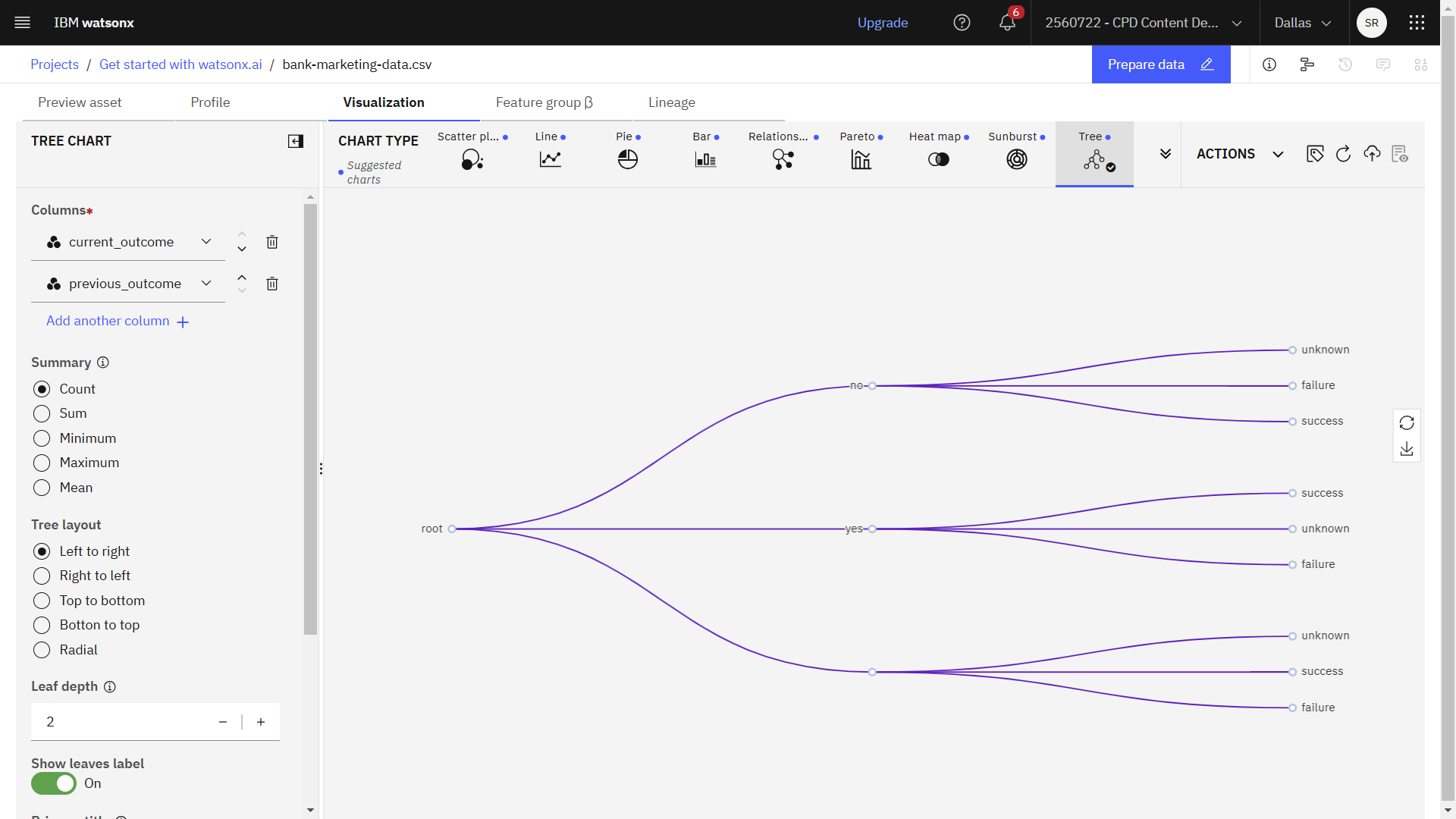

Task 2a: Visualize the data
First, you visualize the data to see if there are any obvious anomalies. Follow these steps to visualize the data:
  1. Open the bank-marketing-data.csv data set. The columns contain information about potential customers.
  2. Click the View asset info icon View asset info to close the About this asset pane.
  3. Click the Visualization tab.
    1. Select the current_outcome column as the Columns to visualize. This column indicates if the person contacted accepted the current offer; this column is the target column when you build the model.
    2. Click Add another column, and then select the previous_outcome column. This column indicates if the person contacted accepted the previous offer. Notice that the chart types with a blue dot are the suggested charts.
    3. Select the Tree chart type. This chart shows a comparison of people who accepted a previous offer and whether those same people accepted the current offer.
    4. Hover over the root node to see the total number of records in the data set.
    5. Similarly, hover over the no and yes nodes to see those totals.
    6. Hover over the unlabeled node to see the total number of records in the data set where the current_outcome field is null.
The following image shows a visualization of the bank-marketing-data.csv file. Now you are ready to prepare thetraining data.
Visualization of the training data

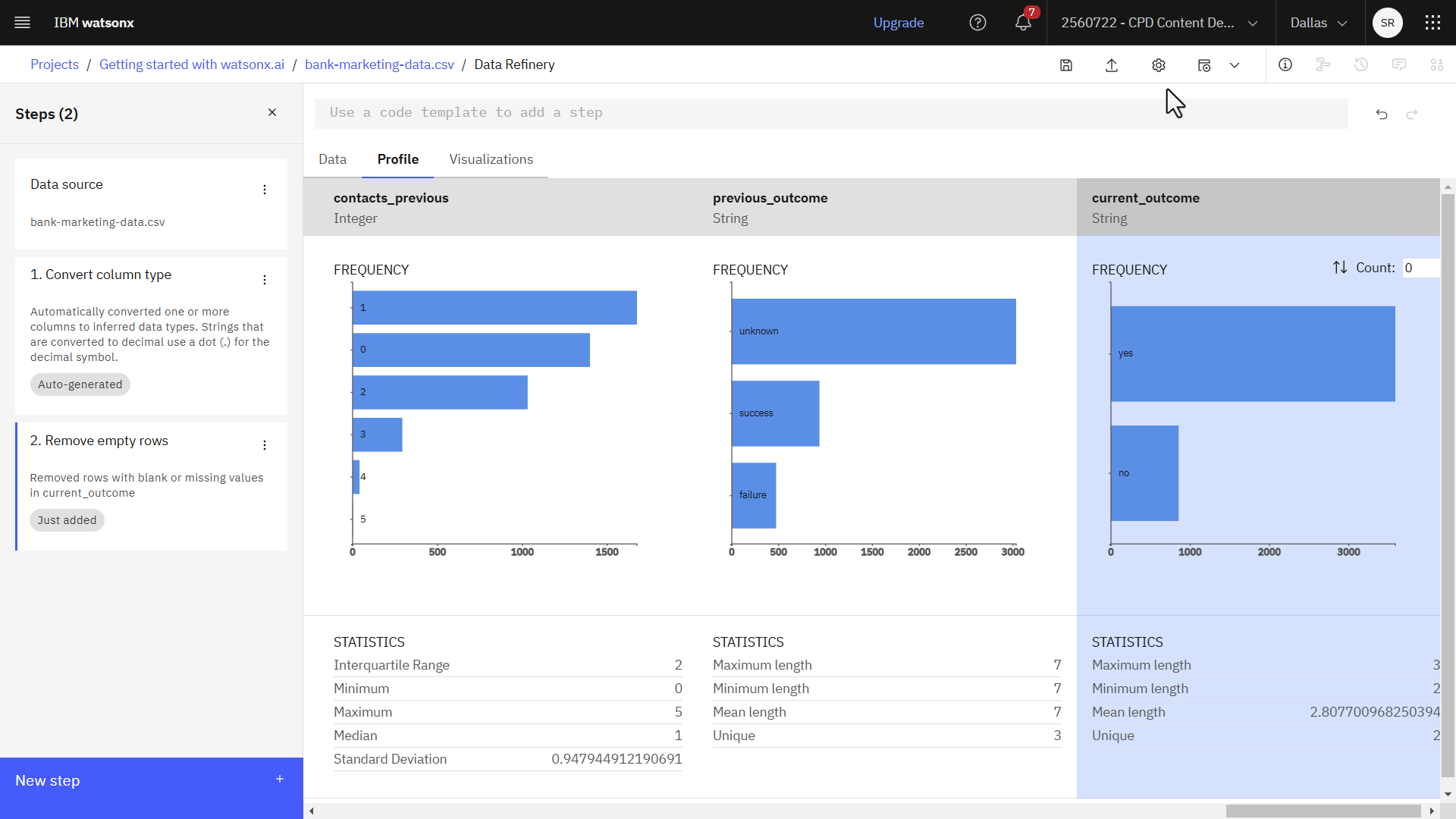

Task 2b: Prepare the data
Since current_outcome is the target column, you need to prepare the data set to remove the rows with null values. Follow these steps to prepare the data set:
  1. Click Prepare data to open Data Refinery.
  2. Close the About this asset pane.
  3. Select the current_outcome column.
  4. Click New step > Remove empty rows.
  5. Click Apply.
  6. Click the Profile tab to verify the action.
  7. Scroll to the current_outcome column to see that all of the values are either "yes" or "no".
The following image shows the current_outcome column on the Profile tab. Now you are ready to build the model using this training data.
The current_outcome column on the Profile tab

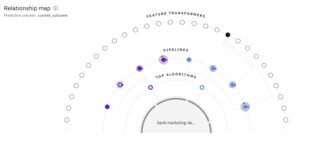

  8. Click Run experiment. As the model trains, you see an infographic that shows the process of building the pipelines.
    Build model pipelines
    For a list of algorithms, or estimators, available with each machine learning technique in AutoAI, see: AutoAI implementation details.

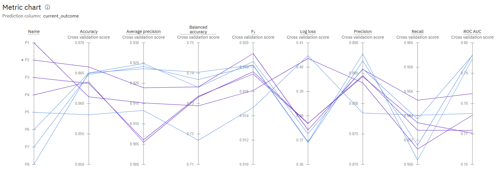

  9. After the experiment run is complete, view the ranked pipelines in a leaderboard.
    Pipeline leaderboard
  10. Click Pipeline comparison to see how they differ.
    Pipeline comparison metric chart

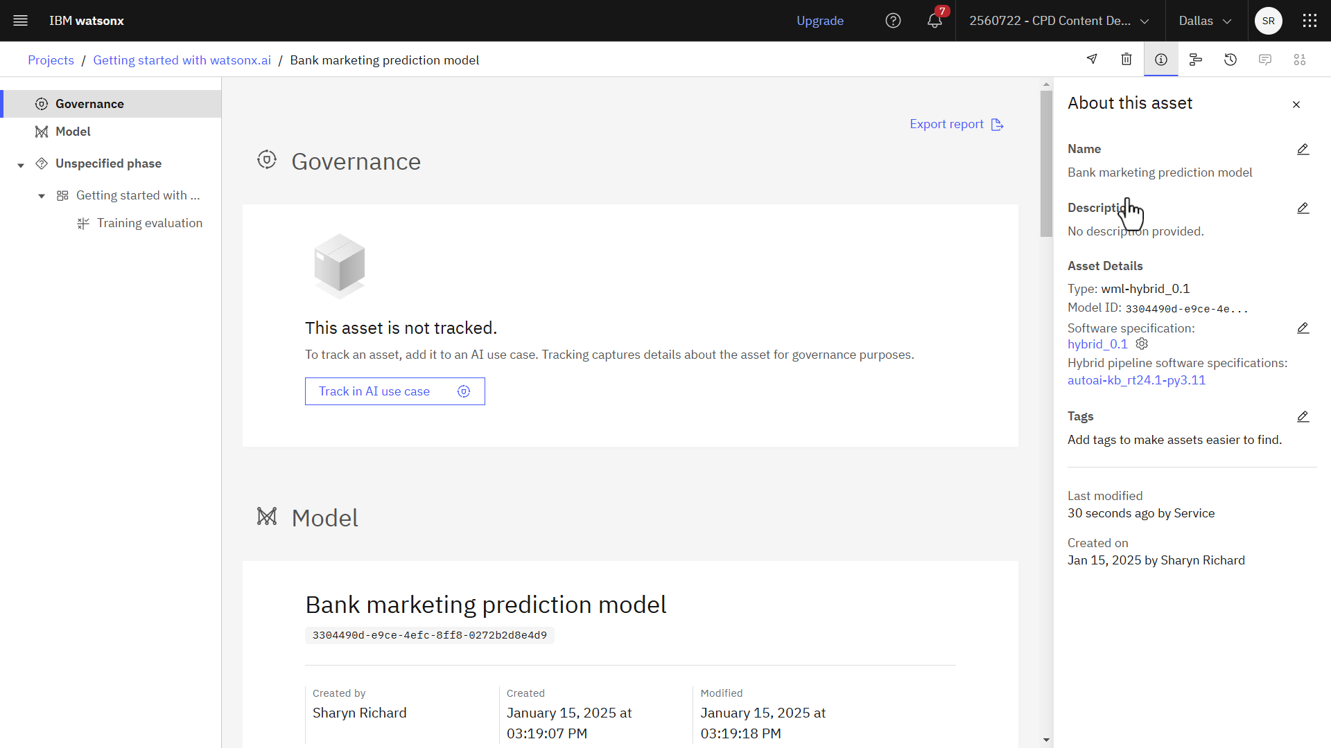

  14. When the model is saved, click the View in project link in the notification to view the model in your project. Alternatively, you can navigate to the Assets tab in the project, and click the model name in the Models section.
The following image shows the model.

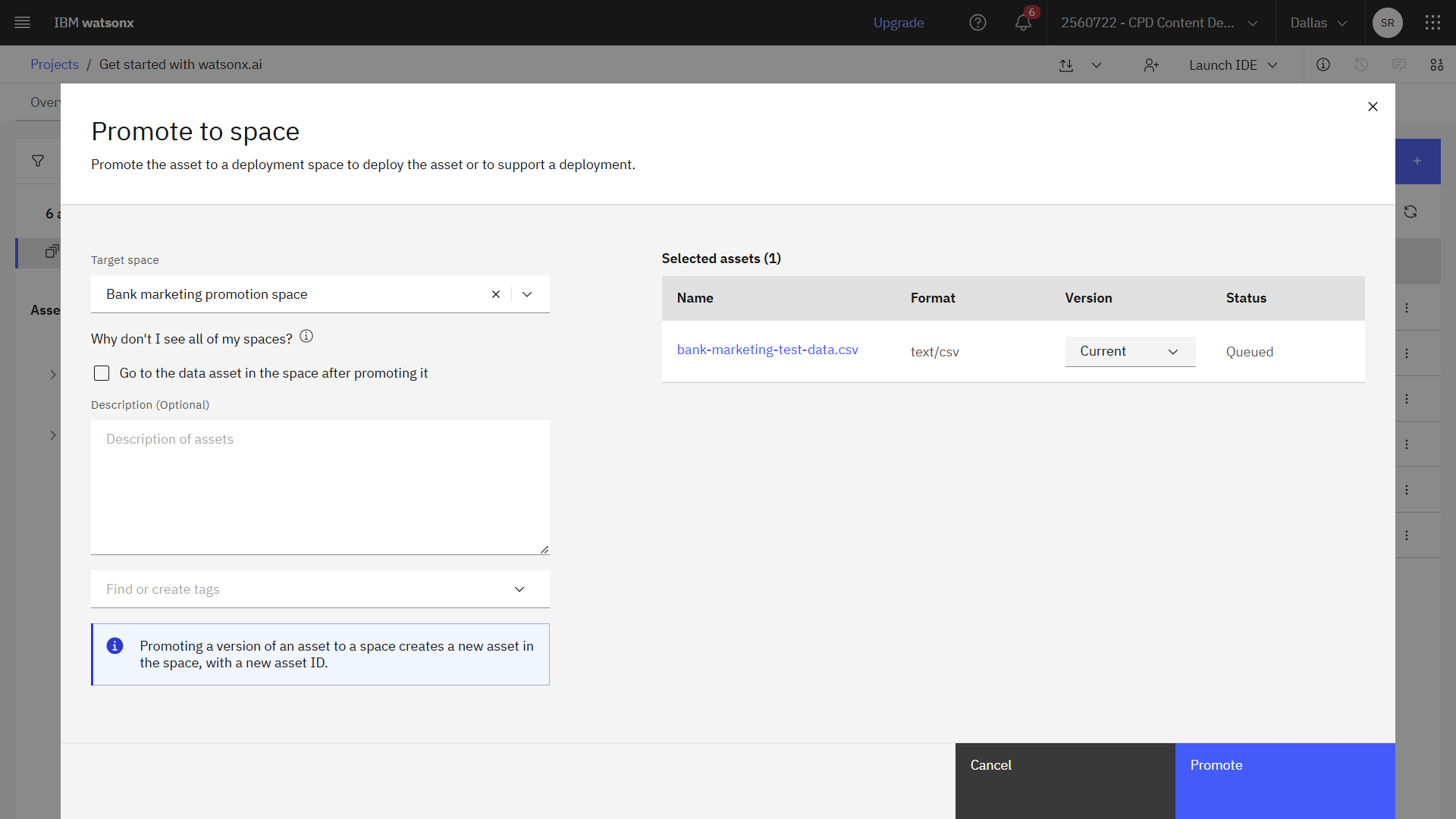

Task 4a: Promote the test data to a deployment space
The sample project includes test data. You promote that test data to a deployment space, so you can use the test data to test the deployed model. Follow these steps to promote the test data to a deployment space:
  1. Return to the project's Assets tab.
  2. Click the Overflow menu Overflow menu for the bank-marketing-test-data.csv data asset, and choose Promote to space.
  3. Choose an existing deployment space. If you don't have a deployment space:
    1. Click Create a new deployment space.
    2. For the name, type:
      Bank marketing promotion space
    3. Click Create.
    4. Close the notification when the space is ready.
  4. Select your new deployment space from the list.
  5. Click Promote.
  6. Click Close to return to the project's Assets tab.
The following image shows the Promote to space page.

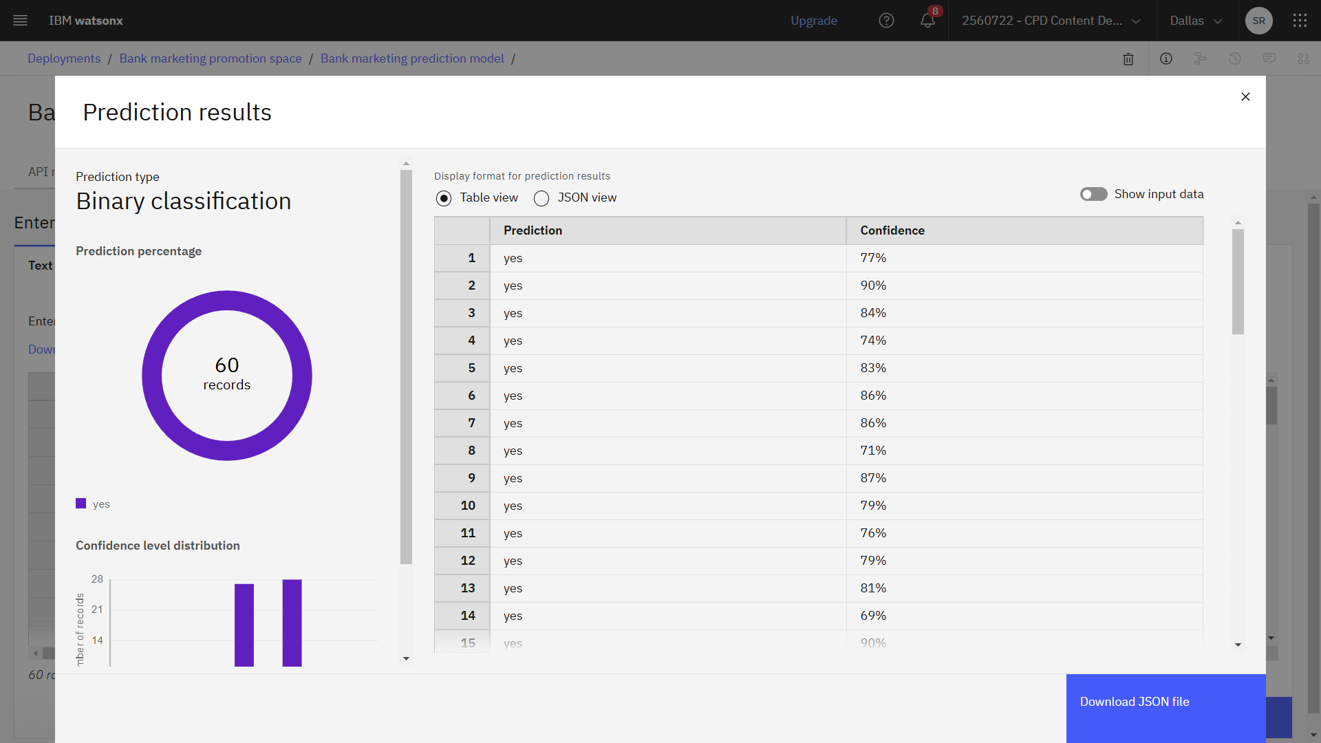

  4. Test the model.
    1. Click the Test tab. You can test the deployed model from the deployment details page in two ways: test with a form or test with JSON code. In this case, you select the CSV file that you promoted from the sample project to the deployment space.
    2. To locate the test data, click Search in space.
    3. Select Data asset > bank-marketing-test-data.csv.
    4. Click Confirm.
    5. Click Predict, and review the predictions for the 60 records in the test data. The model returns yes for every customer for which the model predicts the bank customer will subscribe to a term deposit.
The following image shows the test results from the deployed model.

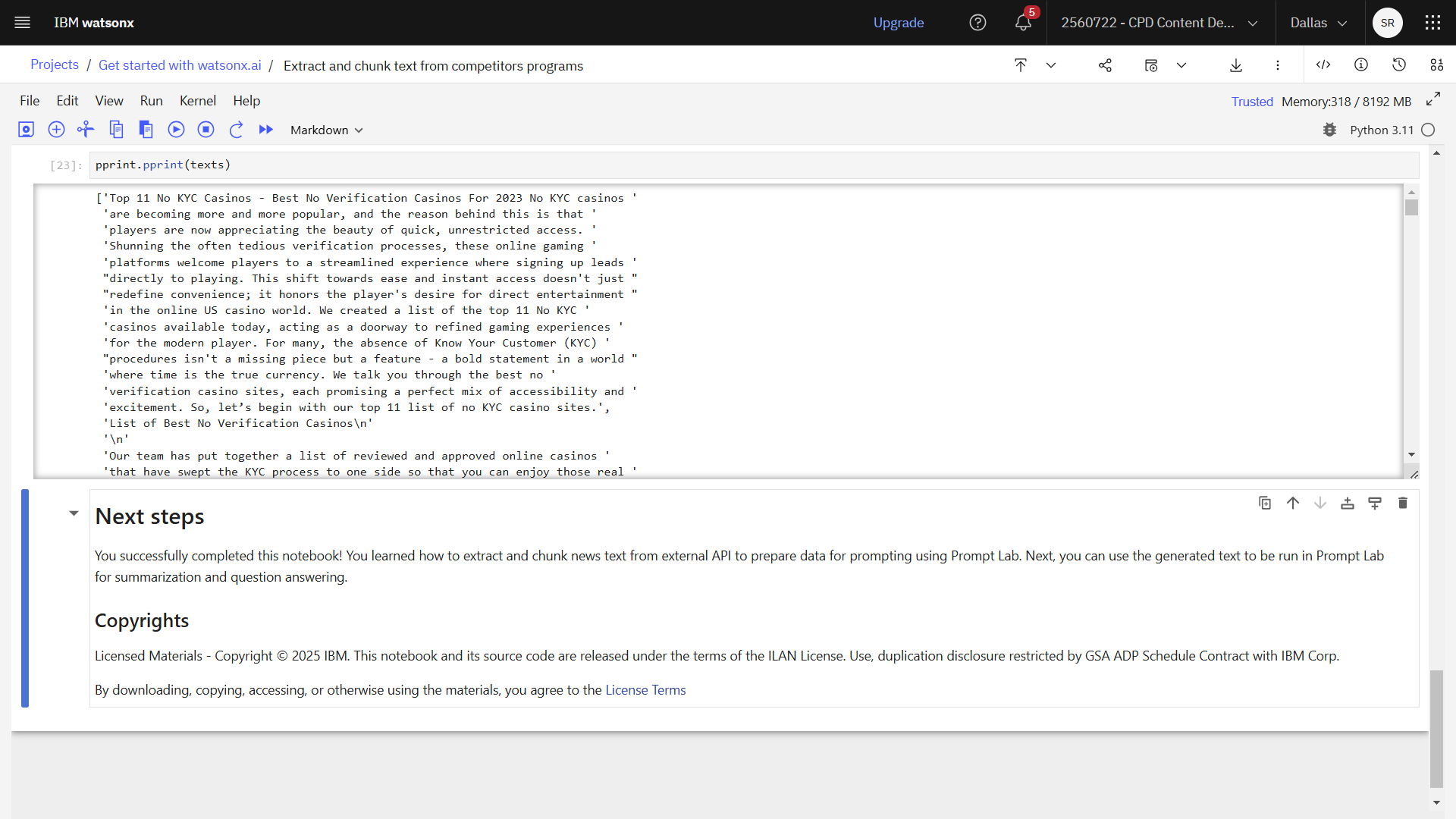

Although the Prompt Lab can work with structured and unstructured text, it is essential to ensure that you input the right data that the model can process. You can do this in a Jupyter notebook with Python code.
Since the foundation models have a limit on the number of tokens they can process in a single prompt (known as the context window), you may need to chunk or summarize the data to fit within this limit. This step ensures that the input data is in a format that the foundation model can effectively process without losing essential information.
Follow these steps to run the notebook:
  1. From the Navigation Menu Navigation menu, choose Projects > All projects.
  2. Open the Getting started with watsonx.ai project.
  3. Click the Assets tab.
  4. Click the Overflow menu Overflow menu for the Extract and chunk text from competitors programs notebook, and choose Edit.
  5. Complete the Setup section.
    1. Click the Run icon Run for the first cell to import the libraries.
    2. Obtain the necessary API keys:
      1. Follow the link to create an account and API key at TheNewsAPI.
      2. Paste the API key in the thenewsapi_key variable.
      3. Follow the link to create an account and API key at ArticlExtractor.
      4. Paste the API key in the extract_key variable.
    3. Run the cell to set the two API key variables.
  6. Run the cells in the Define the function to get news article URLs section.
    • The first cell in this section defines a function to get data from TheNewsAPI's Top Stories and set up parameters to make sure that you can get relevant news.
    • The second cell in this section defines a function to get a list of URLs based on the response.
  7. Run the cells in the Define the function to extract news text section.
    • The first cell defines a function to extract news text from a specific news URL using ArticlExtractor API.
    • The second cell defines a function to combine news text from all of the article URLs obtained from TheNewsAPI.
  8. Run the cell in the Define the function to chunk news text section.
    • The first cell in this section defines a function to use LangChain to split the character text by taking into account the context of the news text. To make sure the foundation model can take on the information from the text, you need to make sure the token doesn't exceed the context token window limitations.
    • The second cell in this section shows the response. You can see that the final output of data is ready to be fed into the Prompt Lab. LangChain’s text splitter splits the long text up into semantically meaningful chunks, or sentences, and combines them again as a whole text to be processed. You can adjust the maximum size of the chunks.
The following image shows the completed notebook. You now have the chunked text to use to prompt the foundation model.
The completed notebook
