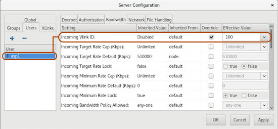

  5. Apply a Vlink to users.
    Assign a Vlink to global, group, or user settings. The example assigns a Vlink to a user's incoming transfer session.
    In the Configuration window, click the Users tab and select the user to whose transfers you want to apply the Vlink. In the right panel, click the Bandwidth tab, select the override box in the Incoming Vlink ID row and select the Vlink to apply from the drop-down menu:
    Assign a Vlink to a user
