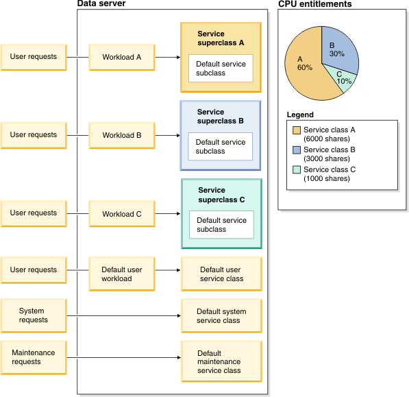

Figure 3 shows a data server configuration. For illustration purposes to help describe the basic concepts, assume that there is negligible work running in the default user, maintenance, and system service classes. At the start of the scenario, consider that there is enough work executing in the user service superclasses A, B, and C to use the full CPU resource entitlements for those service classes. For the following scenario, there is only one Db2 instance with one database and only one logical member on this host or LPAR.
Figure 3. Data server configuration
As shown in Figure 3, the CPU entitlement percentage for each of the service superclasses is calculated as follows:
  • Service superclass A has 60%
    (6000 / (6000 + 3000 + 1000)) x 100
  • Service superclass B has 30%
    (3000 / (6000 + 3000 + 1000)) x 100
  • Service superclass C has 10%
    (1000 / (6000 + 3000 + 1000)) x 100

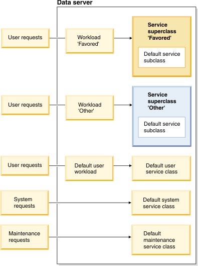

    Figure 4 shows the resulting data server configuration.
    Figure 4. Data server configuration
    For simplicity, assume only a negligible amount of work is running in the service classes other than 'Favored' and 'Other'.

    The resulting data server configuration looks like the one shown in Figure 4.
