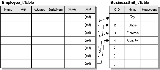

You can define relationships between objects in one typed table and objects in another table. You can also define relationships between objects in the same typed table.
Employee table, the Dept column
of the Employee table can contain a logical pointer
to one of the departments in the BusinessUnit table.
These pointers are called references, and are illustrated in Figure 1.
