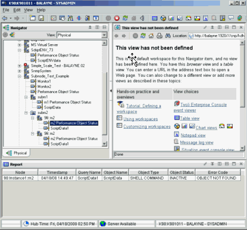

In an IBM Tivoli Monitoring environment, a subnode instance is displayed within the agent in the Navigation Physical view in the Tivoli Enterprise Portal. Workspaces display the data that is produced by a subnode instance and situations can be distributed to one or more instances of a subnode. A managed system list is automatically created that contains all instances of the subnode, just like the Managed System List that is created for an agent.

In the Tivoli Enterprise
Portal Navigator tree, a subnode type is displayed under the agent
name, and subnode instances are displayed under a subnode type. Subnodes
are identified by a Managed System Name (MSN) just like agents, for
example 94:Hill.cmn.
94:Hill:cmn, 94:Meadow:cmn,
and 94:Tree:cmn representing three common areas in
the kennel. The Kennel Run subnode type has four subnode instances: 94:system1:run, 94:system2:run, 94:system4:run,
and 94:system5:run representing four kennel runs.

There are two ways to determine status for a subnode agent. The first way is to look at the data that is displayed in the Performance Object Status attribute group. This attribute group displays the status for each of the other attribute groups at the same level in the agent. The Performance Object Status attribute group at the agent level displays the collection status for the other attribute groups at the agent level. The Performance Object Status attribute group in each subnode displays the collection status for the attribute groups in that subnode.
Agent Builder also creates one attribute group for each subnode type, which displays one row for each configured subnode of that type. In the example in (Figure 4), four subnodes are running to collect data.
In the IBM Tivoli Monitoring environment, the Performance Object Status subnode contains data visible in the Navigator tree and can have situations that monitor the status of the other data collections.
