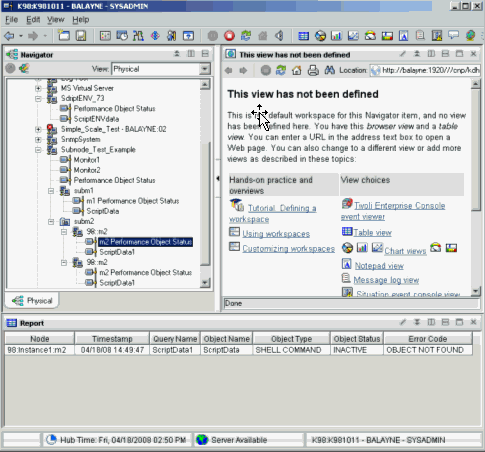

The example in Figure 5 shows a case where the data collection failed (the script shell command was not found). Typically, any value other than NO_ERROR indicates that there is a problem. For each of the data collectors that are defined in the subnode, there is one row in the table.
Figure 5. Example: data collection in a subnode
Data Collection window with an OBJECT NOT FOUND error that is displayed in the Report section.
