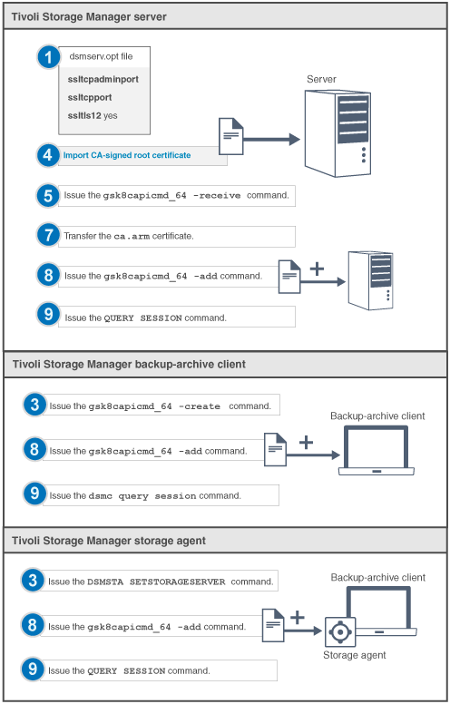

The following figure shows the step number to complete the task.
The image is a graphical depiction of how you configure SSL by using CA certificates, and provides the number for each task step.
