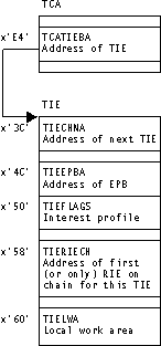

Field TCATIEBA in the TCA points to the first TIE, and TIECHNA in each TIE points to the next TIE in the chain.
The TIE holds information relevant to all invocations of the task-related user exit for the task concerned. For example, TIEFLAGS holds information concerning the events for which the task-related user exit should be invoked, for example, API calls, syncpoint, and task start.
Figure 2 gives a closer look at the TIE control block chain that is used during the lifetime of a task-related user exit.
Figure 2. Control blocks used during the lifetime of a task-related user exit
Diagram showing the control blocks used during the lifetime of a task-related user exit, and their relationships to each other.
