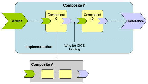

A complex composite
The model for encapsulating the implementation details in components is a very flexible way to create hierarchical composite applications. In the following example, composite Y contains two components. However, in this example, the implementation of component C is itself a composite that has two components inside it. Any client that wants to call the service offered by composite Y does not require knowledge of the components that are in composite C, meaning that the underlying implementation details can change without affecting the client.
The external service and reference of composite Y is formed by promoting the service of component C and the reference of component D. The wire between component C and D is a target, where the bindings on each interface are the same. In this example, the components are using a CICS binding.
