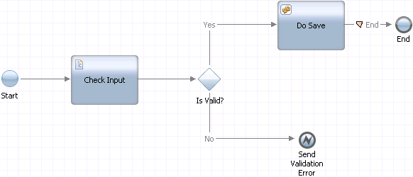

    4. In Diagram page, add the following elements:
      • A server script to validate the data
      • A decision gateway to route the flow according to whether the data is valid
      • A nested service or other elements to handle when the data is valid. For example, a nested service that saves the coach data or an end event to complete the service.
      • An error end event
    5. Connect the Start node to the script and connect the script to the decision. Connect the gateway to the flow that handles valid data such as a service that saves coach data. Select the flow line and rename it to Yes. Connect the gateway to the error end event. Select the flow line and rename it to No. The resulting diagram looks something like this example:
      Service diagram

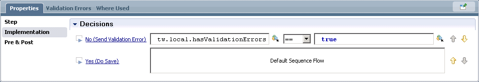

    7. In the Implementation properties of the decision, add the following code to the No branch:
      tw.local.hasValidationErrors == true
      The No branch of the decision with tw.local.hasValidationErrors in the first field, == in the second field, and true in the third field.

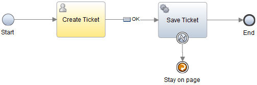

  3. Open your client-side human service. The Process Designer web editor displays the human service.
  4. In your client-side human service, add a service to your diagram and wire your coach to the service.
    The coach that is connected to a service

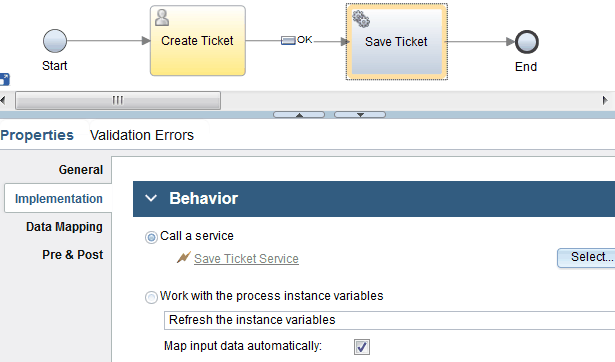

  5. In the Implementation properties of the service node, select to call a service and then select the server-side validation service that you created in step 2.
    The implementation properties of the client-side service that shows it calling the server-side service that does the data validation
  6. In the Data Mapping properties, map the variable that contains the coach data to the appropriate business object.
  7. Add an intermediate event to the service. Because it is attached to a service, the intermediate event is an error boundary event.
  8. In Implementation properties of the error boundary event, set it to catch specific errors and map the error data to the tw.system.coachValidation variable.
  9. Connect the error boundary event to a stay on page node.
    The boundary intermediate event on the nested service connected to the stay on page event.

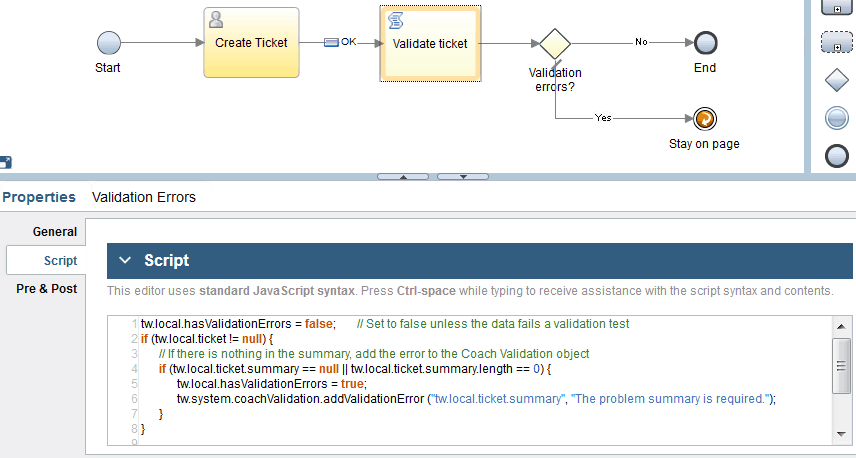

  10. Alternatively, you can add a client-side script node after the coach, followed by a decision gateway, and specify the coach validation logic in the script:
    A client-side validation script that contains the coach validation logic is added to the human service diagram after the coach, and is connected to a decision gateway. The yes path is connected to a stay-on-page event, and the no path is connected to the end event.
