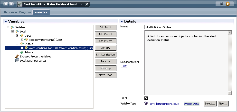

  1. Create an integration service called Alert Definitions Status Retrieval Service.
  2. Add the following input variable:
    • categoryFilter(String)(List)
    The service accepts this input to determine which type of alert definitions to retrieve.
  3. Add the following output variable:
    • alertDefinitionsStatus(BPMAlertDefinitionStatus)(List)
    The output variable contains the list of alert definitions that the service retrieved based on the type of alerts that the user wants to see. The BPMAlertDefinitionStatus type is in the System Data toolkit to support BPM alerts.
    The input and output variables of the integration service

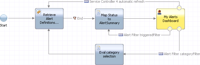

Create the human service to support the user interface
The sample uses a heritage human service to define the flow between the integration service and the user interface defined in a coach.
Exposing the user interface as an administration service in the Process Admin Console requires using a heritage human service instead of a client-side human service.
  1. Create a heritage human service called My Alerts Dashboard.
  2. Add the following private variables to the My Alerts Dashboard human service:
    Private Variable Default Value Description
    refresh(Boolean) Set to true to trigger a boundary event that calls the integration service to retrieve the alert definitions again.
    refreshInterval(Integer) 60 The number of seconds between refreshes
    categoryFilter(String)(List) The type of filter to use to retrieve alert definitions if the user has selected process instance alerts or task alerts. Valid values are "INSTANCE" or "TASK". This is optional and if it does not have a value, both types of alert definitions are retrieved.
    alertDefinitionsStatus(BPMAlertDefinitionStatus)(List) The status of the retrieved alert definitions such as whether they have been triggered.
    alertStatusSummaries(AlertStatusSummary)(List) The prepared list of alerts to display.
    selectedCategoryFilter(String) "" Whether the user wants to see the alert definitions for process instances, for tasks, or both.
    selectedTriggeredFilter(String) "true" Whether the user wants to see only alert definitions that have triggered an alert or all alert definitions.
  3. In the human service diagram, add a nested service, two server scripts, and a coach. Rename them using the information in the following table:
    Artifact New Name
    Nested service Retrieve Alert Definitions
    Server Script Map Status to AlertSummary
    Server Script (1) Eval category selection
    Coach My Alerts Dashboard
  4. Select the nested service and then set its properties:
    1. In its Implementation properties, attach the Alert Definitions Status Retrieval Service that you created in the previous section.
    2. In the input mapping of the Data Mapping properties, map the categoryFilter variable of the human service to the categoryFilter variable of the Alert Definitions Status Retrieval Service.
    3. Similarly, in the output mapping, map the alertDefinitionsStatus variable of the Alert Definitions Status Retrieval Service to the alertDefinitionsStatus variable of the human service.
    Data mapping properties of the nested service
  5. Select the Map Status to AlertSummary script and then add code to its Implementation properties. The code maps the AlertDefinitionsStatus objects output by the Alert Definitions Status Retrieval Service to the local AlertStatusSummary business object that you created earlier. The code also makes the condition more readable by people.

  6. Select the Eval category selection script and then add code to its Implementation properties. The code creates the overall filter used by the Alert Definitions Status Retrieval Service as its input.
    // if "All" category has been selected
    if (tw.local.selectedCategoryFilter == "") {
        tw.local.categoryFilter = null;
    // if another category has been selected, build the correct categoryFilter
    } else {
        tw.local.categoryFilter = new tw.object.listOf.String();
        tw.local.categoryFilter.insertIntoList(0, tw.local.selectedCategoryFilter);

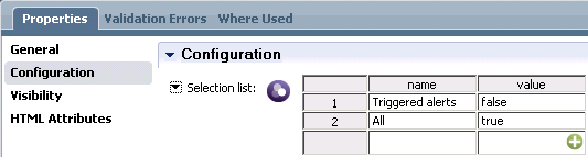

    10. Select the first Alert Filter instance. In its General properties, bind the instance to the selectedTriggeredFilter variable. To distinguish between the boundary events broadcast by the Alert Filter instances, append triggeredFilter to the label.
    11. In its Configuration properties, expand Selection list. Add the following name-value pairs:
      Name Value
      Triggered alerts false
      All true
      Name value pairs for first filter
      The names are what the filter displays at run-time.

  1. In the My Alerts Dashboard diagram, make the following connections:
    From To
    Start Retrieve Alert Definitions
    Retrieve Alert Definitions Map Status to AlertSummary
    Map Status to AlertSummary My Alerts Dashboard
    My Alerts Dashboard Retrieve Alert Definitions using the boundary event of the Service Controller
    My Alerts Dashboard Map Status to AlertSummary using the boundary event of the triggeredFilter Alert Filter
    My Alerts Dashboard Eval category selection using the boundary event of the categoryFilter Alert Filter
    Eval category selection Retrieve Alert Definitions
    The heritage human service diagram
