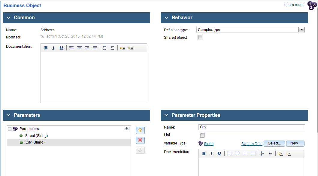

  5. Click the plus sign (+) next to Data, then click New > Business Object and complete the wizard to create an Address business object with the following parameters:
    The Address business object contains two parameters: Street (String) and City (String).

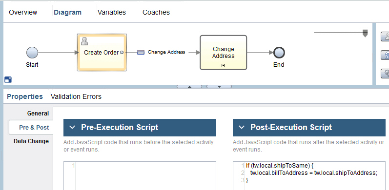

  7. Optional: If you want to synchronize the customer's shipping and billing addresses as part of your Create Order page, add a post-execution script to the page, which can be similar to the JavaScript code in the following example. The post-execution script runs immediately after the execution of the page completes and synchronizes the two addresses.
    Screen capture to show the Create Order page in the Diagram view, and the Post-Execution Script next to the Pre-Execution Script.
    After you assigned the post-execution script to the page, the page node in the diagram view displays a circular indicator on the right side (post-execution).
