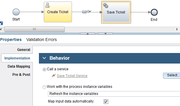

  4. In the Implementation properties of the service node, select to call a service and then select the server-side validation service that you created in step 1.
    The implementation properties of the client-side service that shows it calling the server-side service that does the data validation

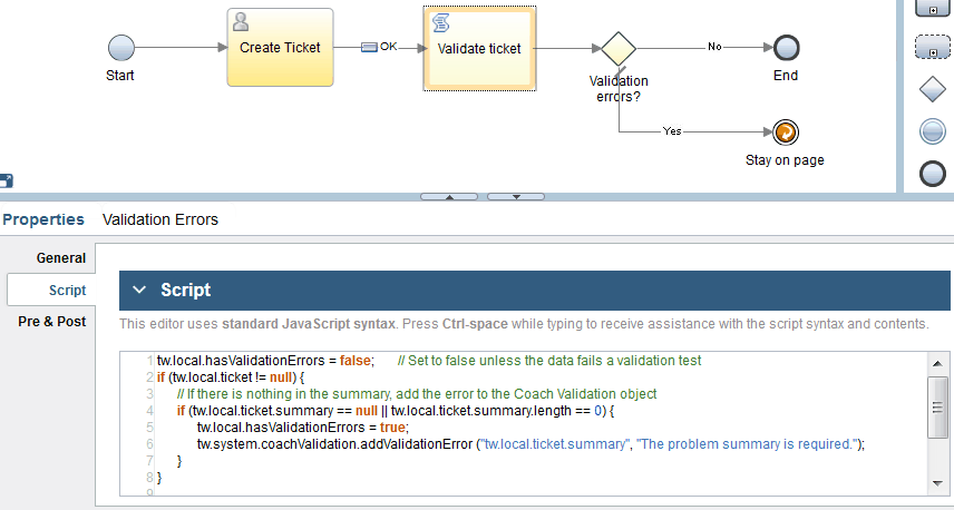

  9. Alternatively, you can add a client-side script node after the coach, followed by a decision gateway, and specify the coach validation logic in the script:
    A client-side validation script that contains the coach validation logic is added to the human service diagram after the coach, and is connected to a decision gateway. The yes path is connected to a stay-on-page event, and the no path is connected to the end event.
