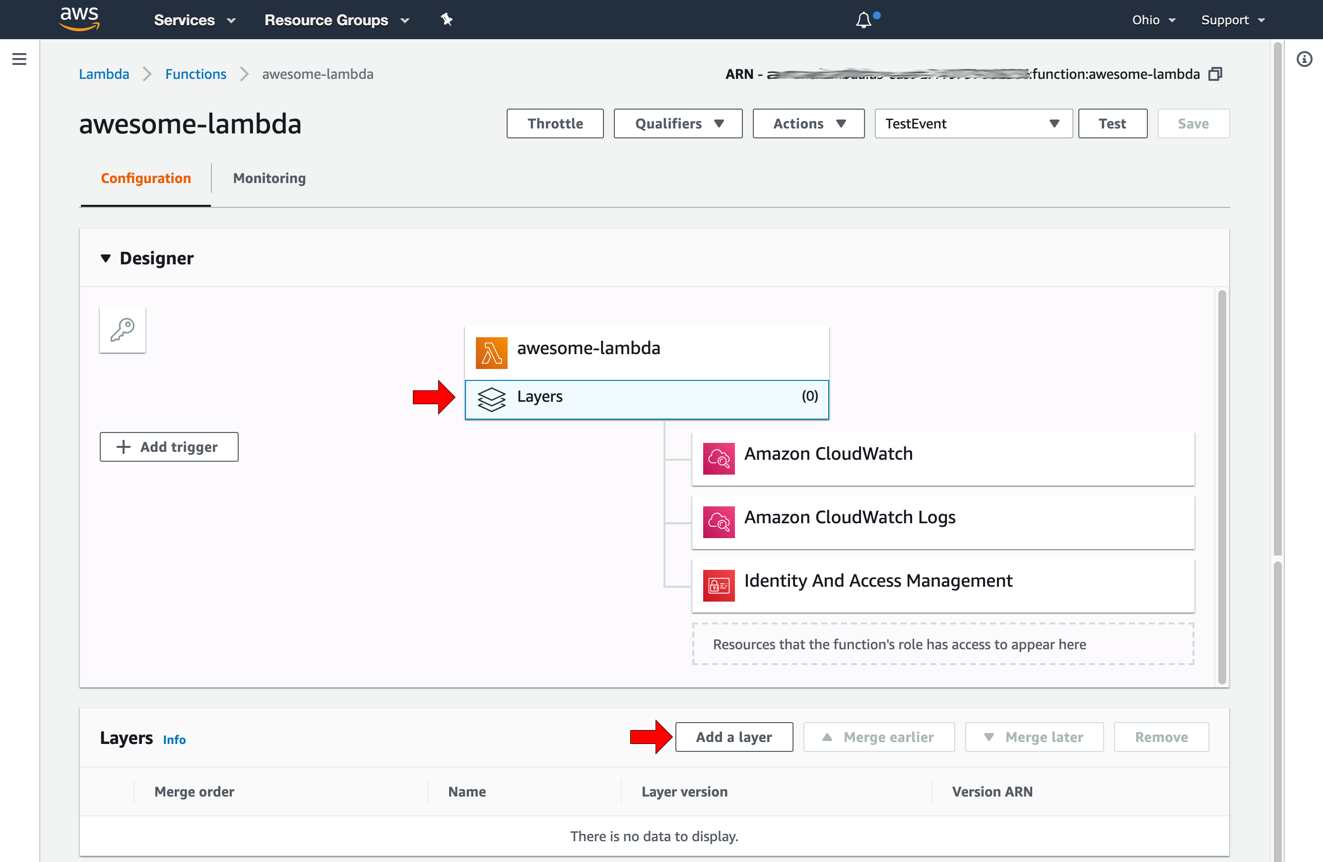

Add the Instana Lambda layer to your function.
- In the configuration page for your Lambda function, click on the
Layersbox and then onAdd a layer.

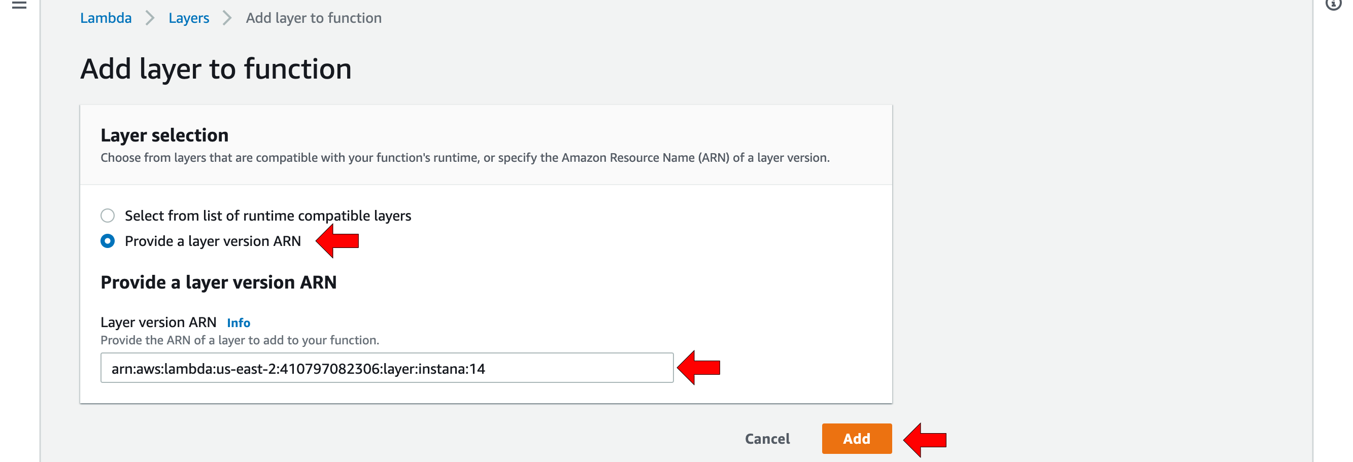

- In the popup that opens, select Provide a layer version ARN and copy and paste the ARN for the Instana Lambda Layer that matches your region; you can find the right ARN for the Instana Lambda Layer in the Instana Lambda Layers section.

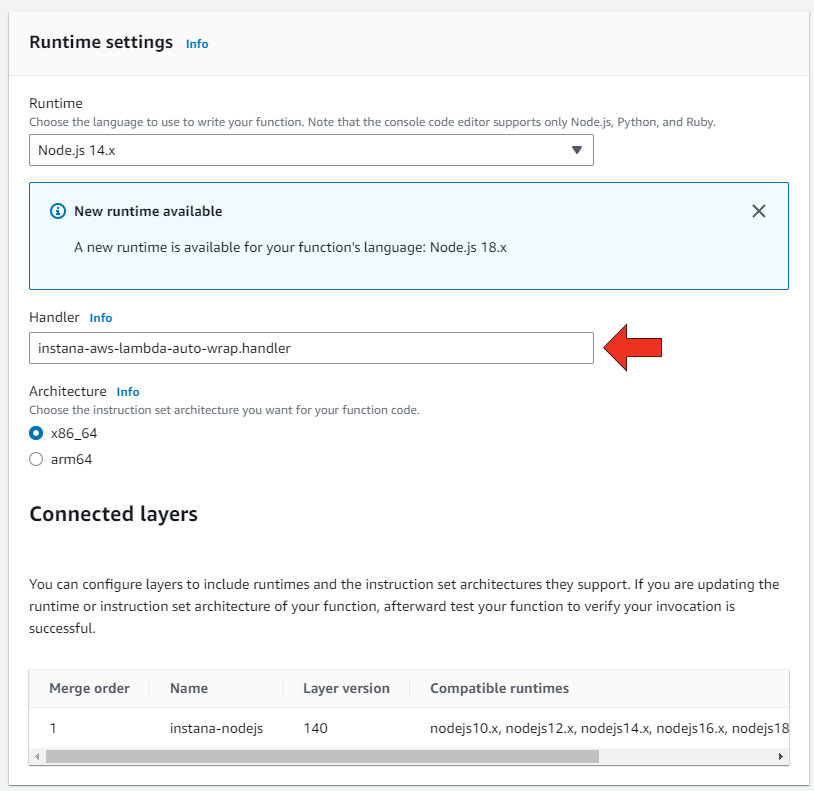

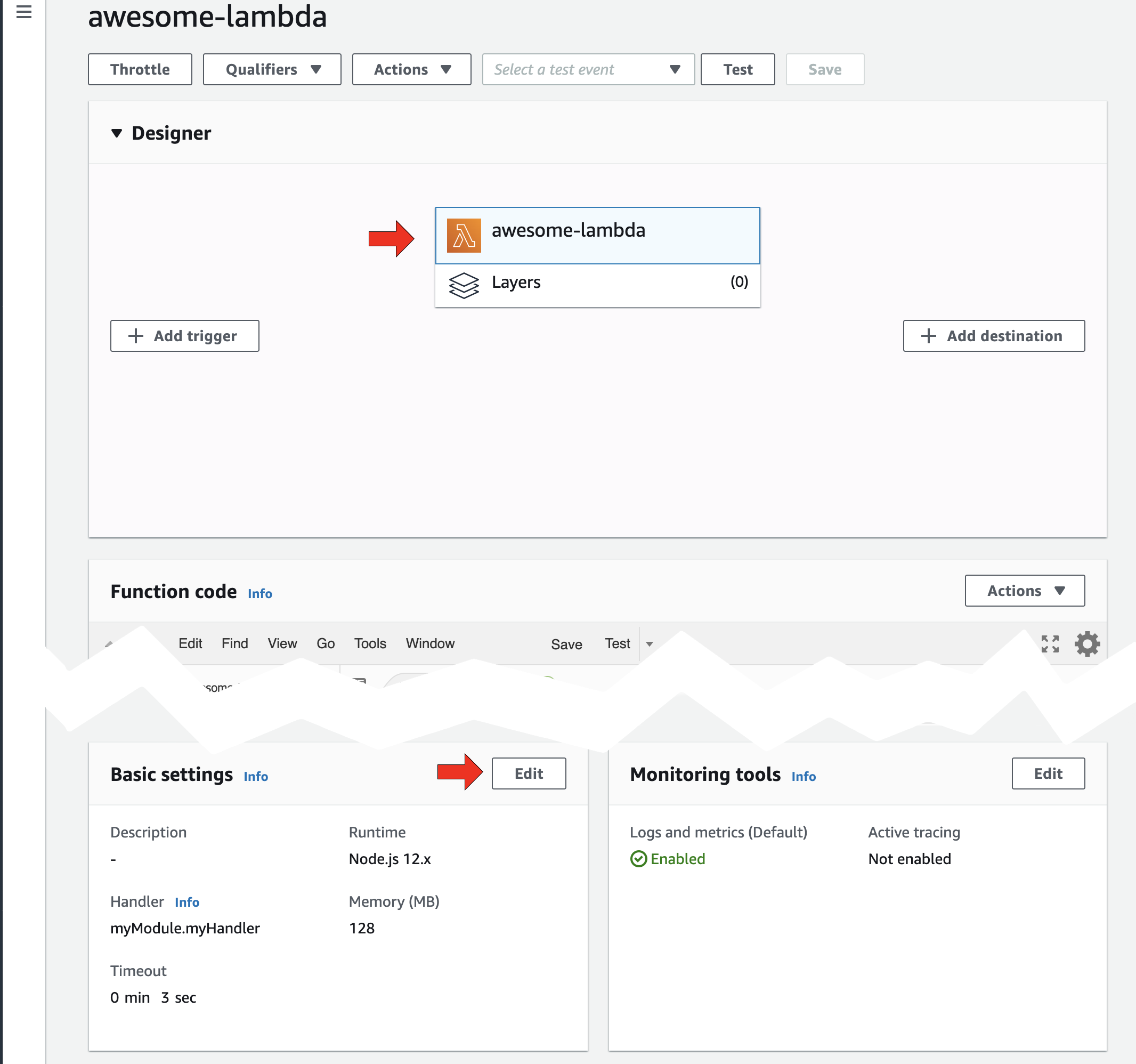

Configure the Lambda Handler. Set the handler to
instana-aws-lambda-auto-wrap.handlerif you use CommonJS. Set the handler toinstana-aws-lambda-auto-wrap-esm.handlerif you use ES Modules (ES6) (available from layer version 223).To change the setting for the Lambda handler, find the "Basic Settings" section on the configuration page.
Click on edit and insert
instana-aws-lambda-auto-wrap.handlerinto the field labeled "Handler".
The Instana Lambda layer automatically triggers the default Node.js runtime handler
index.handler. If you use a custom handler, specify your handler in the environment variable LAMBDA_HANDLER to notify the Instana Lambda Layer. See the next section for all environment variables that need to be set.The Lambda configuration page might display a warning like Lambda can't find the file instana-aws-lambda-auto-wrap.js. This might also be displayed later when returning to the configuration page. Do not let this warning distract you. The handler is contained in the Instana Lambda layer but the AWS Lambda configuration page does not take that into account.

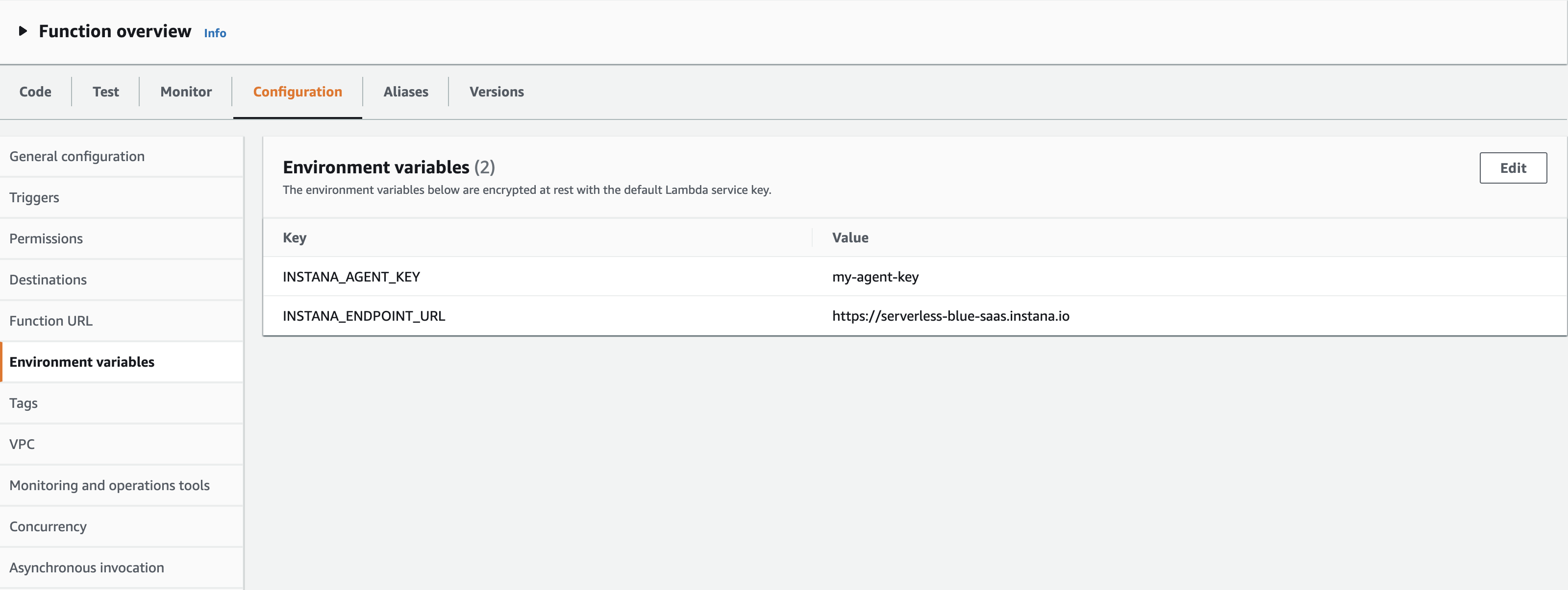

Configure Environment Variables. Add the following environment variables:
INSTANA_ENDPOINT_URL: This is your serverless monitoring endpoint. Make sure to use the correct value for your region that starts withhttps://serverless-.INSTANA_AGENT_KEY: Your agent key.LAMBDA_HANDLER: Set your custom handler. If your main file ismyModule.js, which exports the functionmyHandler, set the environment variable tomyModule.myHandler. The default value isindex.handler.
In the following example, the original main Lambda Handler is
index.js, and therefore you don't need to set the environment variable LAMBDA_HANDLER.
server.js, and therefore you need to set the environment variable LAMBDA_HANDLER toserver.handler.
You can also obtain the correct values for these environment variables by going to your Instana installation, click ... More -> Agents -> Installing Instana Agents -> Platform: AWS -> Technology: AWS Lambda.

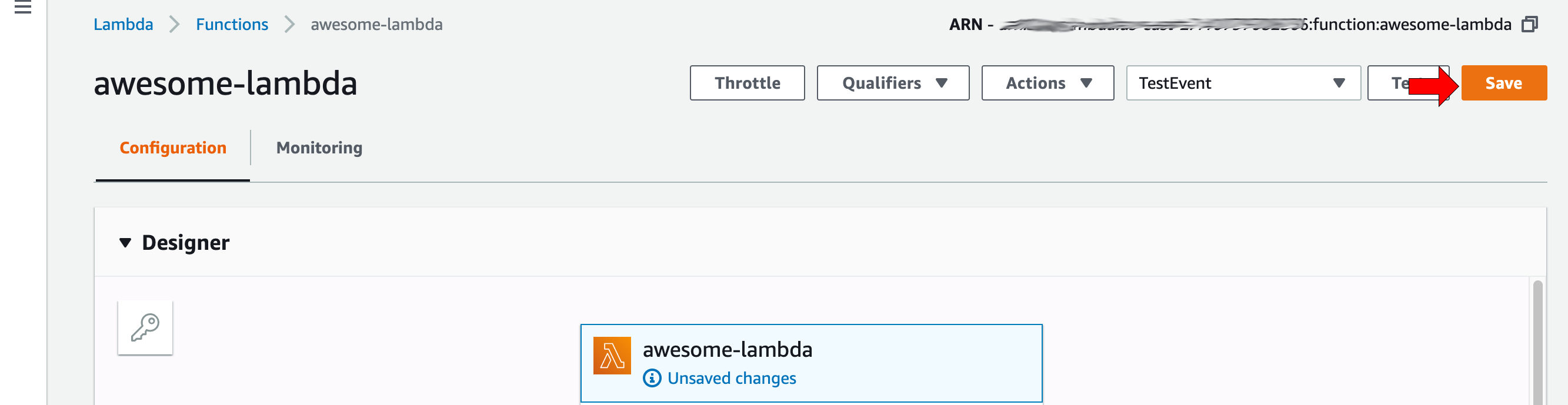

Save the Lambda function definition.

That is, the pattern is arn:aws:lambda:${region}:410797082306:layer:instana-nodejs:${layer-version} (or arn:aws-cn:lambda:${region}:107998019096:layer:instana-nodejs:${layer-version} for AWS regions in China).
Make sure to always use the latest versions and update the layer version you are using in regular intervals to benefit from new features and fixes that we provide when publishing a new version of the layer.

Additional Environment Variables
| Name | Default | Value | Description |
INSTANA_DISABLE_LAMBDA_EXTENSION |
false |
Any non-empty string. | Disable the lambda extension or not. |
INSTANA_ENABLE_LAMBDA_TIMEOUT_DETECTION |
false |
true or false |
The feature is disabled by default because the execution of a timeout handler might happen on a different execution. Use it only for debugging. Enabling it can have unintended consequences. So, enable it at your own risk. |
INSTANA_MINIMUM_LAMBDA_TIMEOUT_FOR_TIMEOUT_DETECTION_IN_MS |
2000 | Timeout in milliseconds | Increase the minimum timeout detection in milliseconds. |
INSTANA_DEBUG |
false |
true or false |
Enable the debug mode. |
INSTANA_TIMEOUT |
1000 |
Number | Timeout for sending data to the Instana backend in milliseconds. |
