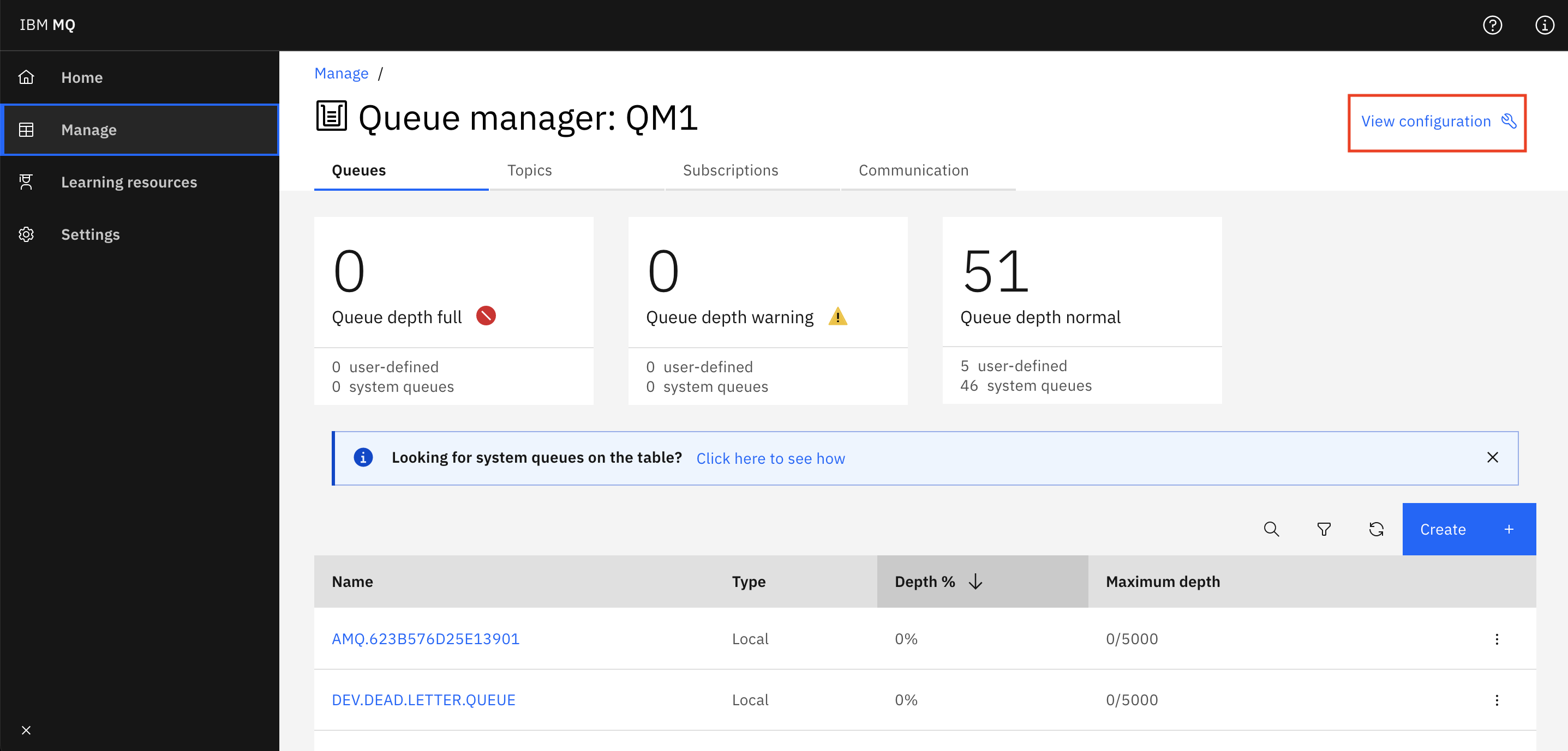

  3. Click Manage in the side menu to view your IBM MQ objects.
  4. Click View configuration.
    Shows the configuration page

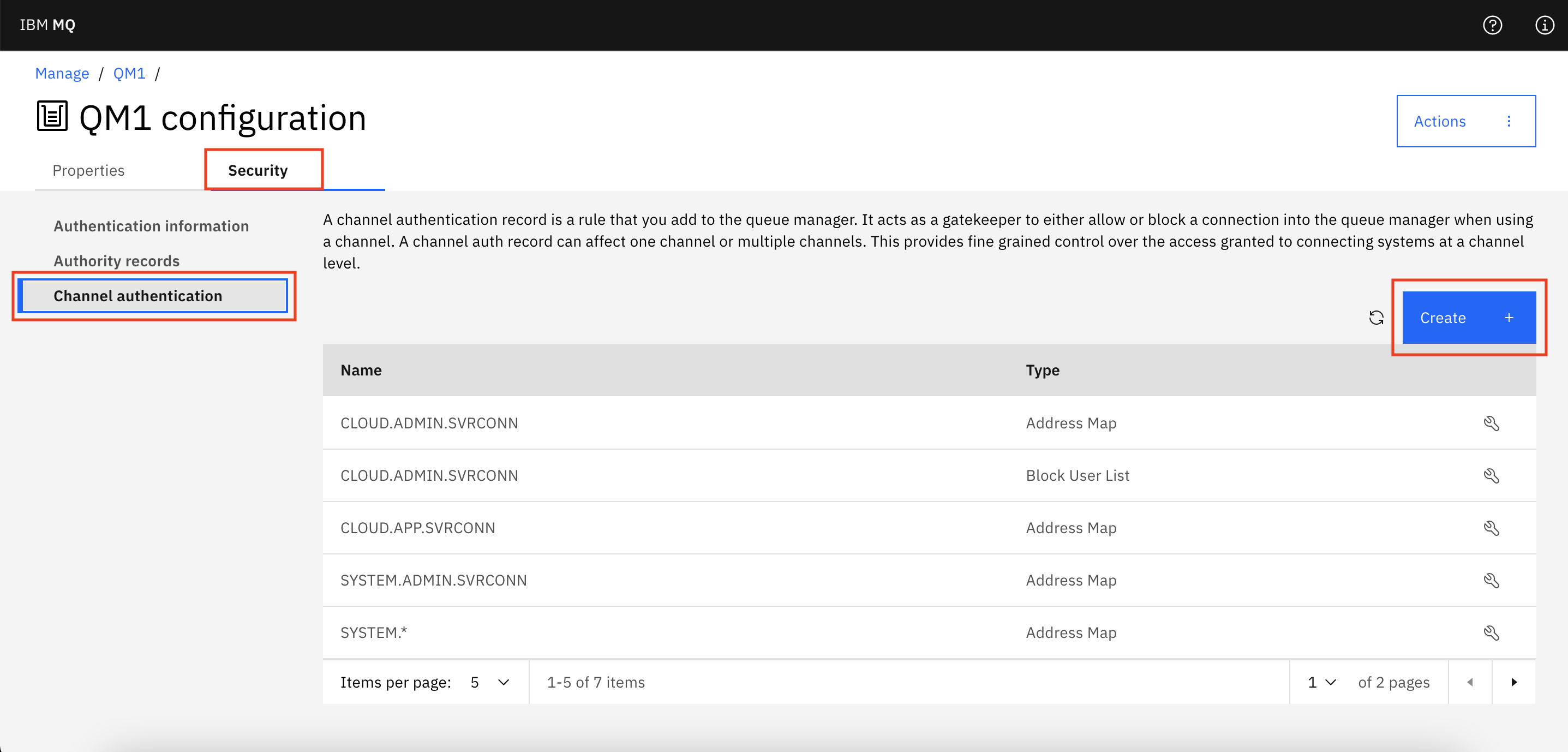

  5. Click on the Security tab and on Channel Authentication, then click on Create.
    Shows the security tab

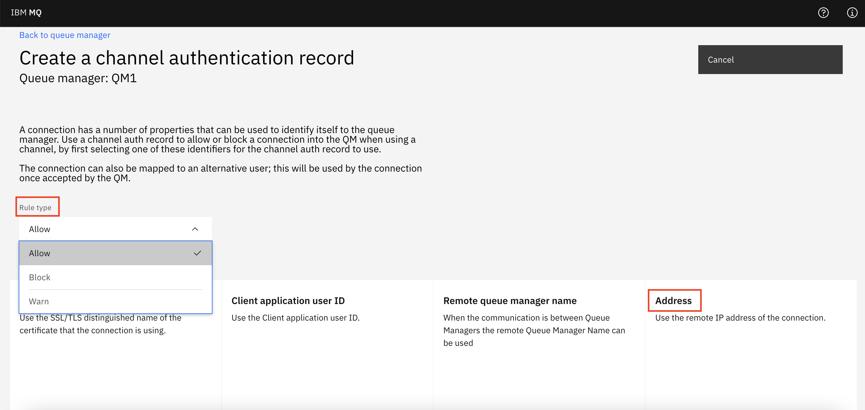

  6. From the Rule type drop-down menu, select Allow. After selecting the rule type, you can choose an identifier, select Address.
    Shows Channel authentication

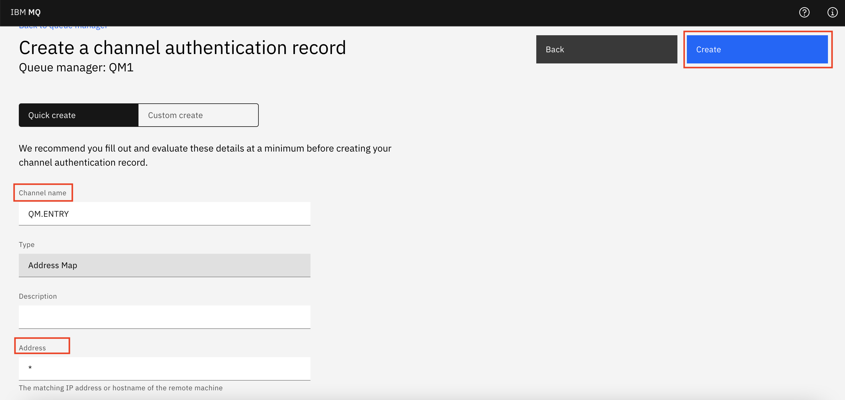

  7. On the following page, add the channel name, for example QM.ENTRY. In the Address text box add *. Finish by clicking on the Create button.
    Shows quick create
