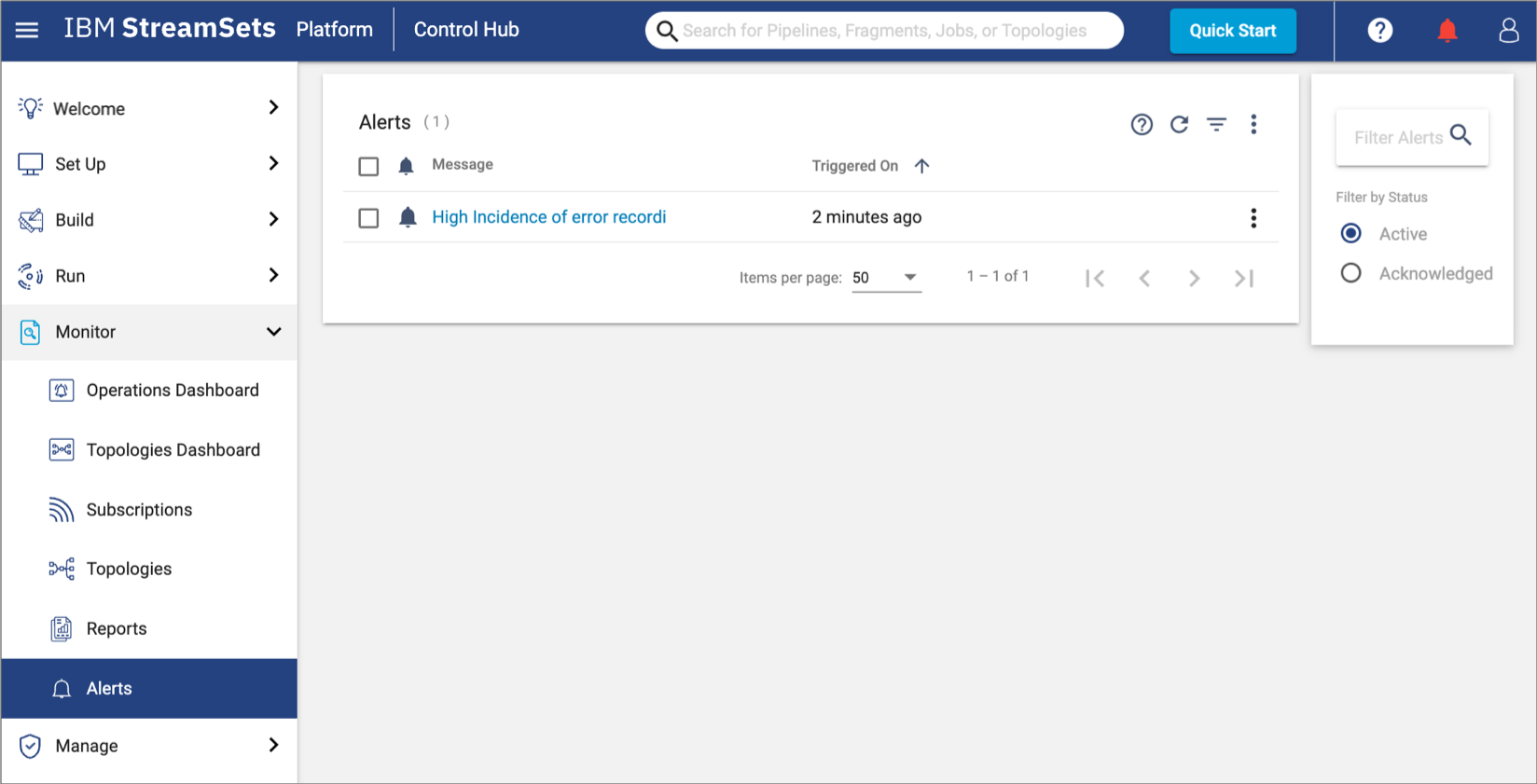

When a data SLA triggers an alert, Control Hub displays a red Alerts icon (Alerts icon) in the toolbar and lists the alert in the Alerts view.
The Alerts view lists all triggered alerts. You acknowledge and delete alerts in the Alerts view. After viewing an alert, select the alert in the Alerts view and click the Acknowledge icon (Acknowledge icon) to acknowledge the alert. You can filter the Alerts view by active or acknowledged alerts. When you filter by acknowledged alerts, you can select one or more acknowledged alerts and then delete them.
Note: Control Hub automatically displays each triggered data SLA alert in the Alerts view. You can also optionally create a subscription to perform an action when a data SLA alert is triggered.
The following image displays an active alert in the Alerts view:
Active alert displayed in the Alerts view
To view details about the data SLA threshold that was reached, click the alert message in the Alerts view. Control Hub opens the topology where the data SLA was configured. Open the topology detail pane, and then locate the Data SLA section in the detail pane. Click the data SLA label to display the details of the measured parameter.
You can modify the data SLA in real time. For example, while viewing a triggered alert, you might realize that you incorrectly configured the maximum or minimum value. Simply edit the value and click Save. The data SLA graph immediately reflects the modified threshold value.
