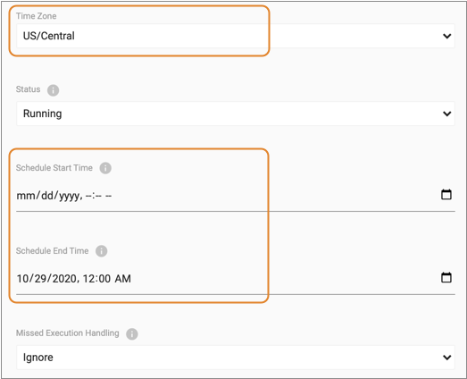

Define start and end times in the UI when you create or edit a scheduled task. Remember that the time zone specified for the task applies to the start time and end time. For example, the following image shows the configured start and end times for a scheduled task. The task specifies the US/Central time zone. The task has no defined start time and so starts running immediately after creation. The task has a defined end time of October 29, 2020. Therefore, the task stops running at 12:00 AM in the US/Central time zone on October 29, 2020.
Start and end times configured for a scheduled task
