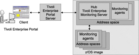

The configuration shown in Figure 1 depicts the hub monitoring server and several monitoring agents installed in the same RTE on a single z/OS® image, with the monitoring agents reporting directly to the hub. This configuration is a basic one that you can expand to accommodate more systems.
Figure 1. Hub monitoring server and monitoring agents in the same runtime environment
Configuration graphic: Hub and monitoring agents in the same runtime environment
