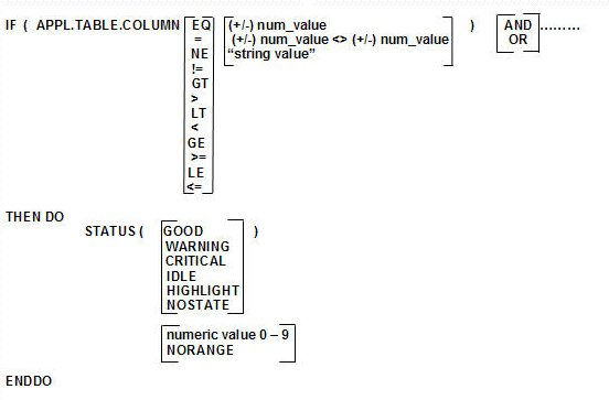

Each threshold specification consists of six required elements and three optional elements that are used when a complex threshold is specified:- IF keyword
- This keyword indicates the beginning of the threshold specification. Internal parsing considers all text between IF statements as a threshold specification. Only the first column in the IF statement is statused if it evaluates positively.
- Left parenthesis – (
- An optional left parenthesis is used to help group connected thresholds
in a complex threshold specification. Specification of the left parenthesis
is optional, but if specified it is treated based on the normal rules
of operator precedence. That is, the highest level of precedence among
parentheses and AND and OR operators. Each left parenthesis must be
matched in the complex threshold specification by a corresponding
right parenthesis or errors will be flagged during parsing. Note: This parenthesis MUST be preceded and succeeded by at least one blank.
- application_name.table_name.column_name
- This triplet must follow the IF keyword with each of the three components delimited by a period. The triplet must be contiguous, that is, must contain no embedded blanks.
- Comparator
- This 1-2 byte specification must follow the application.table_name.column.name triplet.
Valid comparators are:
- EQ
- compare equal
- compare equal
- NE
- compare not equal
- compare not equal
- GT
- compare greater than
- LT
- compare less than
- compare less than
- GE
- compare greater than or equal
- LE
- compare less than or equal
- Comparison value or range of values
- This value must follow the comparator with the following formats
supported:
- The value is considered a string if enclosed by double-quotes.
Up to 70 characters may be specified. Note: If a comparator other than EQ or “=” is used against a string the assumption is that a numeric string value is being thresholded. Currently, the UI data value and the threshold value are right-justified before comparison in these situations. This will provide expected threshold comparison results for numeric values that are specified with the same number of decimal places, scaling units but no parsing of the string is attempted in the evaluation to “normalize” the strings.
- Decimal integer, preceded by an optional sign character (+ or -), in the range -2^63 + 1 through 2^63 – 1, that is, -9,223,372,036,854,775,807 to +9,223,372,036,854,775,807. A decimal point may be inserted in any position, including as first or last in the value: that is, 1234. and .1234 are valid.
- Hexadecimal value in the range 0x8000000000000000 through 0x7FFFFFFFFFFFFFFF. After the 0x prefix, 1 – 16 hexadecimal digits can be specified; for example, 0x3F is valid.
- Optionally, a range of values may be specified using a <> symbol
immediately after and contiguous to the 1st decimal or hexadecimal
value. The second, upper value in the range must follow the same specification
rules as the first value in the range though a mixture of decimal
and hexadecimal values can be specified if desired. The second value
must immediately and contiguously follow the range symbol. Note: The use of the <> symbol may be replaced by a compound IF statement such as
IF (a.b.c >= value1 AND a.b.c <= value2). - A suffix specifying the units that apply to the numeric value(s)
can optionally be specified. The unit characters must immediately
follow, and be contiguous with, the numeric value they apply to. Valid
unit specifications are:
- K
- scales the numeric value by a factor of 1024
- M
- scales the numeric value by a factor of 1024*1024
- G
- scales the numeric value by a factor of 1024*1024*1024
- T
- scales the numeric value by a factor of 1024*1024*1024*1024
- P
- scales the numeric value by a factor of 1024*1024*1024*1024*1024
- E
- scales the numeric value by a factor of 1024*1024*1024*1024*1024*1024
- ms
- milliseconds, scales the numeric value to seconds by a factor of 1000
- csec
- centiseconds, scales the numeric value to seconds by a factor of 100
- sec
- seconds, no scaling
- /sec
- units per second, scales to rate per hour internally (*3600)
- /min
- units per minute, scales to rate per hour internally (*60)
- /hr
- units per hour, no scaling
- percentage, no scaling
- Right parenthesis – )
- An optional right parenthesis is used to help group connected
thresholds in a complex threshold specification. Specification of
the right parenthesis is optional but if specified will be treated
based on the normal rules of operator precedence. That is, the highest
level of precedence amongst parentheses and AND and OR operators.
Each right parenthesis must be matched in the complex threshold specification
by a corresponding left parenthesis or errors will be flagged during
- Connector AND and OR keywords
- The connector between any two individual thresholds, or parenthesized groups of thresholds, must be an AND or an OR keyword. If both are used in a complex threshold, normal rules of precedence and associativity apply. That is, AND has higher precedence than OR if no parentheses are used or both connectors are contained within a single left and right parentheses pair. Associativity is left to right.
- THEN DO keywords
- THEN DO must be specified after the threshold IF statements with a corresponding terminating ENDDO keyword. The THEN DO and ENDDO keywords are specified before and after one or more of the STATUS, ZOOMDEST or HELPDEST keywords and keyword values.
- STATUS keyword
- STATUS is an optional keyword that can follow the comparison DO THEN keywords.
- (status_state, status_range)
- This is a parenthesized, space-delimited pair of two keyword parameters that designate one or
two statuses for interpretation by the user interface. Both designation types must be specified.
Specific keywords indicating that one or more of the status designations does not apply to the
current threshold (NOSTATE or NORANGE) are used in place of an actual value. At least one blank must
be specified between the STATUS keyword and the left parenthesis.Note: The
status_statevalue takes precedence over thestatus_rangespecified if both are specified.status_statesets the state to be interpreted by the user interface. Valid specifications are:- GOOD
- WARNING
- CRITICAL
- IDLE
- NOSTATE
status_rangesets a value in the range 0 through 9 (0 is equivalent to the NORANGE keyword) to augment the column data in the user interface subpanel. Valid specifications are:- Numeric value in the range 0 through 9
- NORANGE
- ENDDO keywords
- ENDDO must be specified after the threshold STATUS statements with a corresponding initiating THEN DO keyword pair.
