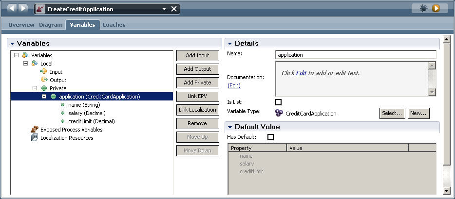

- Create the
CreditCardApplicationbusiness object with the following parameters:name(String)salary(Decimal)creditLimit(Decimal)
- Create the
CreateCreditApplicationheritage human service. - Add
application(CreditCardApplication)as a private variable.
