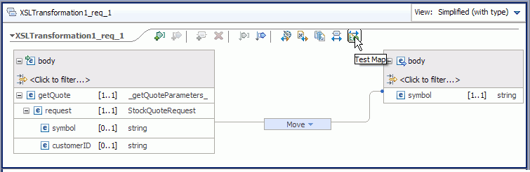

  2. Click Test Map.
    Show Test Map View button

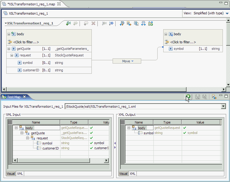

    The Test Map view opens with the sample input file on the left side. If you have more than one sample input file associated with the map you can select it from the Input Files list.
    Test Map View
  3. Add more transforms as needed.
  4. To update the output file, click Run Transformation. The result of running the sample input through the map will be shown on the right side of the Test Map view.
