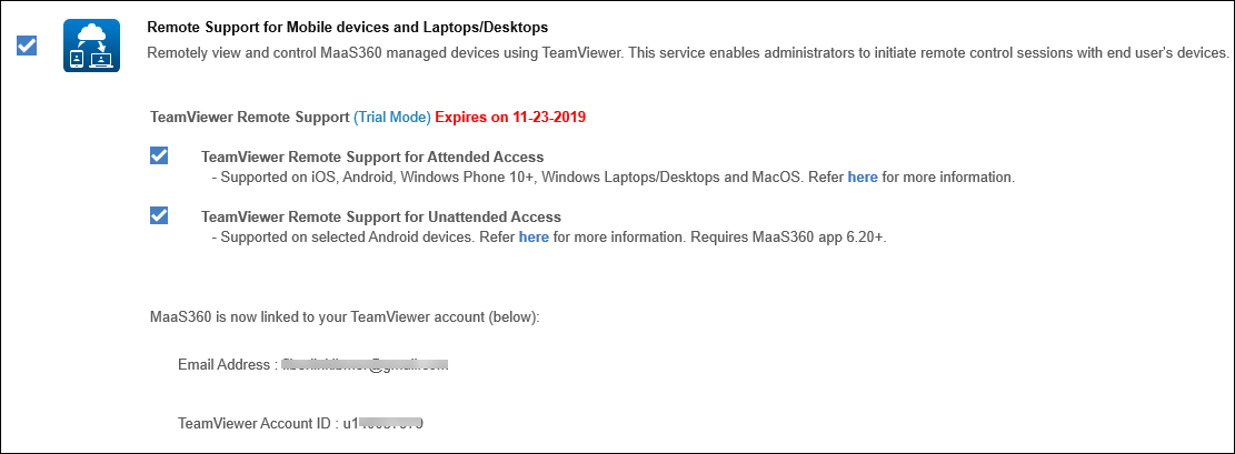

Enable Remote Support for Mobile devices and Laptops/Desktops.
The options TeamViewer Remote Support for Attended Access and TeamViewer Remote Support for Unattended Access are enabled by default.
Follow the on-screen instructions to start a 30-day TeamViewer free trial.

The TeamViewer trial account is created. Note: The trial account is valid for 30 days. To purchase a TeamViewer account, contact your MaaS360 account representative. - Go back to the Services page in the MaaS360 Portal, and enter the email address that you used for the TeamViewer registration in the Email Address field.
Click Authorize to allow MaaS360 to use your existing TeamViewer account for remote support.

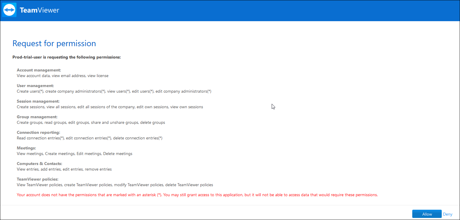

The TeamViewer portal opens in a new page.
Click Allow to grant the requested permissions.
