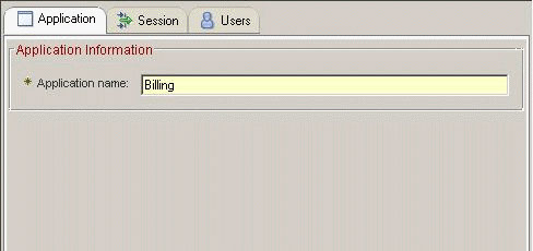

  4. Click OK. A configuration window is displayed, similar to the following example:
    Example of the tabbed window displayed in the AMC Editor for a selected application.
    The Application tab is displayed by default, and contains the name of the selected application. You can optionally type over this name in the Application name field to change it to another preferred name.
    The Session and Users tabs are used to configure user and session tracking to monitor transactions associated with specific users. See Monitoring unique users and sessions for Web Response Time for more information about configuring monitoring for user and session tracking.

  2. To modify an existing application, click the application name in the list. The tabbed window for the selected application is displayed, similar to the following example:
    The Application tab is displayed by default, and contains the name of the selected application. You can type over this name in the Application name field to change it to another preferred name.
