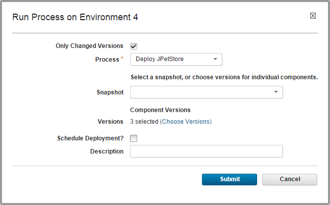

    The Run Process window shows the settings for the deployment, including how many component versions are selected for deployment, as shown in the following figure:
    The Run Process window, showing three component versions to deploy
  8. To run the process later, select the Schedule Deployment? check box, which is cleared by default.
    If you select this check box, fields are displayed that specify the date and time when the process runs. You can also configure the process to run on a recurring basis.
  9. To run the process, click Submit.
    The application process starts immediately unless it is scheduled for a later time.
