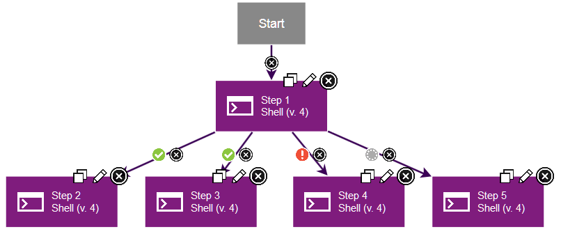

To branch a process and run multiple steps at the same time, add multiple outgoing connections from a step. You can use any combination of success, fail, and both conditional flags, as described in Conditional processes. For example, the following process shows a step that branches into four steps. Two connections have success flags. One has a fail flag, and one has a both flag.
In this case, if the first step finishes, three steps run at the same time: the connections with the success flags and the connection with the both flag. If the first step fails, two steps run at the same time: the connection with the fail flag and the connection with the both flag.

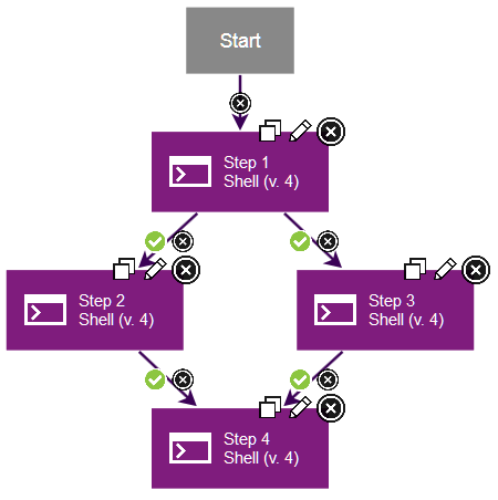

If a process has multiple steps that run at the same time, you can use connections to merge the process into a single step. For example, the following process shows two steps that are running at the same time. Both steps have a connection to a third step, and both of those connections have a success conditional flag. In this case, if either step 2 or step 3 fails, step 4 does not run. Because all the parallel processes that branch from step 1 have success flags, all the processes that merge at step 4 must succeed for step 4 to run.

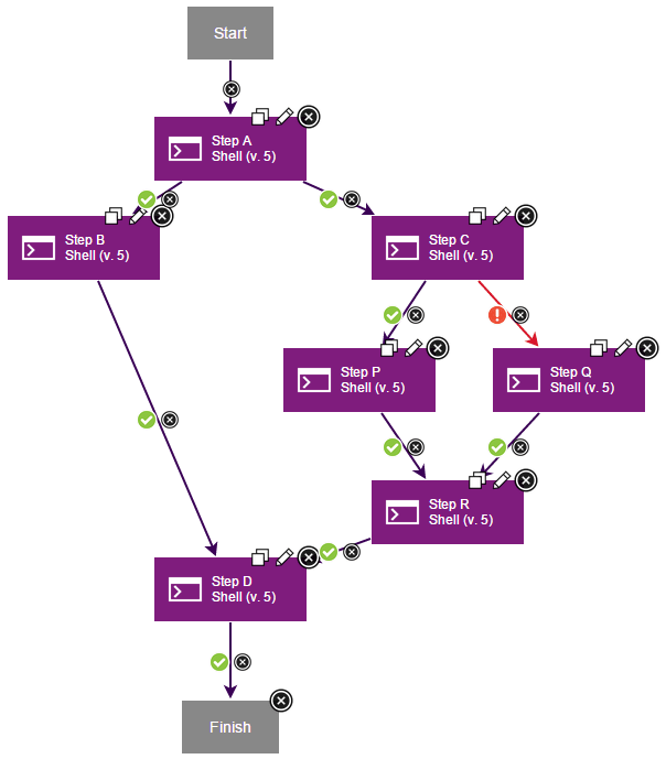

The following process adds a separate merging step to resolve the parallel paths that branch at step C. As in the previous example, either step P or step Q runs. Unlike the previous example, steps P and Q merge at step R, which follows the rules for its branching step and runs if either step P or Q succeeds. Step D still follows the branching rules for step A and runs only if all the processes that it merges succeed. If both step B and step R succeed, step D can run. By resolving each set of parallel paths separately, your process runs as planned.

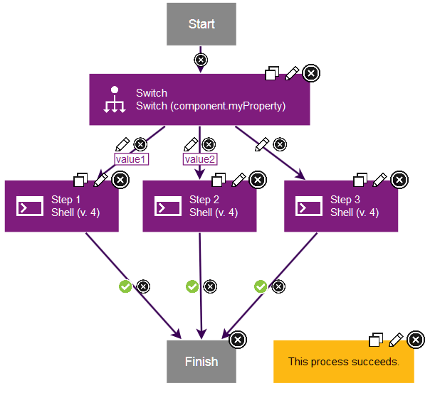

Use a Join step to explicitly indicate that all connections to the Join step must succeed. The Join step fails if any of the connections to it fail or do not run. For example, the following process uses a Switch step to branch the process. The Switch step has three outgoing connections, each for a different possible value of a property. Thus, only one of these outgoing connections runs. The three outgoing connections are merged at a Join step. The Join step always fails because only one of the outgoing connections runs. The two other step chains do not run, and therefore the Join step fails.
In these cases, when you do not intend for each step chain to run, do not use a Join step. Instead, merge the step chains by connecting the chains to a single step, as shown in the following process.
