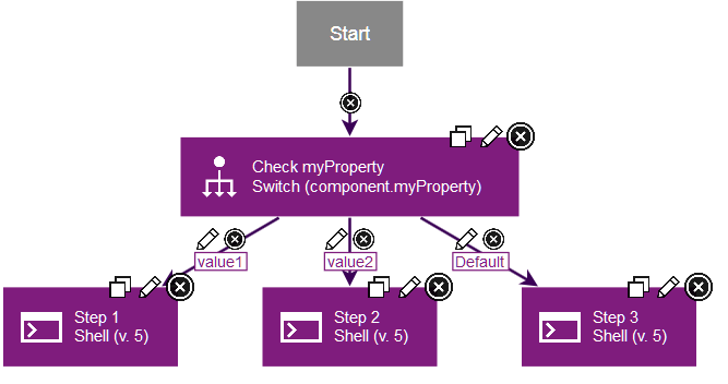

When you add a switch step, you specify a property, either as the property name itself or in the same form as you would use in other steps, such as ${p:propertyName}. Then, you add two or more outgoing connections from the step, each with a possible value for that property. At run time, the process follows the connection with the matching property value. The process also follows any connections with fail or both conditional flags.
For example, the following figure shows a switch step for the myProperty component property. Two outgoing connections have different values for that property, including value1 and value2. The third connection has the default value, which means that the process follows this connection if no other values are matched.
