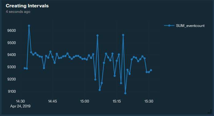

Creating intervals in a time series query
The first step is to decide the type of interval to use for your data analysis. Do you want to look at data from a narrow interval, such as every second? Or in larger intervals of every minute or every hour? This decision is important because data points must be grouped in intervals so that a metric is calculated.
- Using the GROUP BY clause to create an interval: GROUP BY starttime/60000. Because starttime is in displayed in milliseconds, if you divide by 60,000 (60 seconds x 1000 milliseconds), you create groups or intervals of 60 seconds (1 minute).
- Changing the ORDER BY clause to use the aggregate sTime.
select starttime as 'sTime',
SUM(eventcount) as 'Event Count (Sum)'
from events
where eventcount > 0
order by "sTime"
LAST 60 minutes

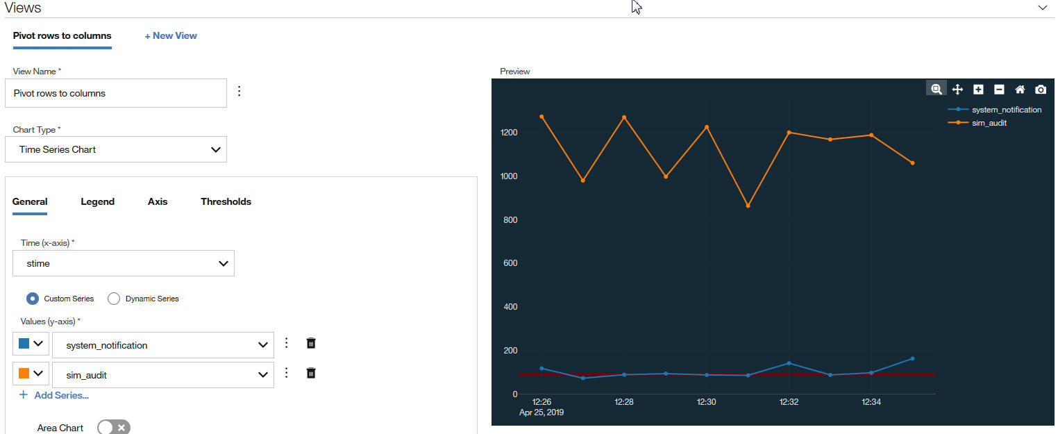

Pivoting rows to columns to create a series
SUM(IF LOGSOURCETYPENAME(devicetype) = 'System Notification' THEN 1.0 ELSE 0.0)
as system_notification
SUM(IF LOGSOURCETYPENAME(devicetype) = 'SIM Audit' THEN 1.0 ELSE 0.0) as sim_auditSELECT starttime/(1000*60) as 'minute',
(minute * (1000*60)) as 'stime',
as system_notification,
FROM events
WHERE devicetype <> NULL
GROUP BY minute
ORDER BY stime asc
LAST 10 minutes
While this method is fairly efficient to transform relational data into time series data, you must know ahead of time what data you're looking for.
