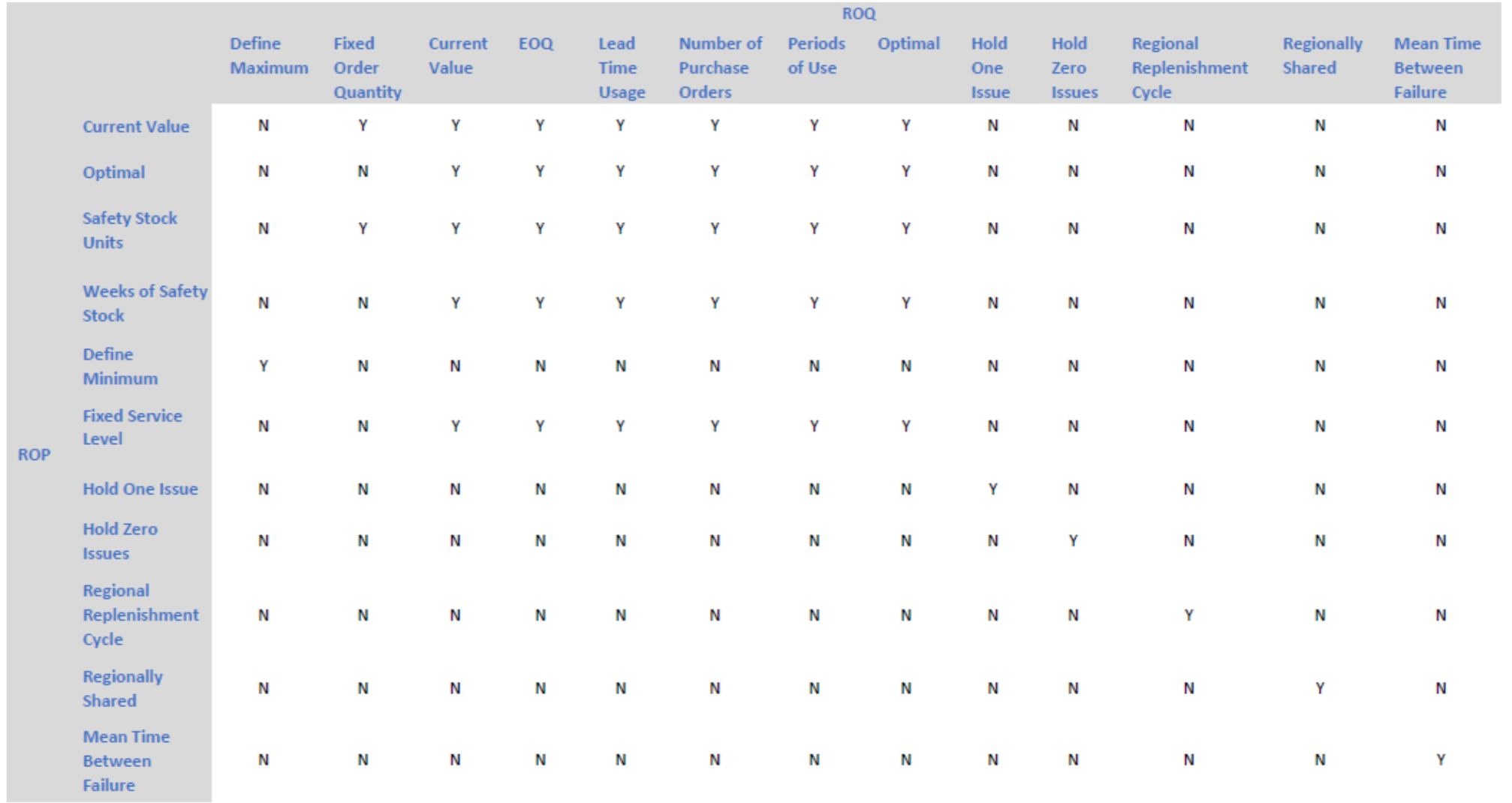

The table below shows all valid ROP / ROQ method combinations.
A table showing all valid ROP / ROQ method combinations
