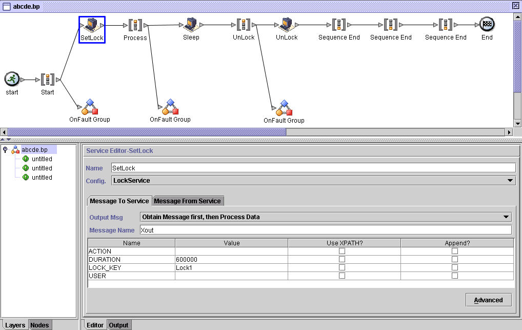

Business Process Example
The following example illustrates how the Lock service could be used in a business process.
In this business process, a lock is applied by the Lock service. The lock is set to a duration of 600,000 milliseconds, and uses “Lock1” as the lock key. In this business process, the resource being locked is an instance of the Sleep service. Note that the sleep interval (duration) is 45 seconds. The Sleep service is followed by a second instance of the Lock service that releases the lock, thereby freeing up this configuration of the Sleep service configuration for other processes.

</process>The following GPM screen shows the example business process graphically. Note that the instance of the Lock service called SetLock is selected and its properties are displayed in the Service Editor in the lower half of the screen:
