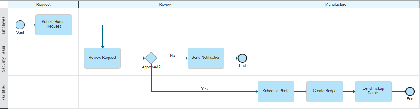

Add gateways for alternative flows
Gateways allow you to represent alternative paths through your process.
Required time: 10 minutes
In this example, the security team reviews the badge request to make sure that the employee has the required security clearance that is being requested. If the security team approves the request, the request is passed on to the Facilities team. If not, the security team notifies the employee that their request was rejected and the process ends. You can represent these alternative scenarios by using a gateway whose outgoing paths reflect the approved and rejected flows.
  1. Hover over the connection line between Review Request and the Schedule Photo activities, click the insert button insert button, and select Insert an Exclusive Gateway.
    Two outgoing paths are automatically generated with default labels Yes and No. These labels can be modified to represent different process scenarios.
  2. Gateways often represent a point in your process where some value or condition is evaluated, so they are often named in the form of a question and the names of outgoing paths represent the answer to that question. Change the gateway name by clicking the label and entering Approved?.
  3. When the security team does not approve the request, they send an email to the employee notifying them of the decision. Hover over the No path, click the insert button insert button, and select Insert an Activity. Name this activity Send Notification.
  4. The Send Notification activity is part of the reviewing phase of the process, so drag it back to the Review milestone along with the End event that completes the path.
Your diagram should now look similar to the following:

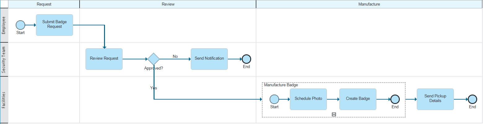

Group activities into a subprocess
Subprocesses allow you to group related activities and hide lower-level complexity in your process.
Required time: 5 minutes
In the Security Badge Request process, there are two activities that are related to manufacturing the security badge. For some stakeholders, it might be important to know the details about the activities involved in creating a badge, but for other stakeholders, it might be enough to know simply that there is a step in the process where badges are created, without knowing the substeps involved. You can use a subprocess to group related activities and that subprocess can be expanded or collapsed according to the level of detail that is required by reviewers and stakeholders.
  1. Select the Schedule Photo and Create Badge activities by using Ctrl+click. Right-click and select Convert to Subprocess.
    The two activities are put into a subprocess with a start event and an end event.
  2. Rename the subprocess by selecting the default name and entering Manufacture Badge.
Tip: You can expand and collapse your subprocess by using the + and - at the bottom of the subprocess activity.
Process diagram with subprocess

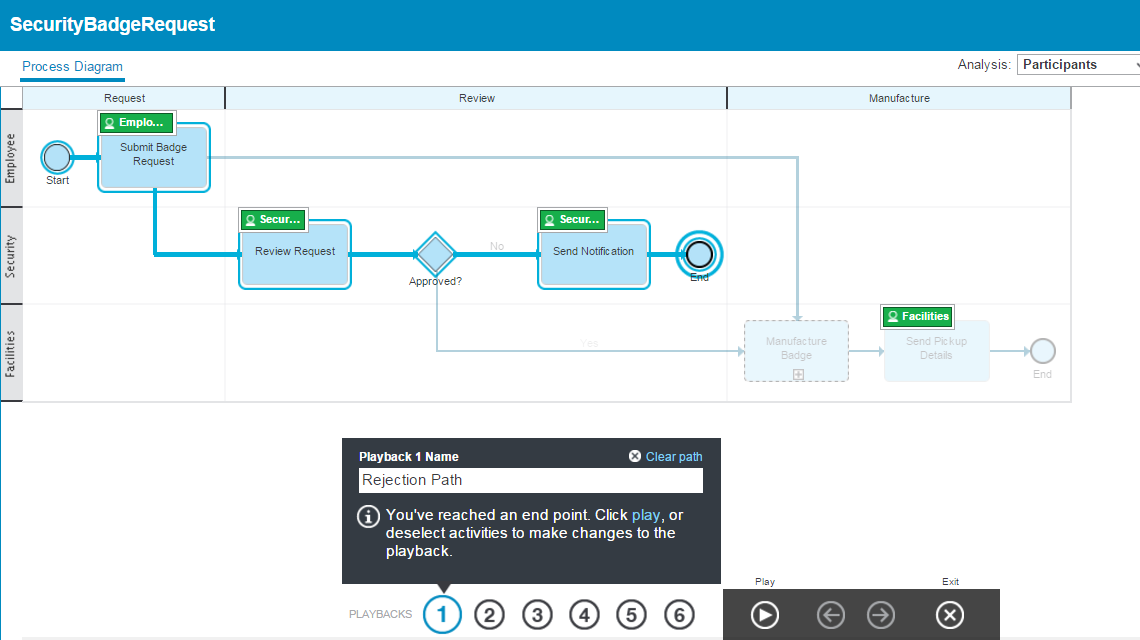

Process Playback is a way for you to step reviewers through the different paths of your process diagram, stopping at each step to examine the details and the comments that are associated with that step.
  1. Click Playback button to change to Playback mode.
  2. Specify a path through the process by selecting a set of connected elements. In this example, select Submit Badge Request, Review Request, Approved?, and Send Notification. Call this playback Rejection Path to distinguish it from other playback scenarios that follow alternative paths.
  3. Click Play to step through each activity in the playback that you just created.
    On the right side of the canvas, you can view the details, documentation, change history, and comments associated with each activity. Use the playback control buttons to move forward and back through the selected path.
  4. To exit playback mode, click Exit in the playback controls.
