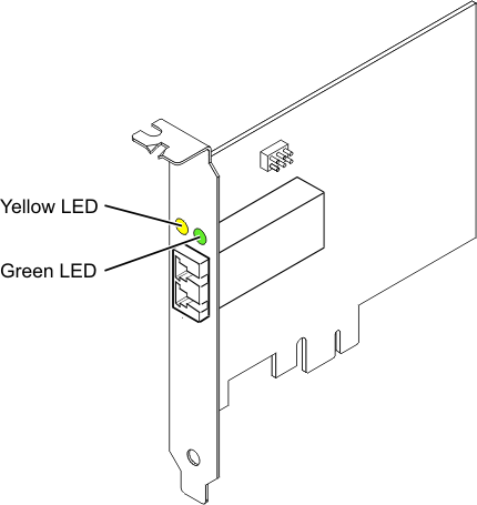

.Green and yellow LEDs can be seen through openings in the adapter's mounting bracket. Green indicates firmware operation and yellow signifies port activity. Table 1 summarizes normal LED states. There is a 1 Hz pause when the LED is off between each group of fast blinks (1, 2 or 3). Observe the LED sequence for several seconds to ensure that you correctly identify the state.
| Green LED | Yellow LED | State |
| On | 1 fast blink | 1 Gbps link rate - normal, link active |
| On | 2 fast blinks | 2 Gbps link rate - normal, link active |
| On | 3 fast blinks | 4 Gbps link rate - normal, link active |
