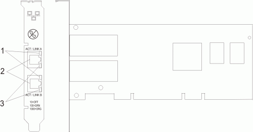

| LED | Light | Description |
| Link Speed | Off | 10 Mbps |
| Green | 100 Mbps | |
| Orange | 1000 Mbps | |
| Link | Green | Good link |
| Off | No link: could indicate a bad cable, bad connector, configuration mismatch, or not selected | |
| Blinking | Indicates data activity |
The following figure shows the adapter LEDs and RJ-45 connector.
