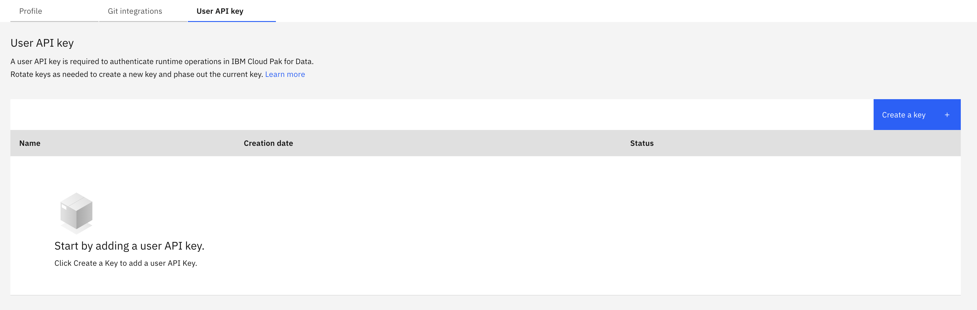

  2. Click the User API key tab. If you have a key, it is displayed. If you don't have a key, you can create one.
Creating task credentials from the UI
To create new task credentials:
From the User API key tab of your profile, click Create a key:
Create API key
Your new API key appears in the key list.
