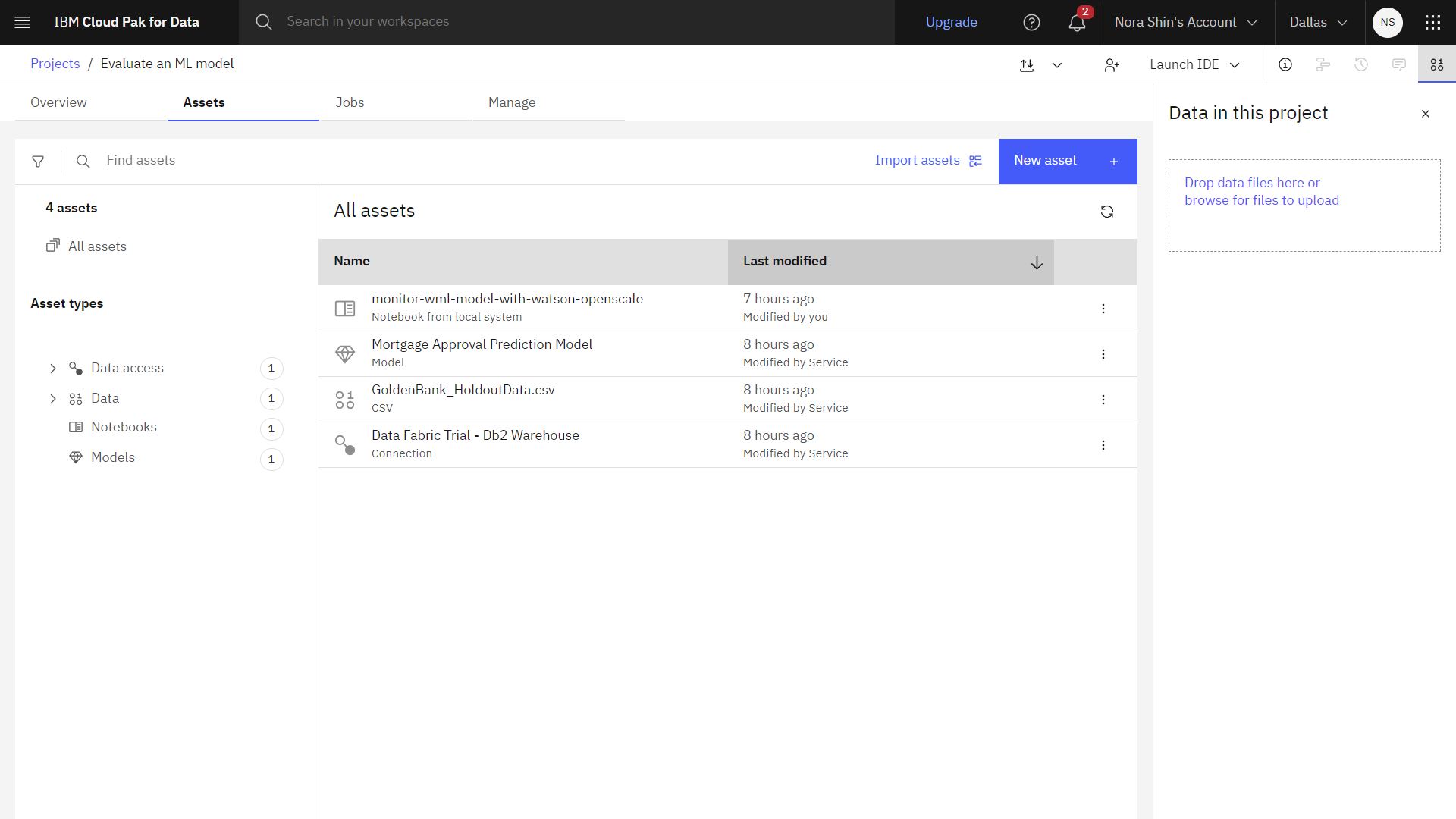

Task 1: Create the sample project
preview tutorial video To preview this task, watch the video beginning at 00:06.
This tutorial uses a sample project containing a machine learning model and a notebook to configure the monitors. Follow these steps to create a project based on a sample.
  1. Access the Evaluate an ML model sample project in the Resource hub.
  2. Click Create project.
  3. If prompted to associate the project to a Cloud Object Storage instance, select a Cloud Object Storage instance from the list.
  4. Click Create.
  5. Wait for the project import to complete, and then click View new project to verify that the project and assets were created successfully.
  6. Click the Assets tab to view the assets in the sample project.
Checkpoint icon Check your progress
The following image shows the sample project. You are now ready to start the tutorial.
Sample project

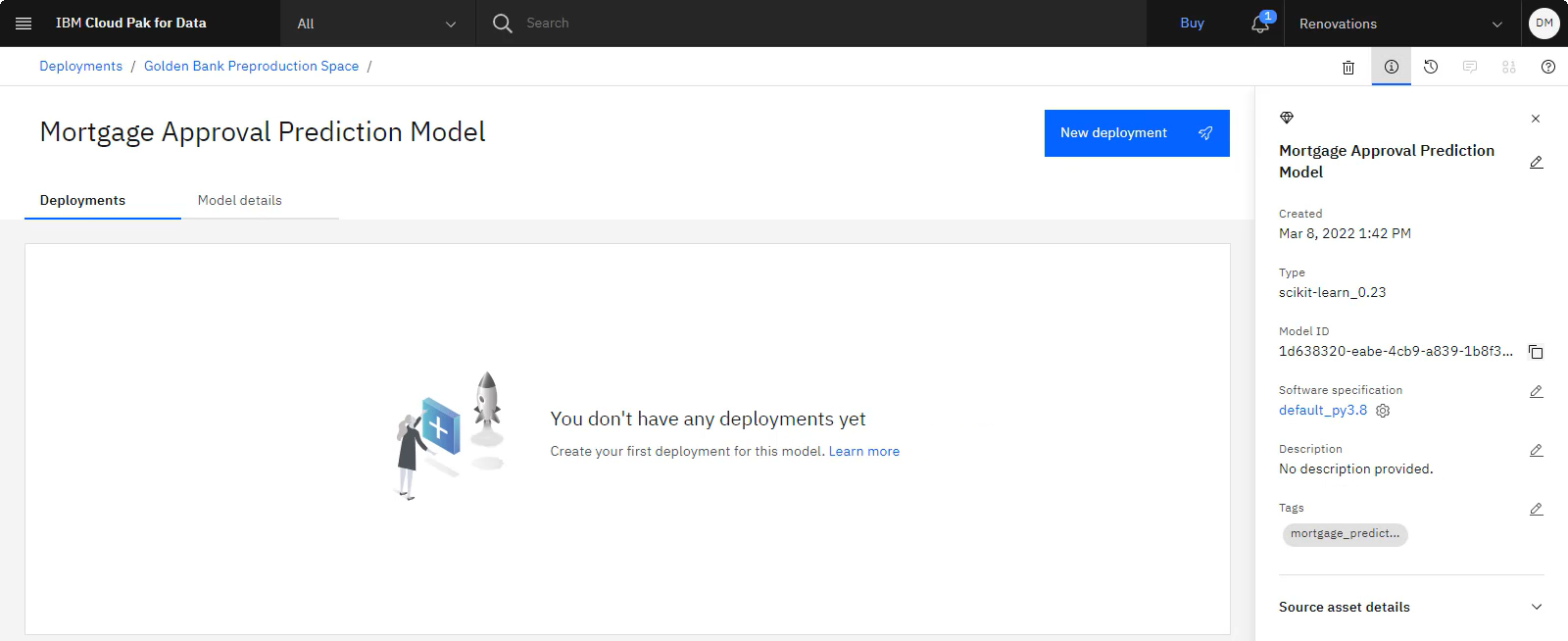

Task 2: Deploy the model
Before you can deploy the model, you need to promote the model to a new deployment space. Deployment spaces help you to organize supporting resources such as input data and environments; deploy models or functions to generate predictions or solutions; and view or edit deployment details.
Task 2a: Promote the model to a deployment space
preview tutorial video To preview this task, watch the video beginning at 00:49.
Follow these steps to promote the model to a new deployment space:
  1. From the Assets tab, click Mortgage Approval Prediction Model to view the model.
  2. On the model page, click the Promote to deployment space icon Promote to deployment space.
  3. For the Target space, select Create a new deployment space.
    1. For the deployment space name, copy and paste the name exactly as shown with no leading or trailing spaces: Golden Bank Preproduction Space
    2. Select a storage service from the list.
    3. Select your provisioned machine learning service from the list.
    4. Click Create.
    5. Click Close.
  4. For the Target space, ensure that Golden Bank Preproduction Space is selected.
  5. Check the Go to model in the space after promoting it option.
  6. Click Promote.
The following image shows the model in the deployment space. You are now ready to create a model deployment.
Model in deployment space

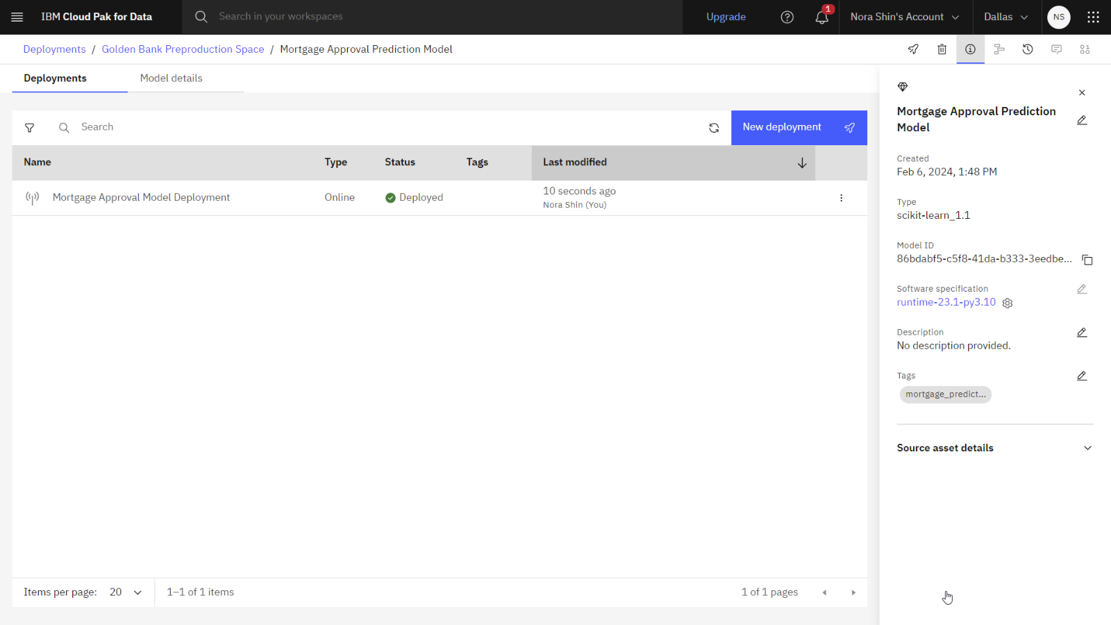

Task 2b: Create an online deployment for the model
preview tutorial video To preview this task, watch the video beginning at 01:30.
Follow these steps to create an online deployment for your model:
  1. When the deployment space opens, click New deployment.
    1. For the Deployment type, select Online.
    2. For the Name, copy and paste the deployment name exactly as shown with no leading or trailing spaces: Mortgage Approval Model Deployment
    3. Click Create.
  2. Wait for the model deployment to complete. When the model is deployed successfully, view the deployment to see the scoring endpoint, and, optionally, test the model.
The following image shows the model deployment. You are now ready to run the notebook to configure the monitors.
Model deployment

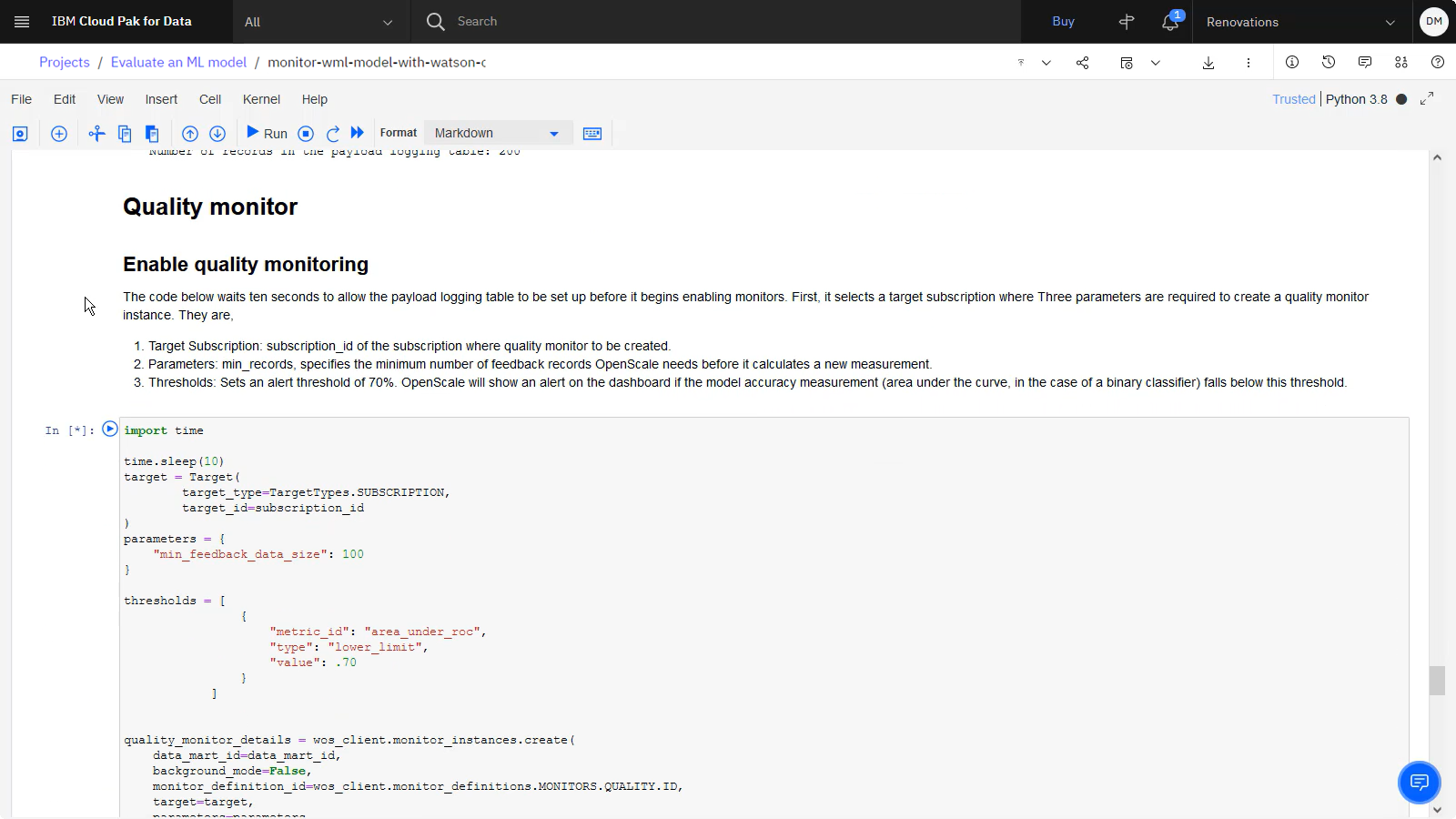

Task 3: Run the notebook to set up the monitors
preview tutorial video To preview this task, watch the video beginning at 01:55.
Run the notebook included in the sample project to:
  • Fetch the model and deployments.
  • Configure Watson OpenScale.
  • Create the service provider and subscription for your machine learning service.
  • Configure the quality monitor.
  • Configure the fairness monitor.
  • Configure explainability.
Follow these steps to run the notebook included in the sample project. This notebook sets up monitors for your model, which can also be configured through the user interface. However, it is quicker and less error prone to set them up with a notebook. Take some time to read through the comments in the notebook, which explain the code in each cell.

  4. Open the monitor-wml-model-with-watson-openscale notebook.
  5. Because the notebook is in read-only mode, click the Edit icon Edit to place the notebook in edit mode.
  6. Look at the first cell of this notebook. If you imported the notebook from a project, it contains the project access token.
    If the notebook does not contain a project access token in the first cell, generate one. To generate the token, from the More menu, select Insert project token. This action inserts a new cell as the first cell in the notebook containing the project token.
  7. Under the Provide your IBM Cloud API key section, you need to pass your credentials to the watsonx.ai Runtime API using an API key. If you don't already have a saved API key, follow these steps to create an API key.
    1. Access the IBM Cloud console API keys page.
    2. Click Create an IBM Cloud API key. If you have any existing API keys, the button may be labelled Create.
    3. Type a name and description.
    4. Click Create.
    5. Copy the API key.
    6. Download the API key for future use.
    7. Return to the notebook, and paste your API key in the ibmcloud_api_key field.
  8. In the 3. Model and Deployment section, verify the values assigned to the space_name, model_name, and deployment_name variables.
  9. Click Cell > Run All to run all of the cells in the notebook. Alternatively, click the Run icon Run next to each cell to run the notebook cell-by-cell to explore each cell and its output.
  10. The notebook takes 1 - 3 minutes to complete. You can monitor the progress cell by cell by noticing the asterisk "In [*]" changing to a number, for example, "In [1]".

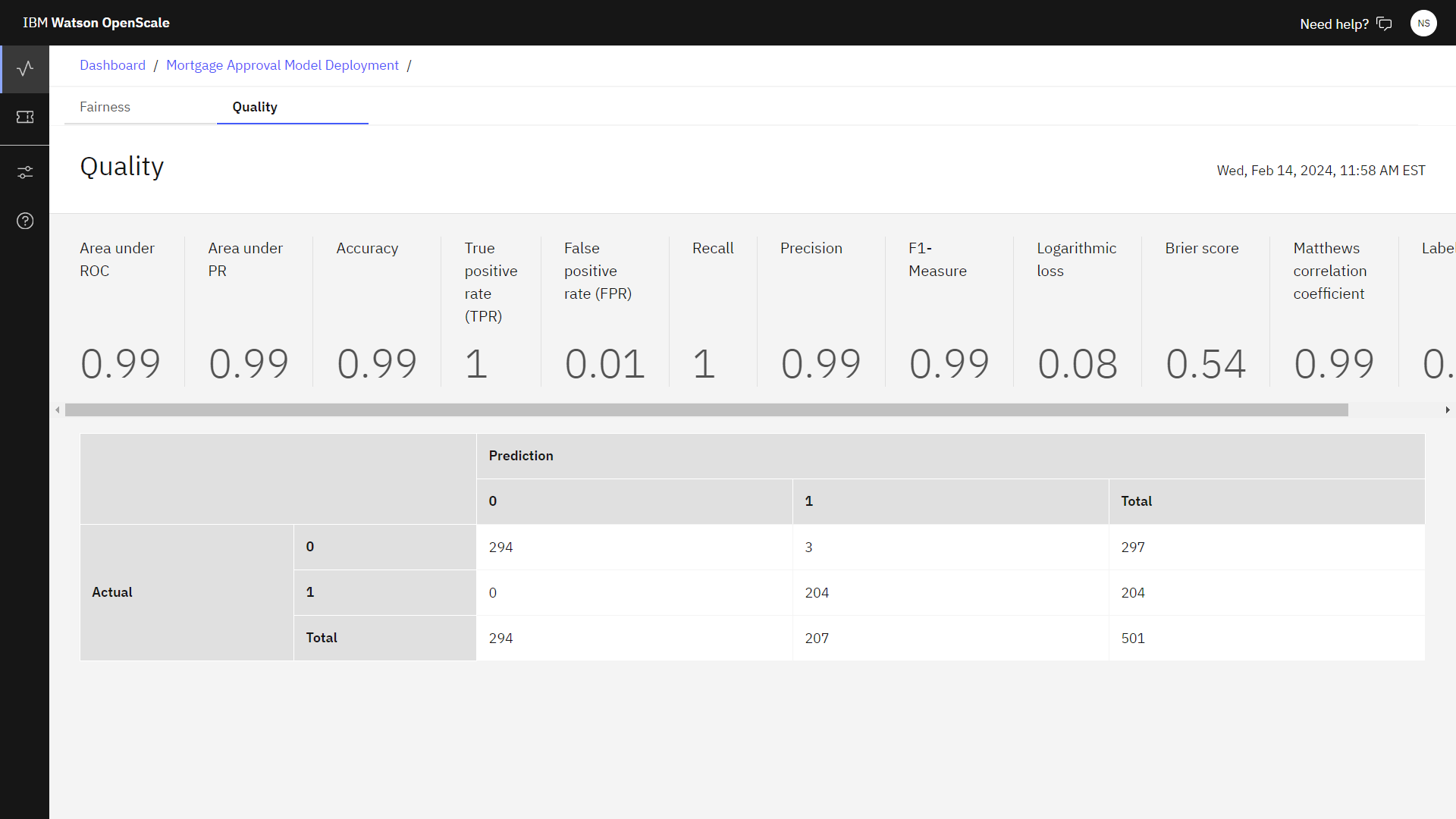

The Watson OpenScale quality monitor generates a set of metrics to evaluate the quality of your model. You can use these quality metrics to determine how well your model predicts outcomes. When the evaluation that uses the holdout data completes, follow these steps to observe the model quality or accuracy:
  1. In the Quality section, click the Configure icon Configure. Here you can see that the quality threshold that is configured for this monitor is 70% and that the measurement of quality being used is area under the ROC curve.
  2. Click Go to model summary to return to the model details screen.
  3. In the Quality section, click the Details icon Details to see the model quality detailed results. Here you see a number of quality metric calculations and a confusion matrix showing correct model decisions along with false positives and false negatives. The calculated area under the ROC curve is 0.9 or higher, which exceeds the 0.7 threshold, so the model is meeting its quality requirement.
  4. Click Mortgage Approval Model Deployment in the navigation trail to return to the model details screen.
The following image shows the quality details in Watson OpenScale. Now that you observed the model quality, you can observe the model fairness.
Quality

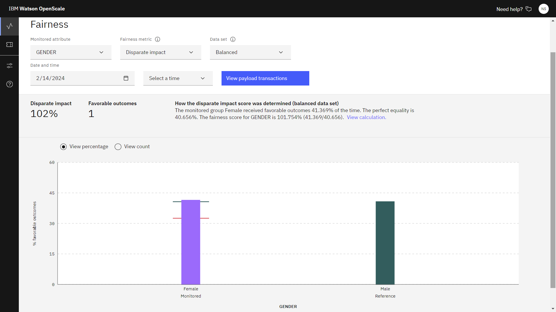

Task 6: Observe the model monitors for fairness
preview tutorial video To preview this task, watch the video beginning at 05:41.
The Watson OpenScale fairness monitor generates a set of metrics to evaluate the fairness of your model. You can use the fairness metrics to determine if your model produces biased outcomes. Follow these steps to observe the model fairness:
  1. In the Fairness section, click the Configure icon Configure. Here you see that the model is being reviewed to ensure that applicants are being treated fairly regardless of their gender. Women are identified as the monitored group for whom fairness is being measured and the threshold for fairness is to be at least 80%. The fairness monitor uses the disparate impact method to determine fairness. Disparate impact compares the percentage of favorable outcomes for a monitored group to the percentage of favorable outcomes for a reference group.
  3. In the Fairness section, click the Details icon Details to see the model fairness detailed results. Here you see the percentage of male and female applicants who are being automatically approved, along with a fairness score of over 100%, so the model performance far exceeds the 80% fairness threshold required.
  4. Note the identified data sets. To ensure that the fairness metrics are most accurate, Watson OpenScale uses perturbation to determine the results where only the protected attributes and related model inputs are changed while other features remain the same. The perturbation changes the values of the feature from the reference group to the monitored group, or vice-versa. These additional guardrails are used to calculate fairness when the "balanced" data set is used, but you can also view the fairness results using only payload or model training data. Because the model is behaving fairly, you don't need to go into additional detail for this metric.
    Fairness data sets
  5. Click the Mortgage Approval Model Deployment navigation trail to return to the model details screen.
The following image shows the fairness details in Watson OpenScale. Now that you observed the model fairness, you can observe the model explainability.
Fairness

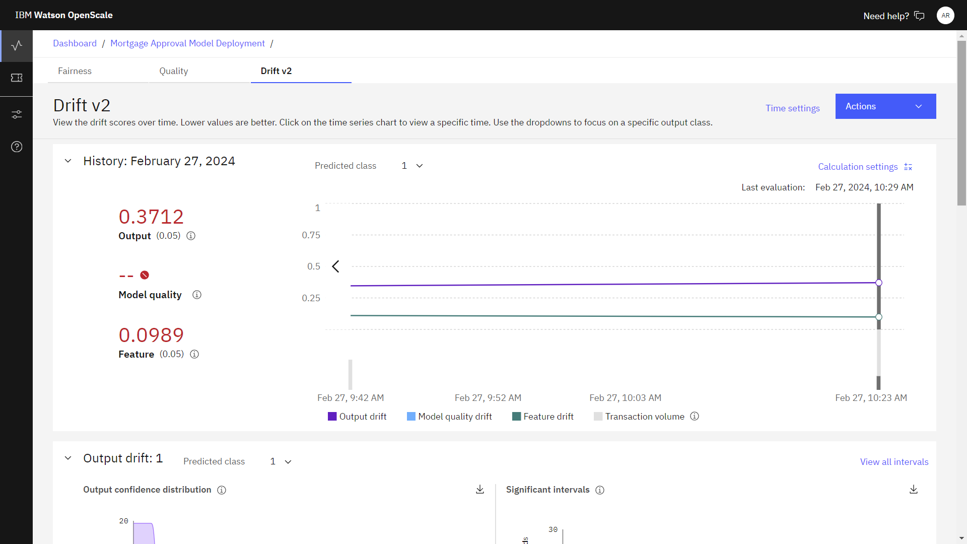

Task 7: Observe the model monitors for drift
preview tutorial video To preview this task, watch the video beginning at 07:25.
The Watson OpenScale drift monitor measures changes in your data over time to ensure consistent outcomes for your model. Use drift evaluations to identify changes in your model output, the accuracy of your predictions, and the distribution of your input data. Follow these steps to observe the model drift:
  1. In the Drift section, click the Configure icon Configure. Here you see the drift thresholds. Output drift measures the change in the model confidence distribution. Model quality drift measures the drop in accuracy by comparing the estimated runtime accuracy to the training accuracy. Feature drift measures the change in value distribution for important features. The configuration also shows the number of selected features and the most important features.
  3. In the Drift section, click the Details icon Details to see the model drift detailed results. You can view the history of how each metric score changes over time with a time series chart. Lower values are better, so in this case, the results are above the upper thresholds that are set in the configuration. Then view details about how the scores output and feature drifts are calculated. You can also view details about each feature to understand how they contribute to the scores that Watson OpenScale generates.
  4. Click the Mortgage Approval Model Deployment navigation trail to return to the model details screen.
The following image shows the drift details in Watson OpenScale. Now that you observed the model drift, you can observe the model explainability.
Drift

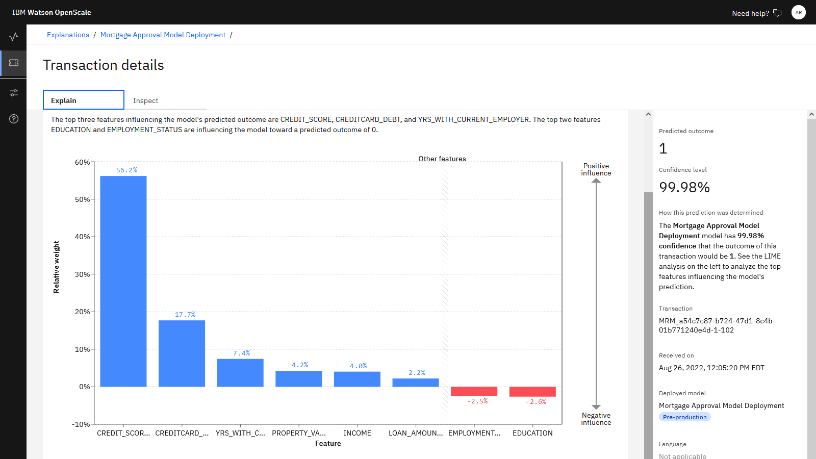

Task 8: Observe the model monitors for explainability
preview tutorial video To preview this task, watch the video beginning at 08:46.
It is also important to understand how the model came to its decision. This understanding is required both to explain decisions to people involved in the loan approval and to assure the model's owner that the decisions are valid. To understand these decisions, follow these steps to observe the model explainability:
  1. In the left navigation panel, click the Explain a transaction icon Explain a transaction.
  2. Select Mortgage Approval Model Deployment to see a list of transactions.
  3. For any transaction, click Explain under the Actions column. Here you see the detailed explanation of this decision. You can see the most important inputs to the model along with how important each was to the end result. Blue bars represent inputs that tended to support the model's decision while red bars show inputs that might have led to another decision. For example, an applicant might have enough income to otherwise be approved but their poor credit history and high debt together lead the model to reject the application. Review this explanation to satisfy yourself about the basis for the model decision.
  4. (Optional) If you want to delve further into how the model made its decision, click the Inspect tab. Use the Inspect feature to analyze the decision to find areas of sensitivity where a small change to a few inputs would result in a different decision, and you can test the sensitivity yourself by overriding some of the actual inputs with alternatives to see whether these would impact the result.
The following image shows the explainability of a transaction in Watson OpenScale. You have determined that the model is accurate and treating all applicants fairly. Now, you can advance the model to the next phase in its lifecycle.
Explainability
