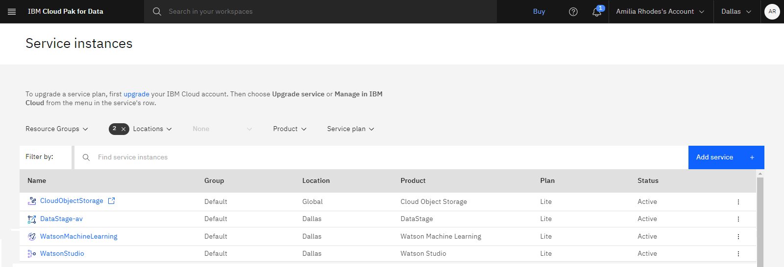

Verify the necessary provisioned services
preview tutorial video To preview this task, watch the video beginning at 00:37.
Follow these steps to verify or provision the necessary services:
  1. From the Navigation Menu Navigation menu, choose Services > Service instances.
  2. Use the Product drop-down list to determine whether an existing watsonx.ai Studio service instance exists.
  3. If you need to create a watsonx.ai Studio service instance, click Add service.
    1. Select watsonx.ai Studio.
    2. Select the Lite plan.
    3. Click Create.
  4. Wait while the watsonx.ai Studio service is provisioned, which might take a few minutes to complete.
  5. Repeat these steps to verify or provision the following additional services:
    • watsonx.ai Runtime
    • DataStage
    • Cloud Object Storage
Checkpoint icon Check your progress
The following image shows the provisioned service instances:
Provisioned services

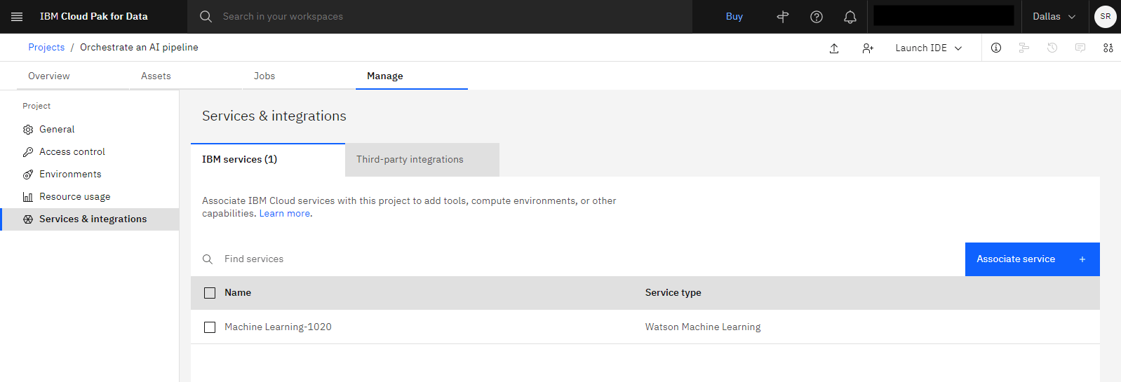

Associate the watsonx.ai Runtime service with the sample project
preview tutorial video To preview this task, watch the video beginning at 02:04.
You will use watsonx.ai Runtime to create and deploy the model, so follow these steps to associate your watsonx.ai Runtime service instance with the sample project.
  1. In the Orchestrate an AI pipeline project, click the Manage tab.
  2. Click the Services and Integrations page.
  3. Click Associate service.
  4. Check the box next to your watsonx.ai Runtime service instance.
  5. Click Associate.
  6. Click Cancel to return to the Services & Integrations page.
The following image shows the Services and Integrations page with the watsonx.ai Runtime service listed. You are now ready to create the sample project.
Associate service with project

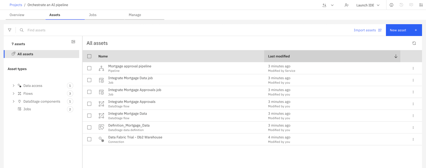

The sample project includes several assets including a connection, data definition, two DataStage flows, and a pipeline. Follow these steps to view those assets:
  1. Click the Assets tab in the Orchestrate an AI pipeline project, and then view All assets.
  2. All of the data assets that are used in the DataStage flows and the pipeline are stored in a Data Fabric Trial - Db2 Warehouse connection in the AI_MORTGAGE schema. The following image shows the assets from that connection:

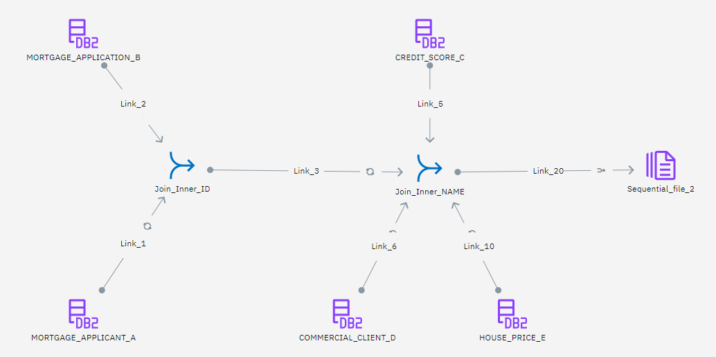

  3. The Integrate Mortgage Data DataStage flow integrates data about each mortgage applicant, including personally identifiable information, with their application details, credit scores, status as a commercial buyer, and finally the prices of each applicant’s chosen home, and then creates a sequential file with the name Mortgage_Data.csv in the project containing the joined data. The following image shows the Integrate Mortgage Data DataStage flow.
    Tip: If you don't see any DataStage flows, then go back to view your service instances to verify your DataStage instance provisioned successfully. See Provision the necessary services.
    Integrate Mortgage Data flow

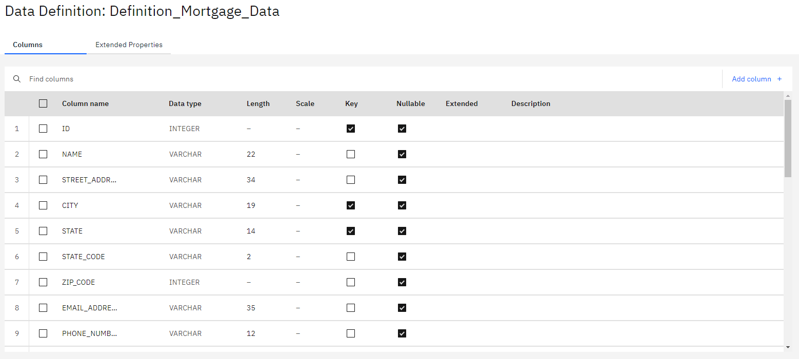

  5. The Definition_Mortgage_Data data definition for the Mortgage_Data_with_Approvals.csv data asset is created by the Integrate Mortgage Approvals DataStage flow. The following image shows the data definition:
    Definition Mortgage Data

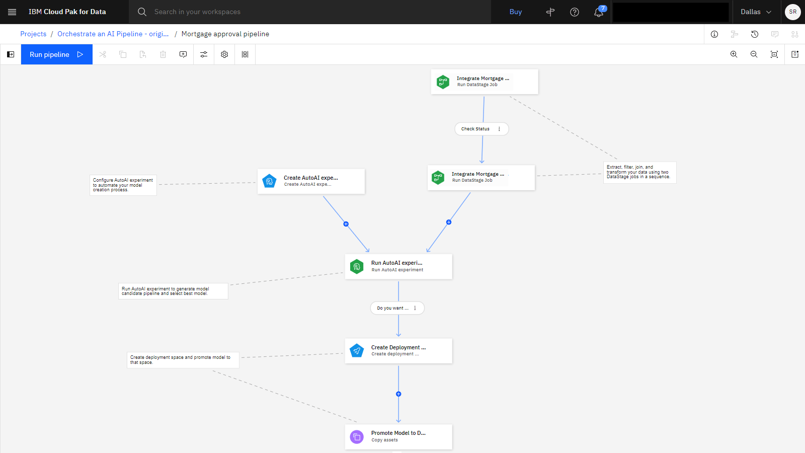

Task 2: Explore an existing pipeline
preview tutorial video To preview this task, watch the video beginning at 04:00.
The sample project includes an Orchestration Pipelines, which automates the following tasks:
  • Run two existing DataStage jobs.
  • Create an AutoAI experiment.
  • Run the AutoAI experiment and save the best performing model that uses the resulting output file from the DataStage job as the training data.
  • Create a deployment space.
  • Promote the saved model to the deployment space.
Follow these steps to explore the pipeline:
  1. From the Assets tab in the Orchestrate an AI pipeline project, view All assets.
  2. Click Mortgage approval pipeline to open the pipeline.
  3. In the beginning section of the pipeline, two DataStage jobs (Integrate Mortgage Data and Integrate Mortgage Approvals) run in sequence to combine various tables from the Db2 Warehouse on Cloud connection into a cohesive labeled data set that is used as the training data for the AutoAI experiment.
  4. Double-click the Check Status node to see the condition. This condition is a decision point in the pipeline to confirm the completion of the first DataStage job with a value of either Completed or Completed With Warnings. Click Cancel to return to the pipeline.
  5. Double-click the Create AutoAI experiment node to see the settings. This node creates an AutoAI experiment with the settings.
    1. Review the values for the following settings:
      • AutoAI experiment name
      • Scope
      • Prediction type
      • Prediction column
      • Positive class
      • Training data split ratio
      • Algorithms to include
      • Algorithms to use
      • Optimize metric
    2. Click Cancel to close the settings.
  6. Double-click the Run AutoAI experiment node to see the settings. This node runs the AutoAI experiment that is created from the Create AutoAI experiment node that uses the output from the Integrate Mortgage Approval DataStage job as the training data.
      • AutoAI experiment
      • Training Data Assets
      • Model name prefix
  7. Between the Run AutoAI experiment and Create Deployment Space nodes, double-click the Do you want to deploy model? node to see the condition. The value of True for this condition is a decision point in the pipeline to continue to create the deployment space. Click Cancel to return to the pipeline.
  8. Double-click the Create Deployment Space node to see the settings. This node creates a new deployment space with the specified name, and requires input for your Cloud Object Storage and watsonx.ai Runtime services.
    1. Review the value for the New space name setting.
    2. For the New space COS Instance CRN field, select your Cloud Object Storage instance from the list.
    3. For the New space WML Instance CRN field, select your watsonx.ai Runtime instance from the list.
    4. Click Save.
  9. Double-click the Promote Model to Deployment Space node to see the settings. This node promotes the best model from the Run AutoAI experiment node to the deployment space created from the Create Deployment Space node.
      • Source Assets
      • Target
The following image shows the initial pipeline. You are now ready to edit the pipeline to add a node.
Initial pipeline

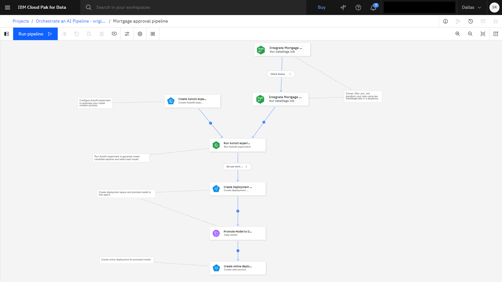

Task 3: Add a node to the pipeline
preview tutorial video To preview this task, watch the video beginning at 06:23.
The pipeline creates the model, creates a deployment space, and then promotes it to a deployment space. You need to add a node to create an online deployment. Follow these steps to edit the pipeline to automate creating an online deployment:

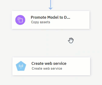

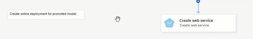

  1. Add the Create Online Deployment node to the canvas:
    1. Expand the Create section in the node palette.
    2. Drag the Create online deployment node onto the canvas, and drop the node after the Promote Model to Deployment Space node.
  2. Hover over the Promote Model to Deployment Space node to see the arrow. Connect the arrow to the Create online deployment node.
    Note: The node names in your pipeline might differ from the following animated image.
    Pipeline connect nodes
  3. Connect the Create online deployment for promoted model comment to the Create online deployment node by connecting the circle on the comment box to the node.
    Pipeline comment
  4. Double-click the Create online deployment node to see the settings.
  5. Change the node name to Create Online Deployment.
  6. Next to ML asset, click Select from another node from the menu.
    Select from another node ML asset
  7. Select the Promote Model to Deployment Space node from the list. The node ID winning_model is selected.
  8. For the New deployment name, type mortgage approval model deployment.
  9. For Creation Mode, select Overwrite.
  10. Click Save to save the Create Online Deployment node settings.
The following image shows the completed pipeline. You are now ready to run the pipeline.
Completed pipeline

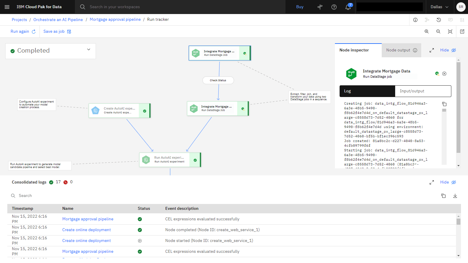

  1. From the toolbar, click Run pipeline > Trial run.
  2. On the Define pipeline parameters page, select True for the deployment.
    • If set to True, then the pipeline verifies the deployed model and scores the model.
    • If set to False, then the pipeline verifies that the model was created in the project by the AutoAI experiment, and reviews the model information and training metrics.
  3. If this occasion is your first time running a pipeline, you are prompted to provide an API key. Pipeline assets use your personal IBM Cloud API key to run operations securely without disruption.
    • If you have an existing API key, click Use existing API key, paste the API key, and click Save.
    • If you don't have an existing API key, click Generate new API key, provide a name, and click Save. Copy the API key, and then save the API key for future use. When you're done, click Close.
  4. Click Run to start running the pipeline.
  5. Scroll through consolidated logs while the pipeline is running. The trial run might take up to 10 minutes to complete.
  6. As each operation completes, select the node for that operation on the canvas.
  7. On the Node Inspector tab, view the details of the operation.
  8. Click the Node output tab to see a summary of the output for each node operation.

The following image shows the pipeline after it completed the trial run. You are now ready to review the assets that the pipeline created.
Completed run of pipeline

The pipeline created several assets. Follow these steps to view the assets:
  1. Click the Orchestrate an AI pipeline project name in the navigation trail to return to the project.
    Navigation trail
  2. On the Assets tab, view All assets.
  3. View the data assets.
    1. Click the Mortgage_Data.csv data asset. The DataStage job created this asset.
    2. Click the project name in the navigation trail to return to the Assets tab.
    3. Click the Mortgage_Data_with_Approvals.csv data asset. The DataStage job created this asset.
    4. Click the project name in the navigation trail to return to the Assets tab.
  4. View the model.
    1. Click the machine learning model asset beginning with mortgage_approval_best_model. The AutoAI experiment generated several model candidates, and chose this as the best model.
    2. Scroll through the model information.
    3. Click the project name in the navigation trail to return to the Assets tab.
  5. Click the Jobs tab in the project to see information about the two DataStage jobs and one Pipeline job runs.
  6. From the Navigation Menu Navigation menu, choose Deployments.
  7. Click the Spaces tab.
  8. Click the Mortgage approval deployment space.
  9. Click the Assets tab, and see the deployed model beginning with mortgage_approval_best_model.
  10. Click the Deployments tab.
  11. Click mortgage approval model deployment to view the deployment.

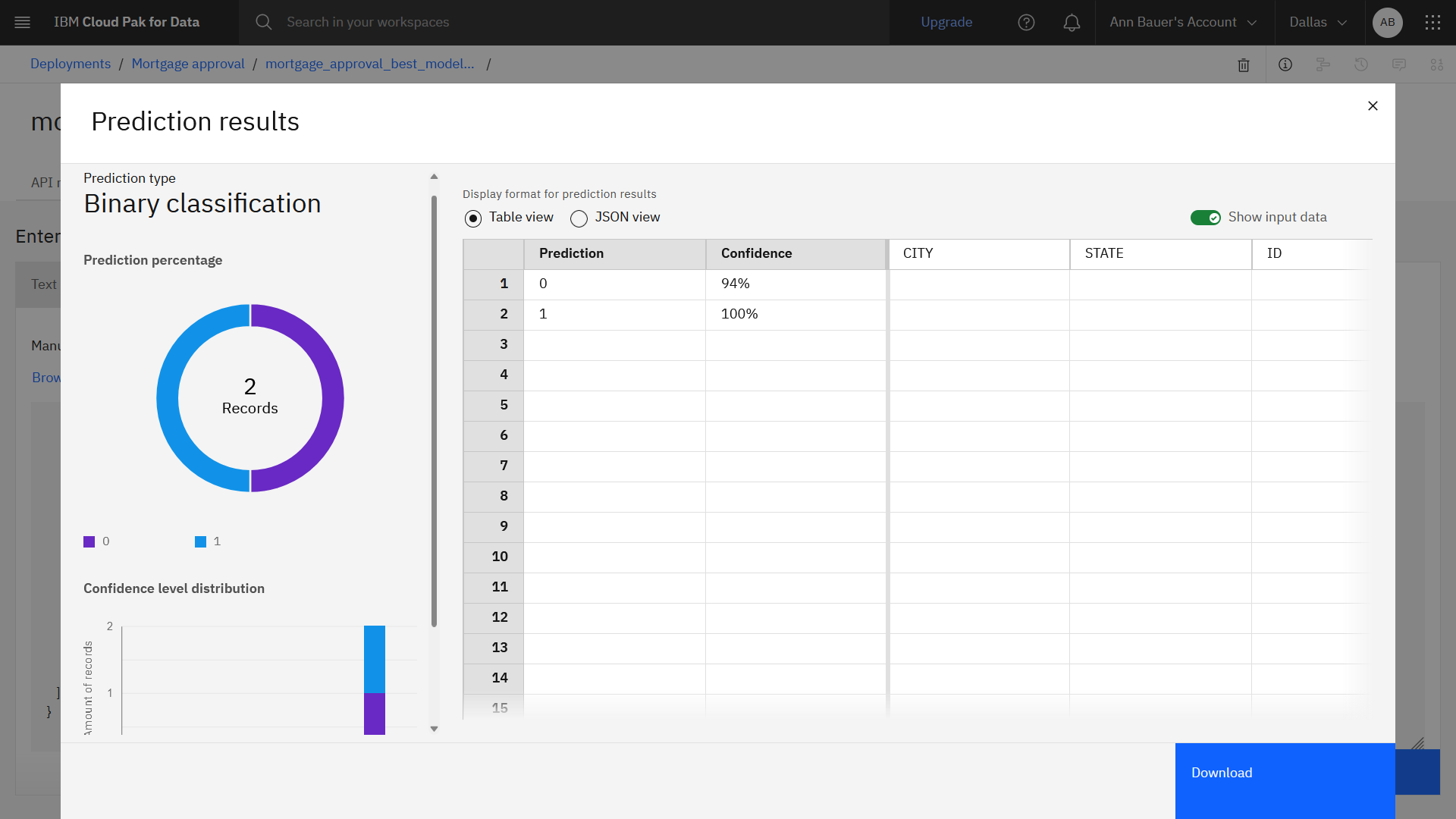

    1. View the information on the API reference tab.
    2. Click the Test tab.
    3. Click the JSON input tab, and replace the sample text with the following JSON text.
         "input_data": [
                     "fields": [
                             "ID",
                             "NAME",
                             "STREET_ADDRESS",
                             "CITY",
                             "STATE",
                             "STATE_CODE",
                             "ZIP_CODE",
                             "EMAIL_ADDRESS",
                             "PHONE_NUMBER",
                             "GENDER",
                             "SOCIAL_SECURITY_NUMBER",
                             "EDUCATION",
                             "EMPLOYMENT_STATUS",
                             "MARITAL_STATUS",
                             "INCOME",
                             "APPLIEDONLINE",
                             "RESIDENCE",
                             "YRS_AT_CURRENT_ADDRESS",
                             "YRS_WITH_CURRENT_EMPLOYER",
                             "NUMBER_OF_CARDS",
                             "CREDITCARD_DEBT",
                             "LOANS",
                             "LOAN_AMOUNT",
                             "CREDIT_SCORE",
                             "CRM_ID",
                             "COMMERCIAL_CLIENT",
                             "COMM_FRAUD_INV",
                             "FORM_ID",
                             "PROPERTY_CITY",
                             "PROPERTY_STATE",
                             "PROPERTY_VALUE",
                             "AVG_PRICE"
                     "values": [
                                     null,
                                     null,
                                     null,
                                     null,
                                     null,
                                     null,
                                     null,
                                     null,
                                     null,
                                     null,
                                     null,
                                     "Bachelor",
                                     "Employed",
                                     null,
                                     144306,
                                     null,
                                     "Owner Occupier",
                                     15,
                                     19,
                                     2,
                                     7995,
                                     1,
                                     1483220,
                                     437,
                                     null,
                                     false,
                                     false,
                                     null,
                                     null,
                                     null,
                                     111563
                                     null,
                                     null,
                                     null,
                                     null,
                                     null,
                                     null,
                                     null,
                                     null,
                                     null,
                                     null,
                                     null,
                                     "High School",
                                     "Employed",
                                     null,
                                     45283,
                                     null,
                                     "Private Renting",
                                     11,
                                     13,
                                     1,
                                     1232,
                                     1,
                                     7638,
                                     706,
                                     null,
                                     false,
                                     false,
                                     null,
                                     null,
                                     null,
                                     547262
    4. Click Predict. The results show that the first applicant would not be approved and the second applicant will be approved.
The following image shows the results of the test.
Test results predictions
