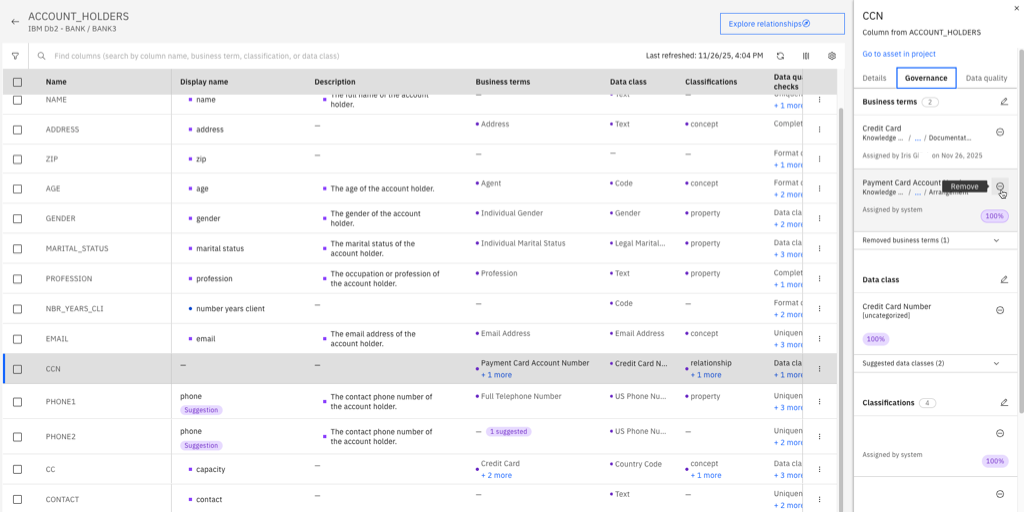

It is equally important to reject or remove a term assignment when it is wrong. Rejections and removals help the ML-based term assignment model avoid assigning similar incorrect terms in future runs. Remove A term by using the minus (-) symbol next to the term on the Governance tab in the side panel.

A model that is trained on the assignments and rejections in a catalog is shared between all metadata enrichments that reference this catalog in the metadata enrichment settings under Select assets used for training built-in model and for adjustment. The training of that model can be triggered from all metadata enrichments that use the training catalog’s model. So if a user reran a metadata enrichment on an older project that uses the training catalog’s model, ML-based term assignment might generate new suggestions or assignments based on the latest reviewed assignments and rejections in the training catalog.
