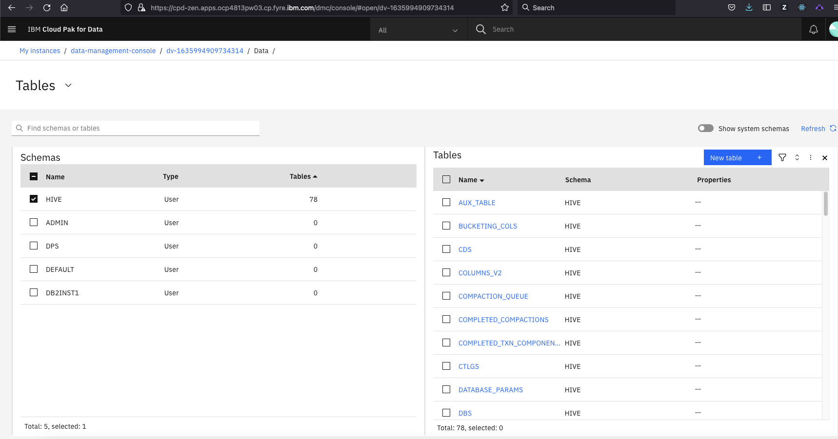

- Click to view all schemas and tables. Select
a schema to view the Tables page.On the Tables page, you can perform the following tasks.
- Click New table to create a table.
- Click a table name to see the table definition.
- Click the horizontal overflow menu (
) to get the properties of a table.
On the vertical overflow menu (), you can perform the following tasks.
- Export tables as CSV files.
- Grant or revoke privileges for tables.
- Generate DML statements for the table (select, update, insert, delete).
- Generate Data Definition Language (DDL) statements for tables.
- Get the dependency relationship for table.
- Update statistics for the table.
- Drop a single table or drop multiple tables.
On the Table definition page, you can click View data to view table data.
