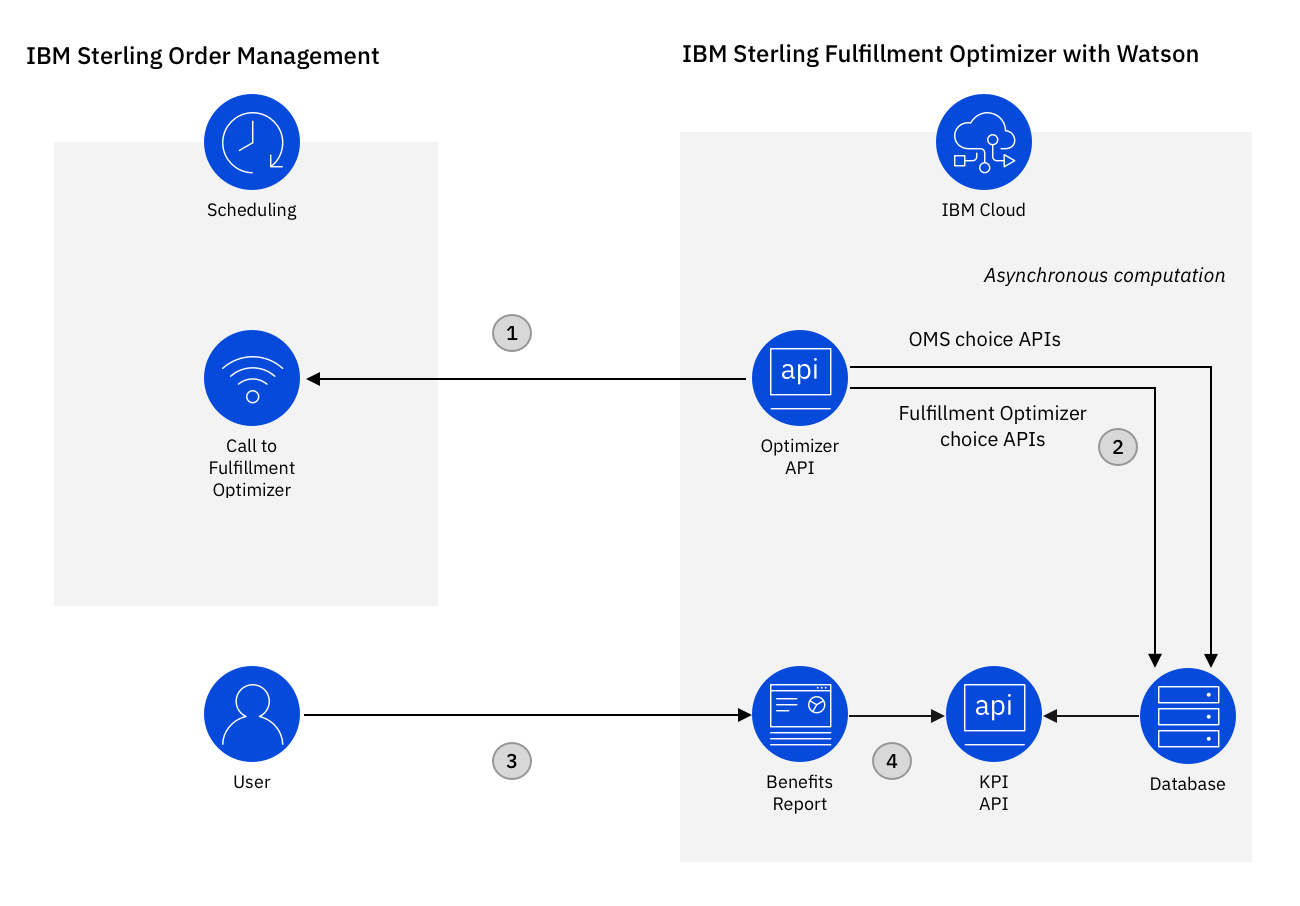

Fulfillment Optimizer relies on the receipt of real-time orders to learn and determine the most cost-effective option for fulfillment. In order to obtain the required orders, Fulfillment Optimizer integrates with your order management system.
Diagram 1
  1. To integrate the two applications, synchronous integration is required where the order management system calls the Optimizer API in real-time when the schedule process runs.
    In the evaluation phase, the order management system calls the idle version of the optimization API that can accept orders and process them asynchronously, thus providing you the ability to both test the integration and understand the potential benefits of using Fulfillment Optimizer prior to switching to the synchronous mode of integration between the two systems.
  2. Fulfillment Optimizer processes the received request and asynchronously calculates Key Performance Indicators (KPIs).
  3. A fulfillment manager can view the benefit and compare the accumulated KPIs using Benefits report.
  4. REST APIs that provide the data are also available for further analysis.
Reference integration pattern using IBM Sterling Order Management
Diagram 2
This pattern enables real-time integration from IBM Sterling Order Management to Fulfillment Optimizer and helps you obtain and deliver key insights on benefits that will optimize the cost to serve.

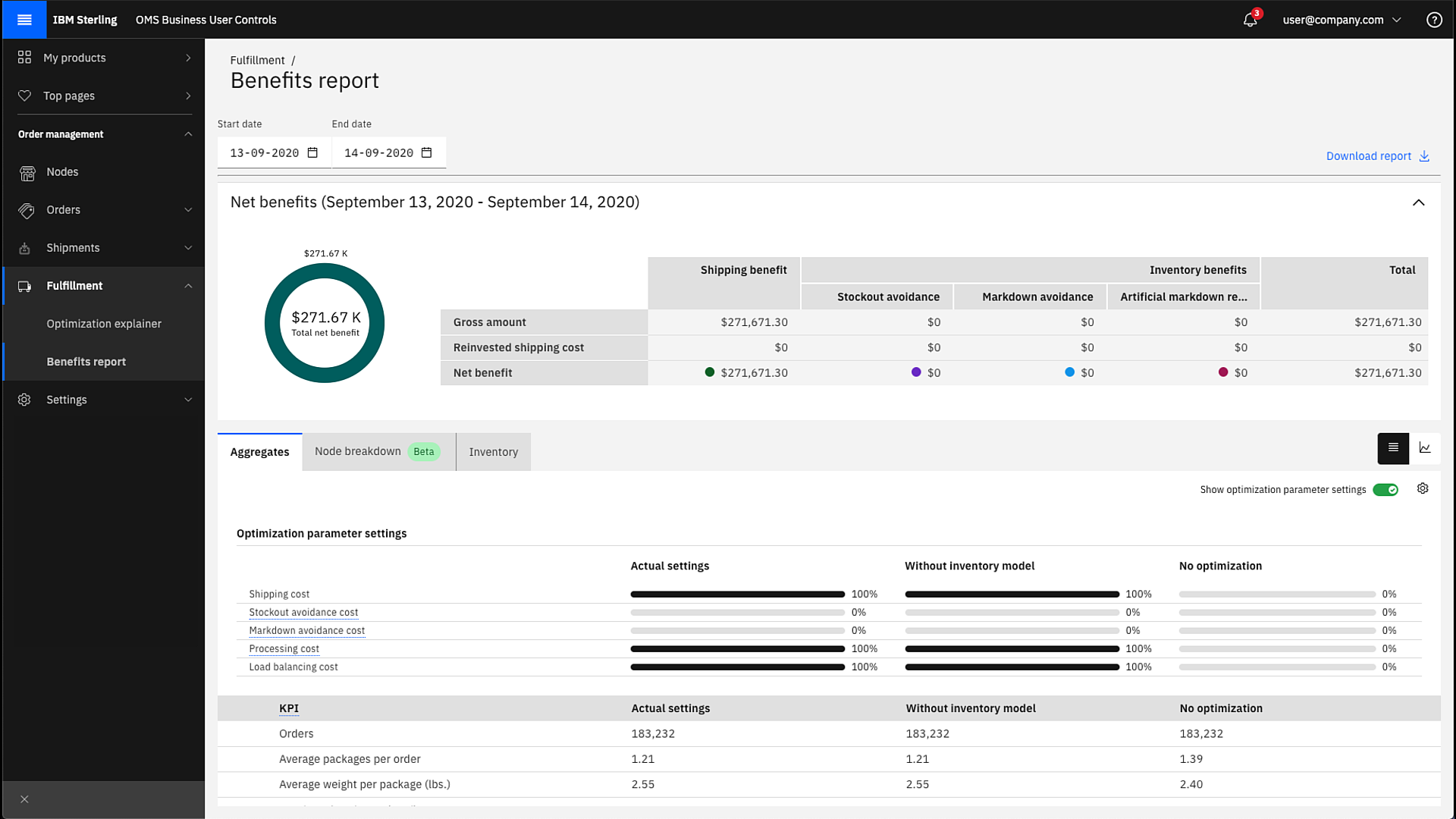

After completing these steps, you can start seeing the potential benefits of using Fulfillment Optimizer within Benefits report. Benefits report enables you to obtain a complete picture of the Key Performance Indicators and helps you aggregate and harmonize the data into a single analytical view. For example, you can view the net benefits accrued for a specific period of time in Benefits report.
The following image displays the results of idle optimization for a time period in which 183,232 orders were evaluated. The average number of packages per order is reduced from 1.29 to 1.21 with an estimated shipping benefit of $271,671.
Benefits report
