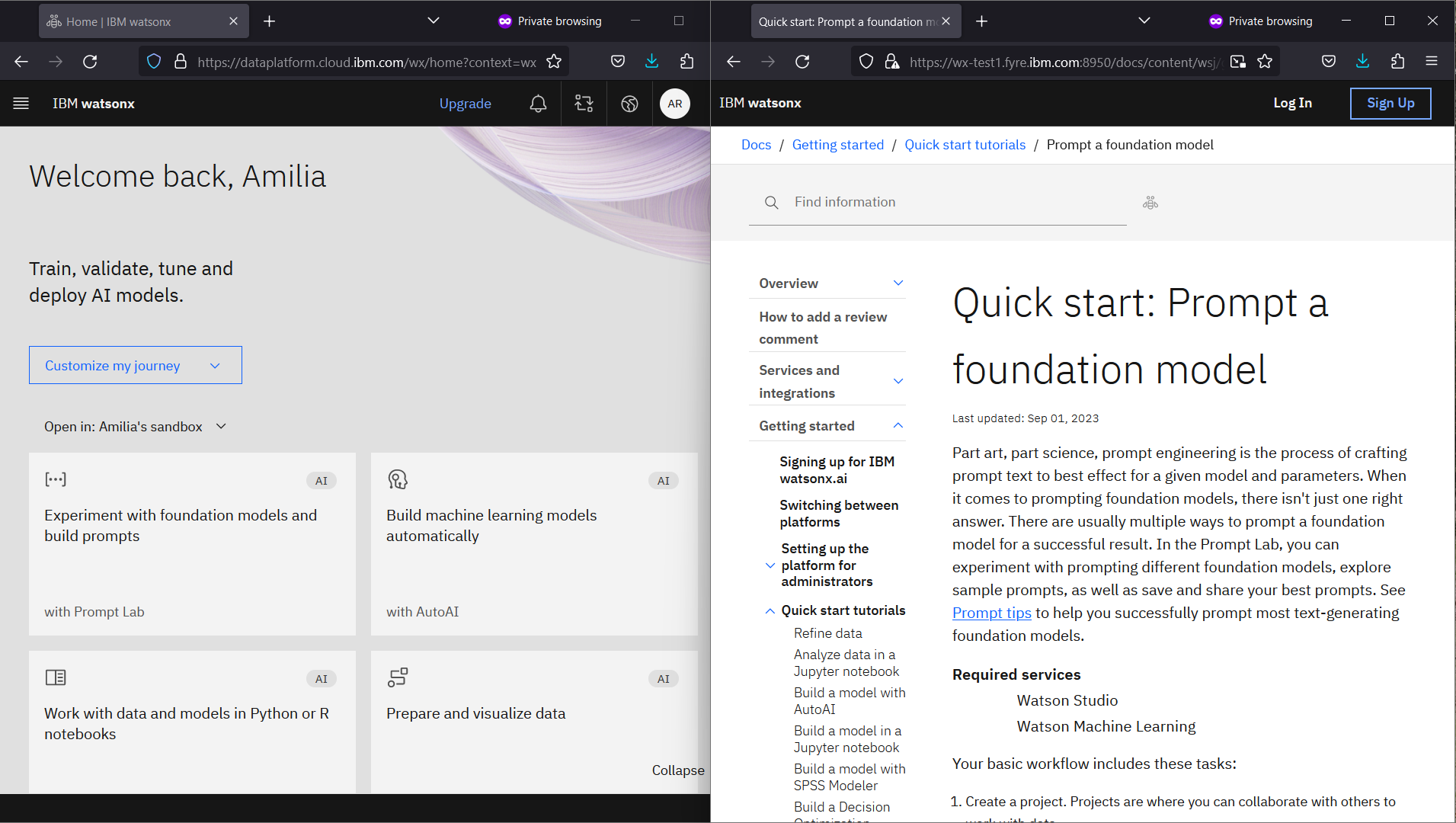

Set up your browser windows
For the optimal experience completing this tutorial, open your account in one browser window, and keep this tutorial page open in another browser window to switch easily between the two windows. Consider arranging the two browser windows side-by-side to make it easier to follow along.
Side-by-side tutorial and UI
Tip: If you encounter a guided tour while completing this tutorial in the user interface, click Maybe later.
