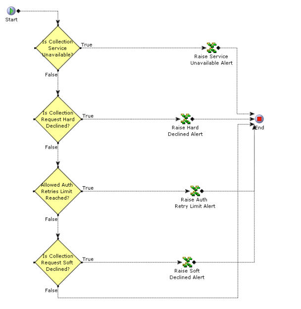

If the payment method fails the validation, the value of the ResponseCode attribute that is returned by the user exit determines how to handle the order. If the payment processing fails for any reason, the COLLECTION_FAILED event is raised by the YFSCollectionCreditCardUE user exit. The event calls the YCDOnCollectionFailure action, which invokes the YCD_ProcessCollectionFailure_1.0 service, responsible for calling the appropriate alert service depending on the ResponseCode.
Figure 1. Process collection failure service
The YCD_ProcessCollectionFailure_1.0 Service
  • APPROVED - This response code is returned if the authorization or charge was successful.
  • HARD_DECLINE - This response code is returned if the authorization or charge fails because the card is invalid. For example, a lost or stolen credit card. In this case, the order's strike count is increased by 1. The strike count represents how many times the payment was declined for the order with a HARD_DECLINE response code. The maximum allowed number of strikes is configurable.
  • If the strike count is higher than the maximum allowed number of strikes, the payment method is marked not to retry authorization, suspended, updated with the failure details, and the YCD_PaymentAuthRetryLimitAlert_1.0 alert service is invoked. The alert is sent to the Payment Auth Retry Limit Reached queue, which is monitored by the Fraud Analyst Group users.
  • If the strike count is lower than the maximum allowed number of strikes, the payment method is marked not to retry authorization, suspended, updated with the failure details, and the YCD_PaymentHardDeclinedAlert_1.0 alert service is invoked. The alert is sent to the Payment Hard Declined queue, which is monitored by the Fraud Analyst Group users.
    Note: The strike limit can be configured in the Channel Applications Manager.
    Figure 2. YCD_paymentHardDeclinedAlert_1.0 service
    Hard Declined Payment Alert
  • SOFT_DECLINE and BANK_HOLD - This response code is returned if the authorization or charge fails because the card was declined. For example, an invalid CVV number or insufficient funds. The payment method is marked not to retry authorization, suspended, updated with the failure details, and the YCD_PaymentDeclinedAlert_1.0 alert service is invoked. The alert is sent to the Payment Declined queue, which is monitored by the CSR group users.
  • SERVICE_UNAVAILABLE - This response code returns if the credit card authentication service could not be reached. The payment method is marked as retry charge, is not suspended, not updated with the failure details, and the YCD_PaymentServiceUnavailableAlert_1.0 alert service is invoked. The alert is sent to the Payment Service Unavailable queue, which is monitored by the System Group users.
