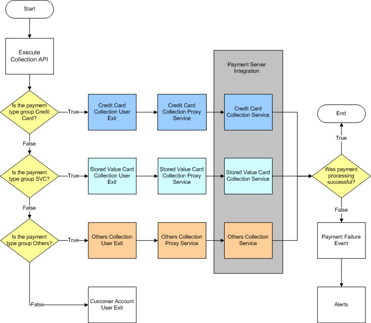

The different stages in processing payments from different payment methods are shown in the following diagram:
Figure 1. Payment processing
Payment Processing

The executeCollection API calls one of the following user exits for each payment method on the order that is based on the PaymentTypeGroup attribute of the payment method. These user exits provide the option of plugging in custom logic for authorizing and charging payments.
  • YFSCollectionCreditCardUE
  • YFSCollectionCustomerAccountUE
  • YFSCollectionOthersUE
  • YFSCollectionStoredValueCardUE
For more information about the user exits, see the Javadoc.
