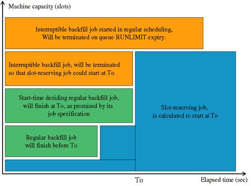

Resource allocation diagram

  1. Jobs are submitted to a queue configured for interruptible backfill. The job runtime requirement is ignored.
  2. Job is scheduled as either regular job or backfill job.
  3. The queue runtime limit is applied to the regularly scheduled job.
  4. In backfill phase, the job is considered for run on any reserved resource, which duration is longer than the minimal time slice configured for the queue. The job runtime limit is set in such way, that the job releases the resource before it is needed by the slot reserving job.
  5. The job runs in a regular manner. It is killed upon reaching its runtime limit, and re-queued for the next run. Re-queueing must be explicitly configured in the queue.
