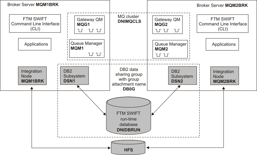

Figure 1. Example of a configuration with two broker servers that use an MQ cluster
Figure showing an example of a configuration with two broker servers that use an MQ cluster

In Figure 1 and Figure 2:
Integration Nodes
The integration nodes in which the FTM SWIFT message flows run have the names MQM1BRK and MQM2BRK.
Broker servers
The broker servers in which the integration nodes run have the same names as the integration nodes themselves (MQM1BRK and MQM2BRK). All broker servers must use the same level of FTM SWIFT code.
Broker-related queue managers
Queue managers MQM1 and MQM2 host the queues used by the integration nodes.
Gateway queue managers
Queue managers MQG1 and MQG2 serve as gateways to distribute the workload to both broker servers.
Queue manager cluster
In Figure 1, all four queue managers are members of the queue manager cluster specified by the placeholder DNIvCLUS. FTM SWIFT applications and the FTM SWIFT command-line interface are connected to either gateway queue manager, which directs each inbound message to either MQM1 or MQM2.

Db2 data sharing group
The brokers have connections to their local Db2 subsystems, which are members of a Db2 data sharing group. The FTM SWIFT runtime data is located in table spaces shared by both members (DSN1 and DSN2).
HFS (or zFS)
The FTM SWIFT message flows and the code of the Java™ database routines are stored in a common, shared hierarchical file system (HFS) or z/OS file system (zFS). Using a shared HFS (or zFS) saves time, because the FTM SWIFT libraries need be installed only once, rather than once per image. It also ensures that both servers use the same version of the programs delivered.
