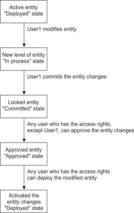

The process is the same regardless of whether you create, delete, or change an entity. Figure 1 shows the steps through which the entity passed in the example.
Figure 1. Simple configuration process flow with dual authorization enabled
Figure showing simplest configuration flow

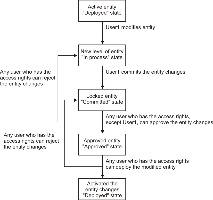

Several factors can affect the life-cycle states through which an entity goes. For example:
  • You might decide after you commit your changes in the modification stage that you are not done and must make additional changes. You or another user can reject the changes. This unlocks the entity so that only you can continue to modify it. This changes the state from Committed back to In process.
  • Perhaps a user does not agree that your changes should be approved. After the changes were approved, this user can reject the approval. This changes the state from Approved back to Committed.
Figure 2 shows the configuration process flow when someone rejects changes made to an entity.
Figure 2. Configuration process flow with rejections. Dual authorization is enabled.
Figure showing a more complex configuration flow
When you reject a changed entity, you must provide the reason why. FTM SWIFT temporarily stores reject reasons. This information is deleted when you move the entity to another state. For example, if you reject a changed entity, the entity is moved from the Committed state to the In process state. You can now continue to work with the entity. This example assumes that you were the initiator of the changes. When you complete the changes and put the entity back to the Committed state, the previous reject comment is deleted.
The same process occurs when a user rejects an entity after it was approved. If this happens, the entity moves from the Approved state to the Committed state. If you determine that you must make additional changes before the entity can be approved, you must reject the entity again. This changes the entity state from the Committed state to the In process state. Because there is a change in the state, the original reject reason is deleted.
